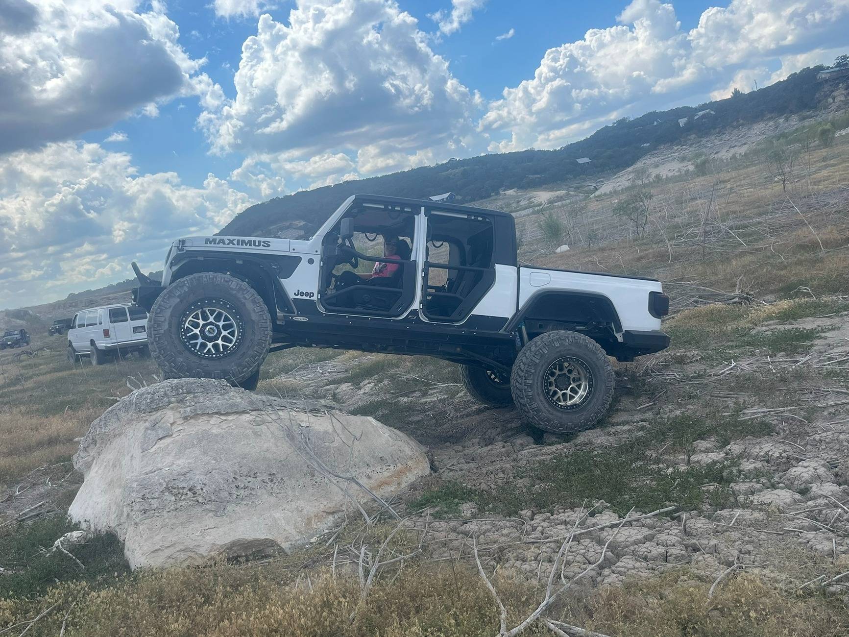

They do make a full float UD60 axle for JT. I have them installed on mine.
Jeep Gladiator New: Ultimate Dana 60 Semi-Float Rear Axle for JT Gladiator 1743172802882-ai
Tons and 42s would be great, but I'd need a v8 to make it fun to drive. At that point the build would cost me Thad the truck. Hardly seems with it to me.
Tons with 42s is pretty great. It does amazing off-roading and so far I haven't found anything it can't do.
