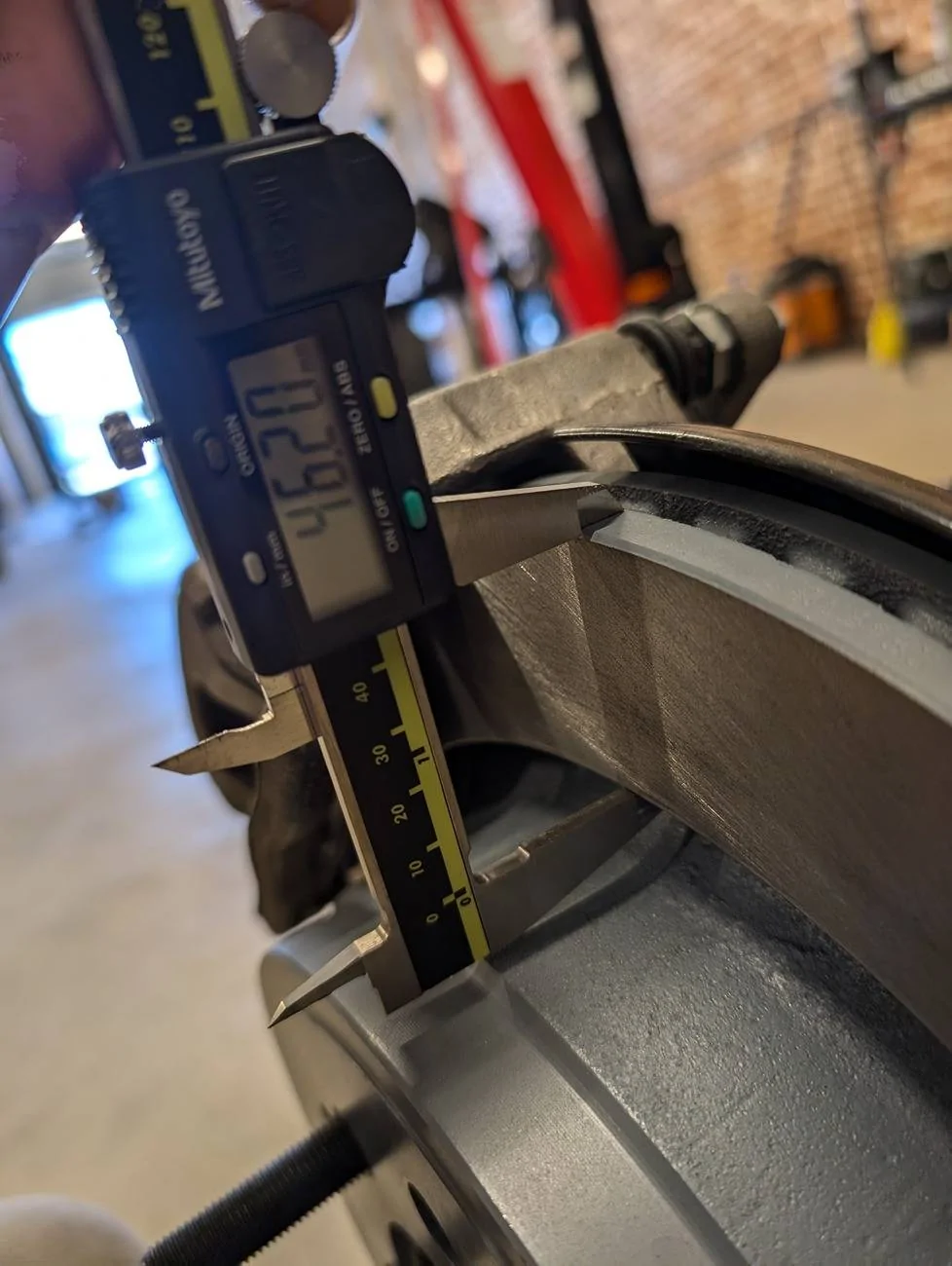

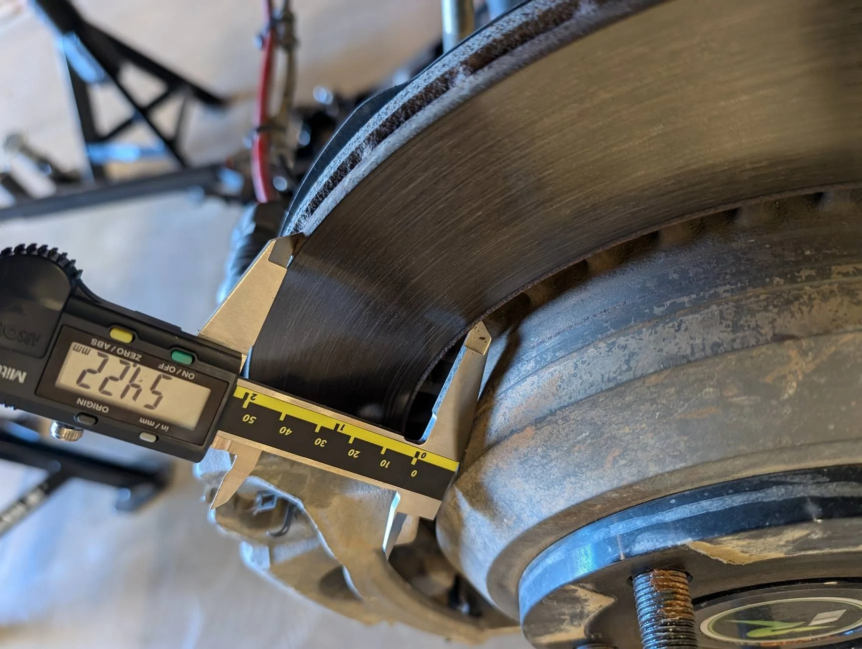

Alrighty, I took the measurements of the actual area of the rotor that is used for braking. The JT has more surface area than the F150 brake parts on the Dynatrac 60. The D60 rotor looks almost the same size, but it is, per spec, 5mm bigger in diameter.
Both calipers look almost identical, both single piston.
Both pads look to have the same arc length of brake pad material, however, I did not measure these and don't feel the need as there is a notable difference in rotor area used for stopping.
OdmmODinIDmmIDinOD radOD areaID radID Areastopping area
JT34513.6290.7811.46.8144.95.7102.942.0
F15035013.8303.812.06.9149.16.0112.436.8
THis is the OD vs ID area from the F150
Jeep Gladiator New: Ultimate Dana 60 Semi-Float Rear Axle for JT Gladiator F150 rotor area
This is from the JT
Jeep Gladiator New: Ultimate Dana 60 Semi-Float Rear Axle for JT Gladiator JT rotor area
