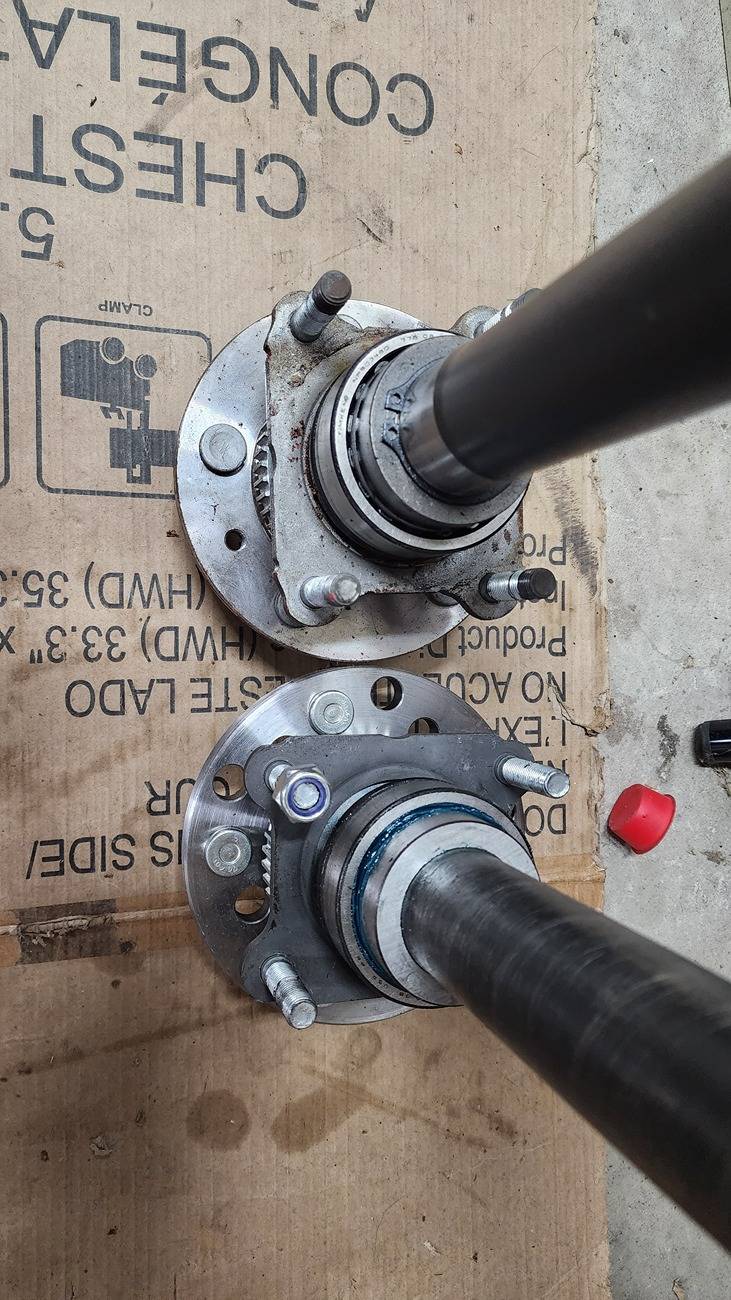

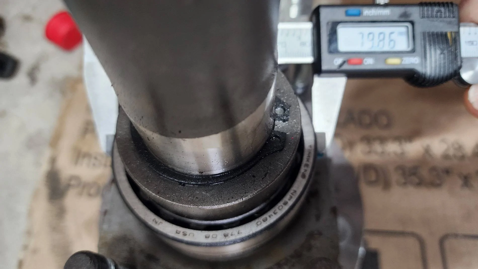

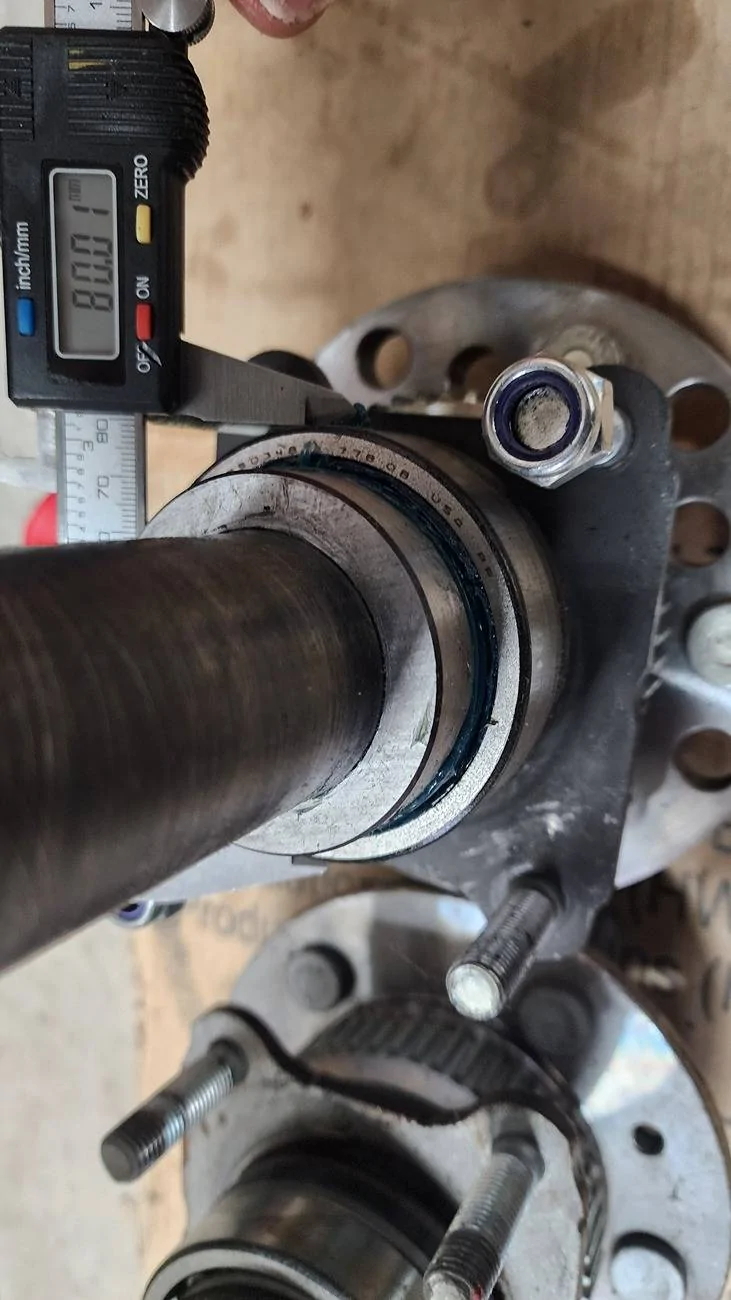

With the semi-float axle and reusing stock brakes/backing plate, they can only go so large on the bearings. The bearings for the axle I have are set80, which is what most of the semi-float aftermarket axles use. I took a look at mine and OD is the same as stock.

Thanks. Great pics
I was hoping to avoid 8 lug to get larger wheel bearings but that may not be possible
