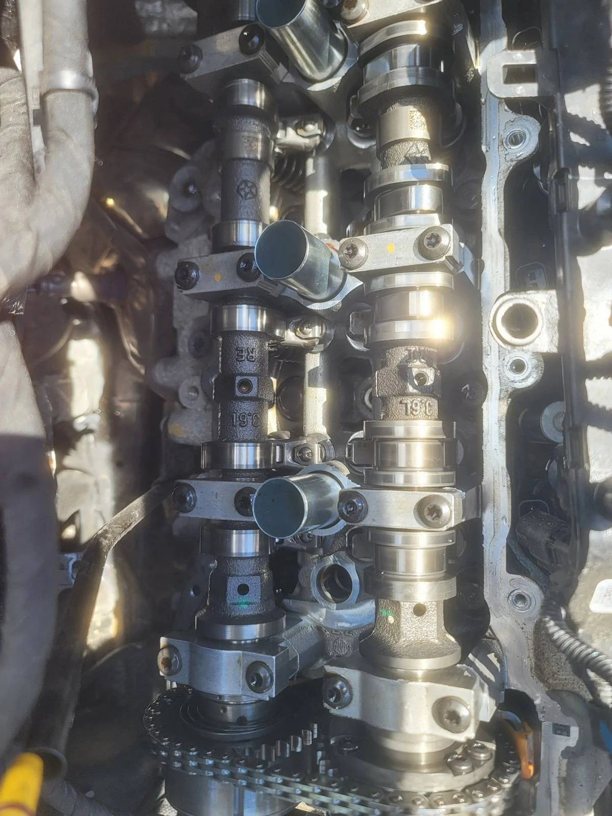

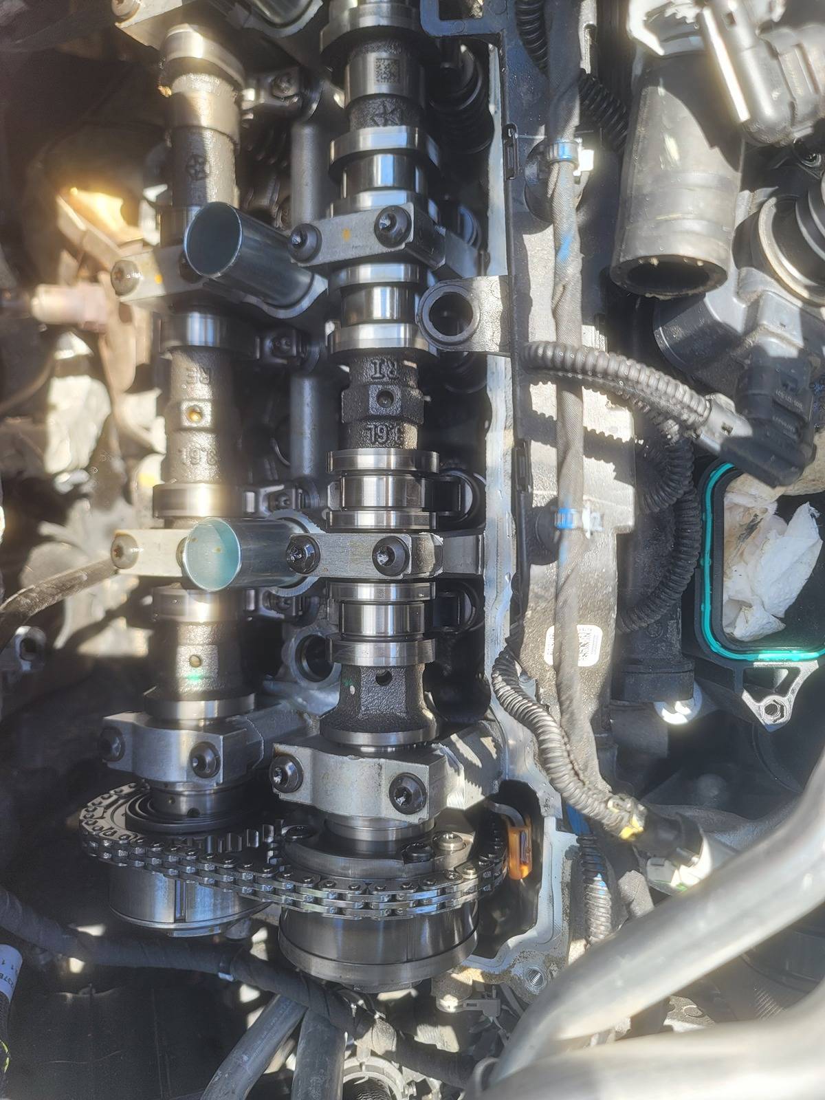

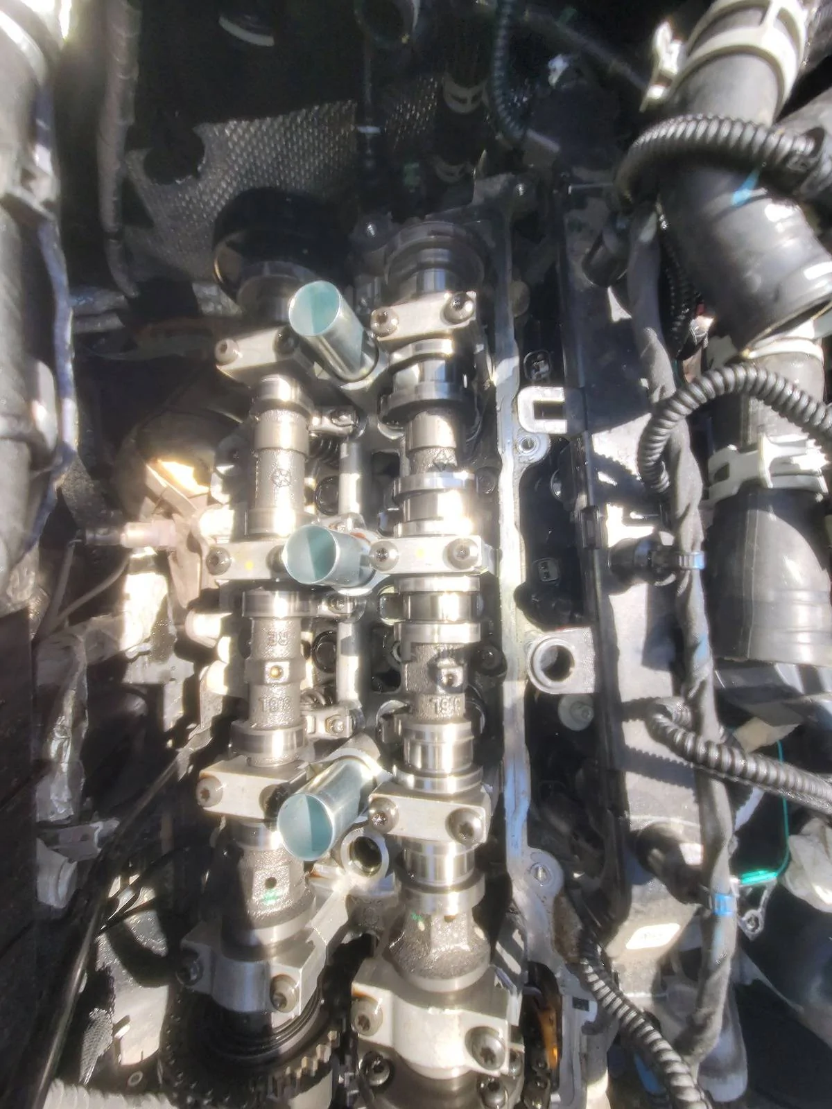

Hello, thanks for letting me join the forum! I have a 2021 Jeep Gladiator Rubicon that was a Canadian truck (did not know that at the time of purchase, and definitely wasn't told that the factory warranty was void because of that). It had a tick that I thought was coming from the valve train, but 2 dealers said it was purge valve solenoid. While driving the other day I suddenly lost almost all power, and truck was really struggling to stay running. Well I took the valve covers off and there's metal all over the magnets at the rear of all 4 cams. Where I'm stumped is, there is no standout signs of wear on any of the lobes. Is it possible that the rocker arms are being chewed up without eating into the cams as well? I'm waiting on my timing tools to come in the mail so I can't take the cams out just yet. Also, I sent a sample into Blackstone labs but won't know anything from them for ~10 more days. Truck only has 20k miles, so I'm pretty disappointed in Jeep obviously. Any help would be greatly appreciated.

I believe the most common failure is for the roller bearings to let go, and then the sloppy rollers wear down the lobes over time.

Could worn roller bearings cause sudden loss in power like I was experiencing? (Sorry I've never really worked on the valvetrain on an engine)

Crankshaft position.
So it went into "limp mode" is what it sounds like.
That would make sense. I guess if some of the rockers aren't working like they should, that could cause the corresponding valves to not operate as well. Just visually inspecting the rocker arms, none of them appear broken but there is lots of slop in 7 or 8 of them. Could just sloppy bearings alone cause the valves to not open or close?

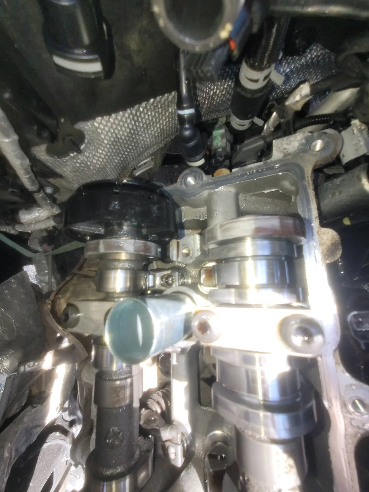

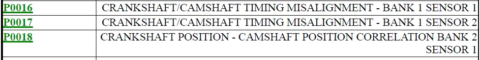

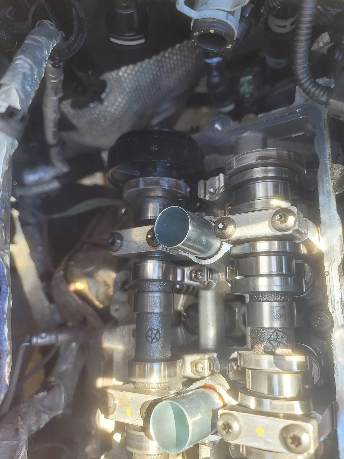

Looking at the camshafts, there are no signs of wear whatsoever on any of the lobes. I bought the wrong timing chain tools 🤦 so I can't get the cams out until the right one shows up. Since I was throwing P0016 and P0018 does anyone think it could be my phasers going bad? All 4 timing marks on the phasers are in the correct position and chain is taught, so I don't really think that it jumped time... Could phasers or position sensors cause the extremely loud ticking and limp mode I was experiencing? I'm really at a loss here. There's metal paste on the rear of cams but a friend of mine thinks it's a normal amount of wear metal.
