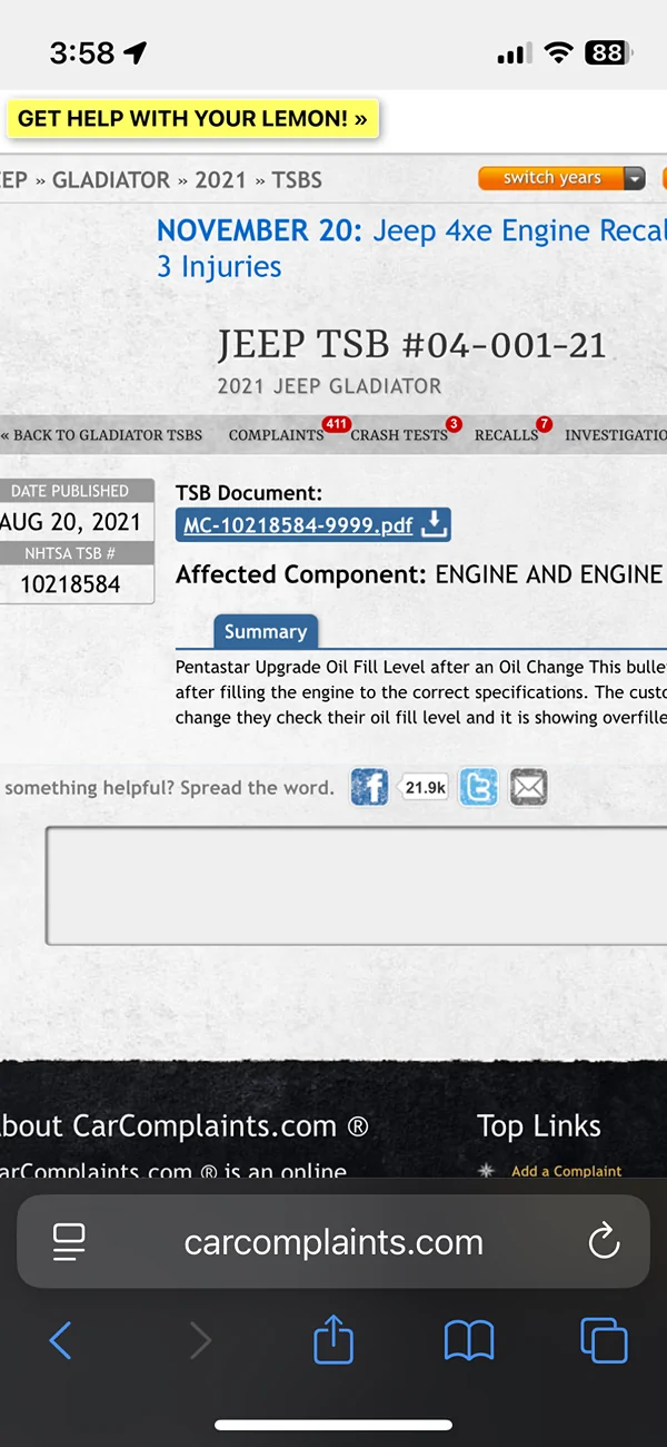

Maximus Gladius
Jan 30, 2021
75
2,917
3,730
Calgary, AB, Canada
2021 JTR, 2023 JTR
Hey @AllMoparParts.com , Hey Benny know the answer to this ??
I’m not Benny…, but “the update” was discussed sometime around when I got my second engine and the service manager stated I would be getting the “updated” one. He didn’t elaborate but the discussion was around whether or not I’d have to endure the whole “misfire” thing again. I ended up having one at 60k kms but was only a bad #5 spark plug.
Looking further into it, back then, we did discuss it amongst several others here, I did provide some information stating the “upgrade” was simply going from 6 quarts to 5 quarts of oil and we all remember the issues of bringing in our trucks for oil service to find those that had the upgraded 3.6 were over filled to 6 quarts and being all pissed off it wasn’t 5 quarts. The techs just didn’t get the memo
I even had to show my service manager, that was involved in my second engine, the work order, where the tech ordered 6 quarts for my “upgraded” engine when it only calls for 5 … and then we all remember it already came with 6 in it and then he dumped in 6 more, thinking it came empty like it should have, which then I had to deal with having 12 litres in the crankcase for my first 1500 kms.
I found the info on this “upgrade” from the member that posted ‘torque values in one place’ and it included a full list of updates and TSB’s.
Maximus Gladius
Jan 30, 2021
75
2,917
3,730
Calgary, AB, Canada
2021 JTR, 2023 JTR
Look up the PDF here in that list. This mentions the upgraded engine. (I told my date she had to wait! This was important!!
Jeep Gladiator 230k+ Mile JT having misfire Issues after rocker repair IMG_5515
40,514
54,043
And this is related to a misfire................how?
I was referring to a swap of cam and followers. There was something needed done after doing that, not about oil levels or capacities.
