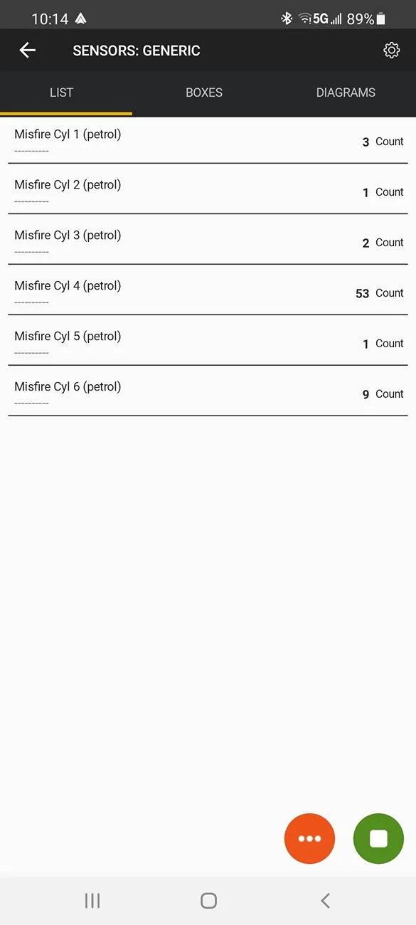

What are typical misfire numbers? I have a few with with no CEL. Below after 1.5 hours towing a camper through western PA from a cold start. Dealer will not touch until CEL.
My current 2025 JT, the #3 cylinder shows about 25 or so on a 45 minute commute each way while the other cylinders are in the single digits or teens at most. My 2020 JT was also the same way with the #4 cylinder and my 2022 JT was the #2 cylinder that would show higher than the others.
Pretty much the same thing, unless it posts a MIL, they are not really going to act upon anything. I think most people will always have one cylinder report a bit higher than the rest. Jeep has updated the PCM software a few time to account for these types of spreads. Thing to keep in mind is that the algorithm they use to record misfires is somewhat of a guess based on knock and few other parameters and not all misfires recorded would be a actual misfire.
Went down the rabbit hole with my 2020.
Given the type and length of driving you were doing, I would call that "normal" on the sliding scales of things with this engine.

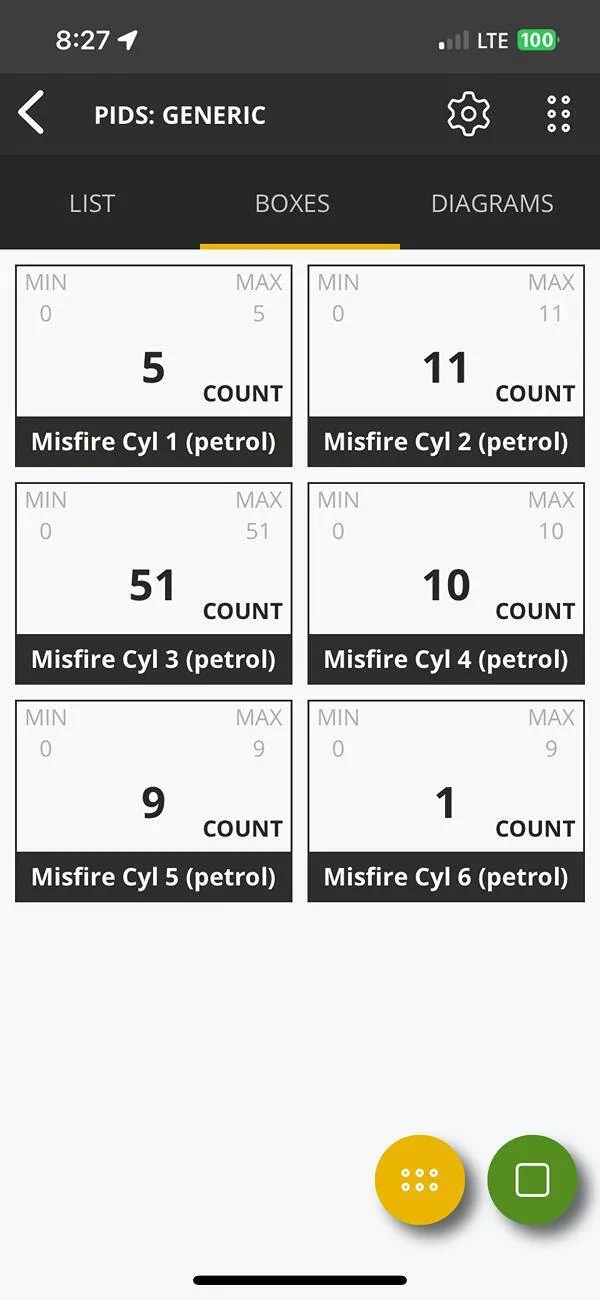

This was from my 2020 JT:
Jeep Gladiator Survey- For those with misfire issues P0300_8-22-2021

Thanks! …and a rabbit hole indeed.
