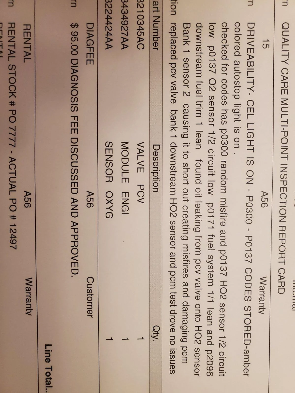

Update: Picked the gladiator up this evening. Have only driven about 10 miles but all lights are off. I will post if anything else develops. The dealer sheet is attached. Long story short, new ecm, new PC valve, and new oxygen sensor. Good luck to all facing these issues and thanks for the help along the way.
I heard on another post about the same oil leak shorting out that sensor and fixing that leak solved the misfire issue.
Seems like that leak could be the main reason for all these misfire problems

Update: Engine light back on after approx. 20 miles. Taking back to dealer today.

Update: Gladiator is back home. After replacing ecm, it needed to relearn the brake switch which is a two step process. All good for now. Will continue to bbn update. Thanks.

Update: The auto start/stop light is back on, check engine light is back on and exhaust smells terrible.

Hello all, recently purchased 2020 Rubicon gladiator. All was well first 800 miles, then p137 oxygen sensor code. Code cleared after day or two. Now around 1400 miles, owned less than two months and have blinking check engine light, p137 and p300 codes. exhaust smells terrible, vehicle barely runs, stutters doesn't shift right, etc. I want rid of this piece of trash ASAP. unbelievable to be having problems like this, apparently widespread on a new vehicle. I appreciate any tips, tricks, feedback on buyback.

There’s a know issue with All 2020 JL and JTs the current fix is to change the rocker arms and tibbets.
Apparently there’s they made a change to the engine. They basically added a timing system to the variable valve time system in the penstar
They replace the entire left
side cylinder head, cam, rocker arm and rockers. I know because they did it to mine about a month ago and i haven't had any issues since...
