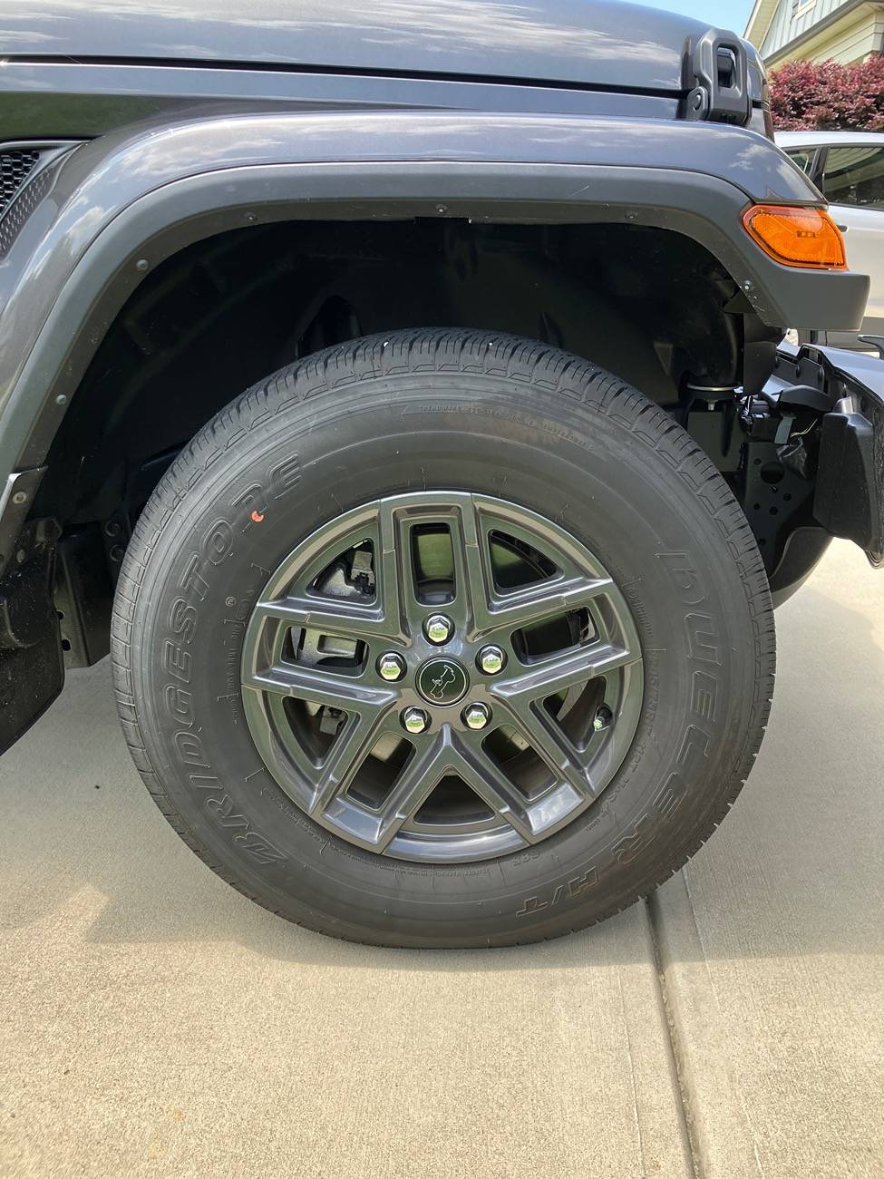

2024 Gladiator Sport S running stock light truck tires (Bridgestone Duelers) 245 75 R17 on stock 7.5” rims

Current:
Jeep Gladiator swapping stock 245 75 R17 on 7.5” Sport S rims, for Rubicon take-off 285 70 R17 tires and rims - Issues? IMG_4885

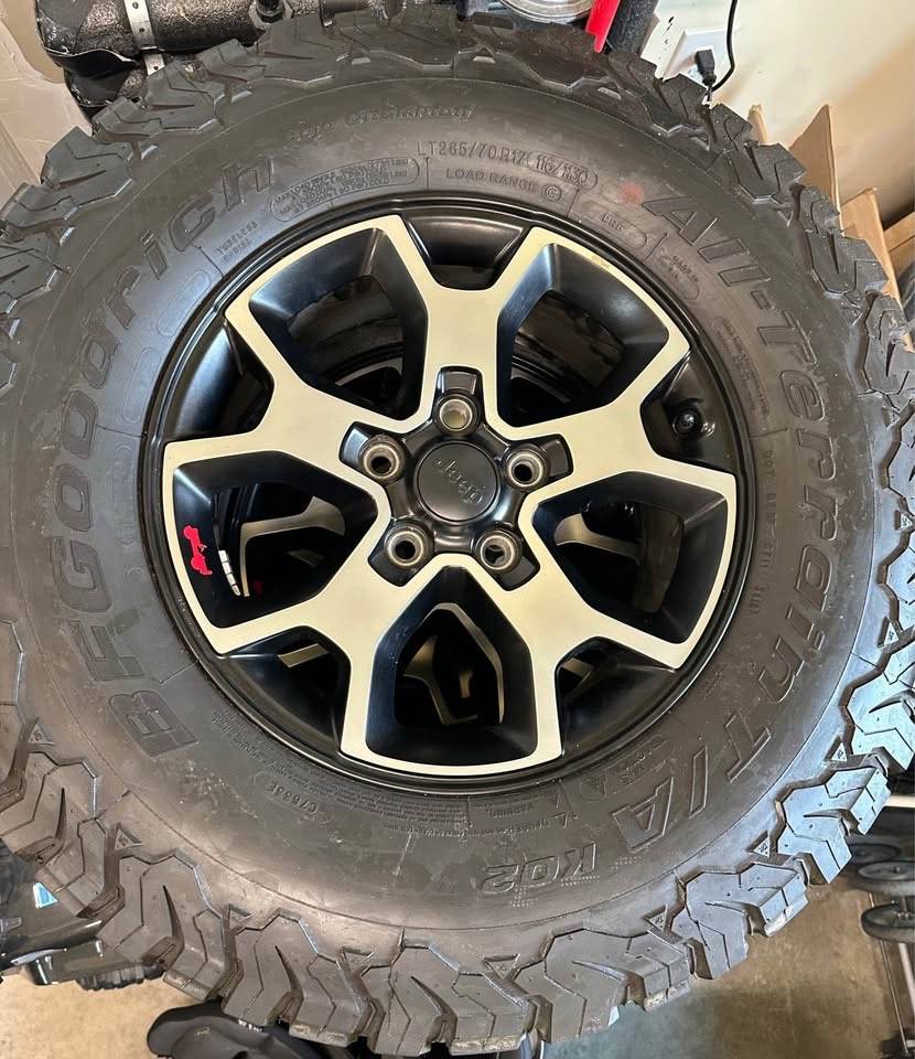

Proposed:
Jeep Gladiator swapping stock 245 75 R17 on 7.5” Sport S rims, for Rubicon take-off 285 70 R17 tires and rims - Issues? Ima

It will physically fit without issue or interference.
As to the TPMS, they need to be from a vehicle built after June 7th 2021 to be compatible with your 2024.
Need to also program for tire size change and speedometer adjustment with a tool like JScan or similar.

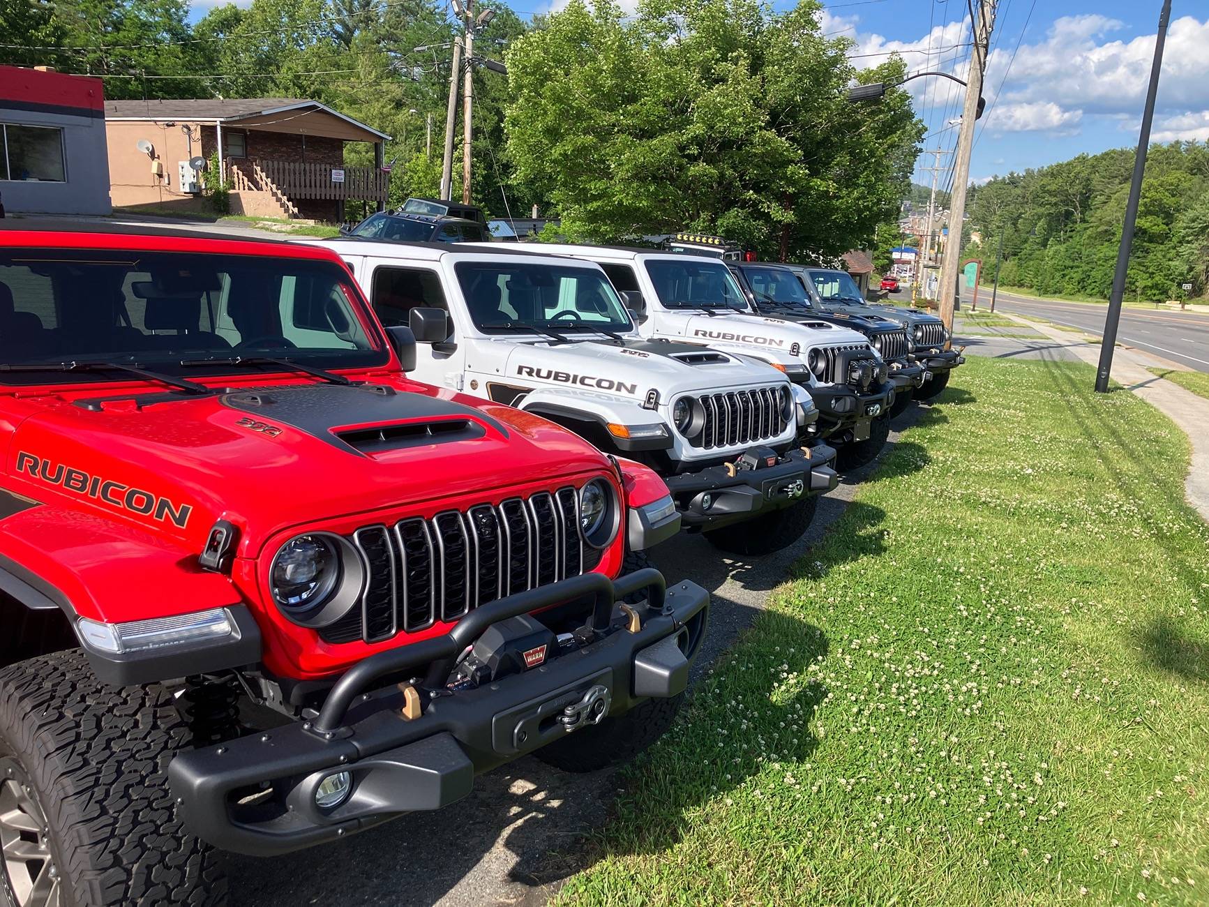

I’m in Boone NC tonight. Stopped by RubiTrux to see about any wheel/tire take offs they might have. They have ten 392 Hemi conversions in JLUs on the lot.
Jeep Gladiator swapping stock 245 75 R17 on 7.5” Sport S rims, for Rubicon take-off 285 70 R17 tires and rims - Issues? IMG_4892
