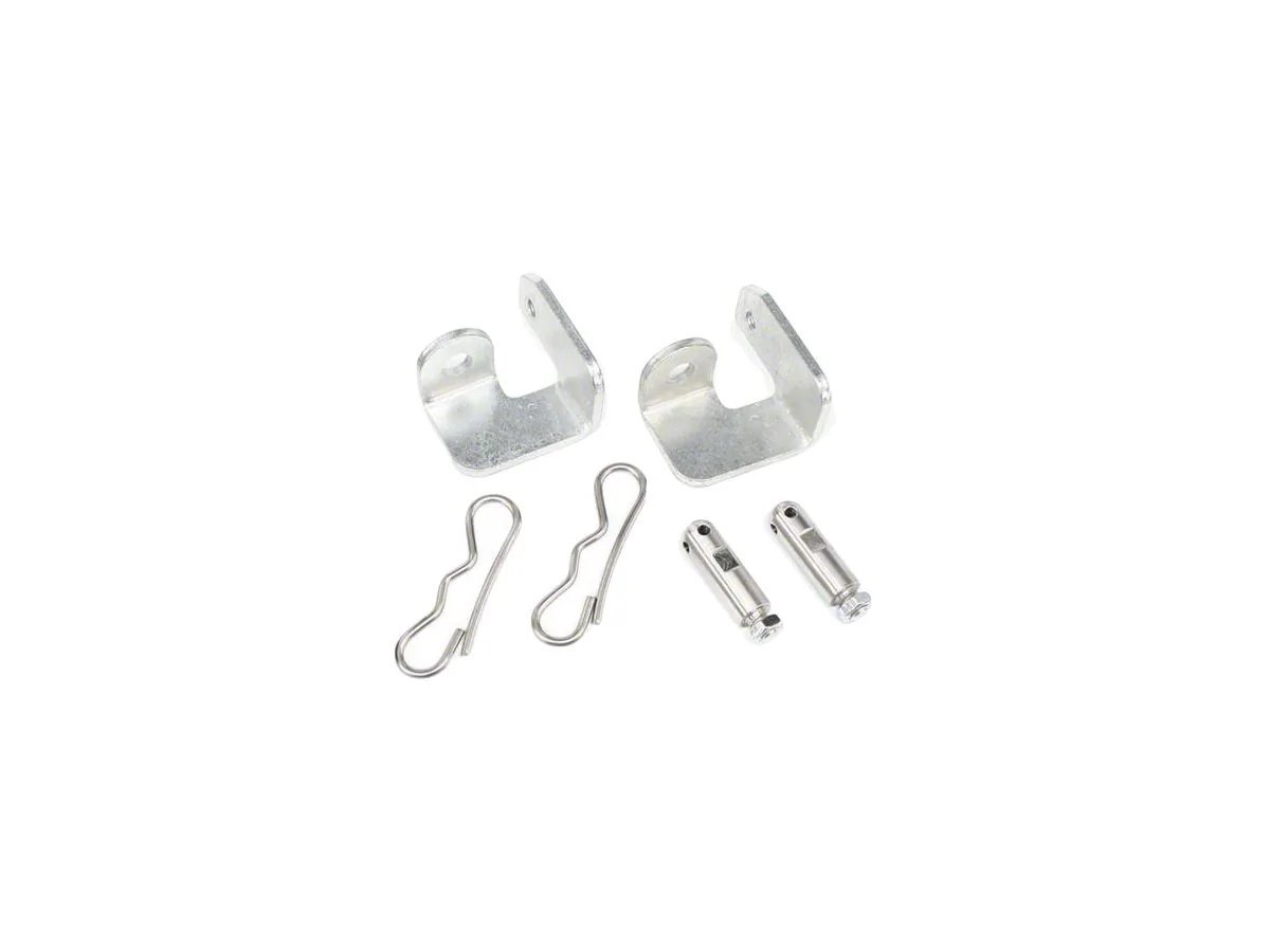

I came across these as I was looking at options to upgrade to a sway bar disconnect kit. Is this a reliable option to use with the factory sway bars? I really don't know a lot about sway bars and what makes the kits better by replacing the entire set up. To me this would work just as well with the factory setup.
Picture 1
https://www.ruffstuffspecialties.com/R2460.html

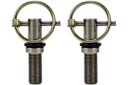

I also found this but it is for the JK and it is similar but also includes the bracket to hold the sway bar up after disconnecting. Has anyone found something similar for the JT?
https://www.extremeterrain.com/teraflex-quick-disconnect-jk-1601277.html?utm_content=XTHandling-SwaybarsandDisconnects|Teraflex&T5_Var4=J13004&intl=0&utm_campaign=XTW+Wrangler+No+Vehicle+High&dialogtech=ppc&utm_source=google-pla&utm_medium=shopping&T5_Var2=shopping&gclid=Cj0KCQjwxNT8BRD9ARIsAJ8S5xZdYPCDQaOI09BuVM8O0cOJEo_jl_QkhHqQXlWHBiMef87b2yxr4WYaAvsbEALw_wcB&gclsrc=aw.ds

One of those pins should work fine on the driver's side. The passenger side link needs to mount between the factory axle-side mounting tab and track bar mount. JKS has you cut the factory tab off of the passenger side to use theirs. Those might work similarly, but I couldn't say for sure.
