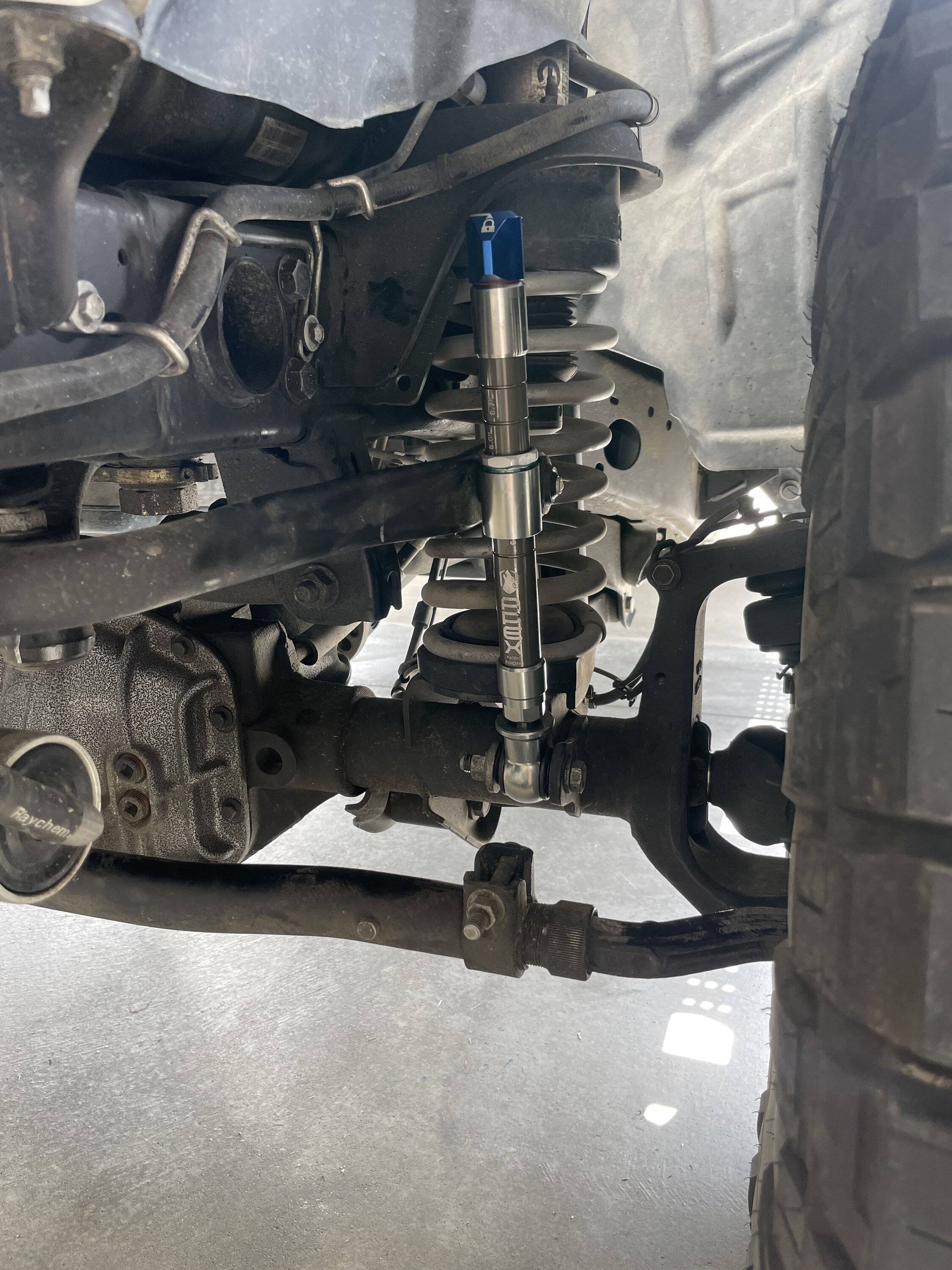

I installed mine last week and went to the local off road park yesterday. Disconnecting and reconnecting are both super easy compared to traditional quick disconnects--no need to find perfectly level ground, no need to use a rubber hammer to get things on and off, no need to lay in the grass / dirt / rocks / mud / whatever and get your hands muddy and greasy and bring that mess into your Jeep, etc. Disconnecting and reconnecting both take seconds and are easily done. When disconnected they allow full flex and when connected they are solid. I am very happy with this purchase.
I have a Sport S with the Mopar lift with 37s and installed the 10.5 inch stroke Autolynx.

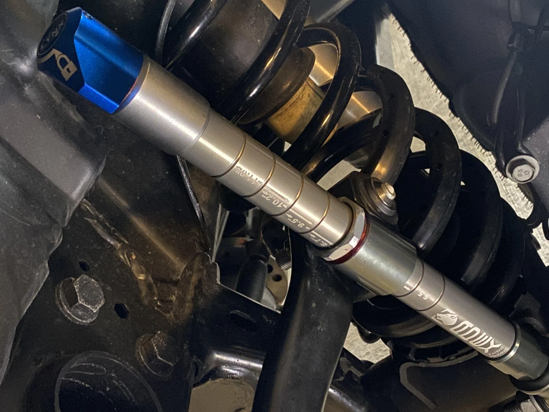

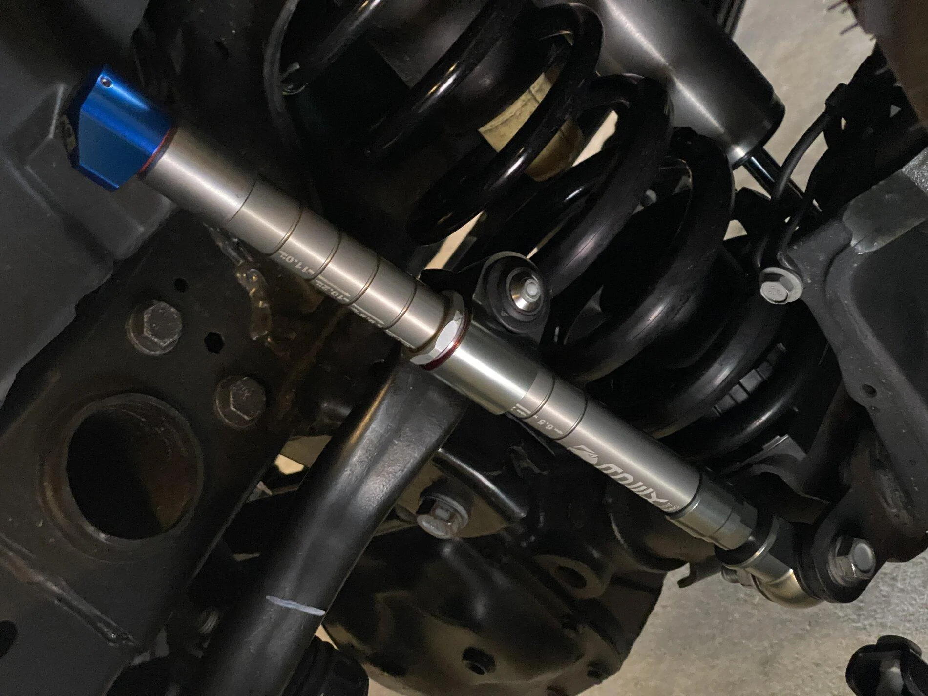

I just installed a set of the 8” Autolynx a few days ago. Super easy install and I did not have to trim my liners or cut the tab. I’m in a Mojave running 37’s and AEV’s 2” lift. To be honest, I probably could have purchased the 10.5” version. There’s another thread on here where some trucks were getting a popping noise from the front following the installation. Not gonna lie, made me hesitant to pull the trigger on them. However, I haven’t gotten any noises. I made sure to loctite and torque everything as directed.
