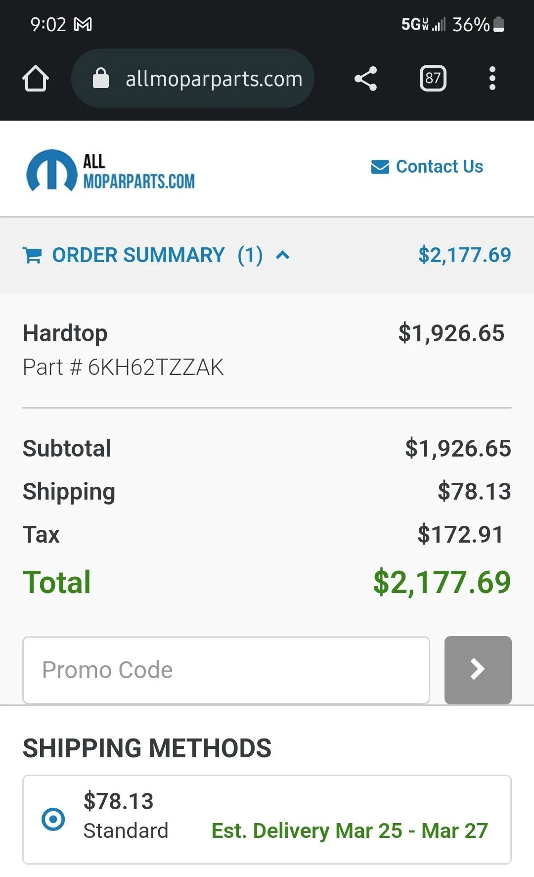

For kicks I checked all Mopar parts and it looks like $2k. Shipping to my address in NY the total is just under $2200.
https://parts.allmoparparts.com/oem-parts/mopar-hardtop-6kh62tzzak
You might be able to get a better deal from the dealer as they usually have the 10% coupons for accessories. And you don't have to deal with a giant box in your driveway..
