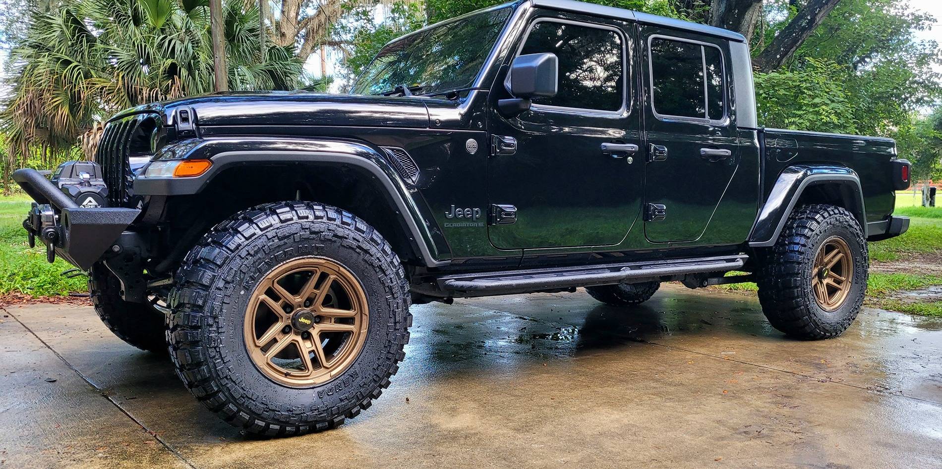

Jeep Gladiator Synergy 2" springs with  1/2" TF spacer gtg? 20250629_080538
Said screw it, went ahead and got some 35s. Spring/shock combo rides really good on road. Arguably better than stock. Tires are a vast improvement over the previous ones.
Gratuitous pic..
