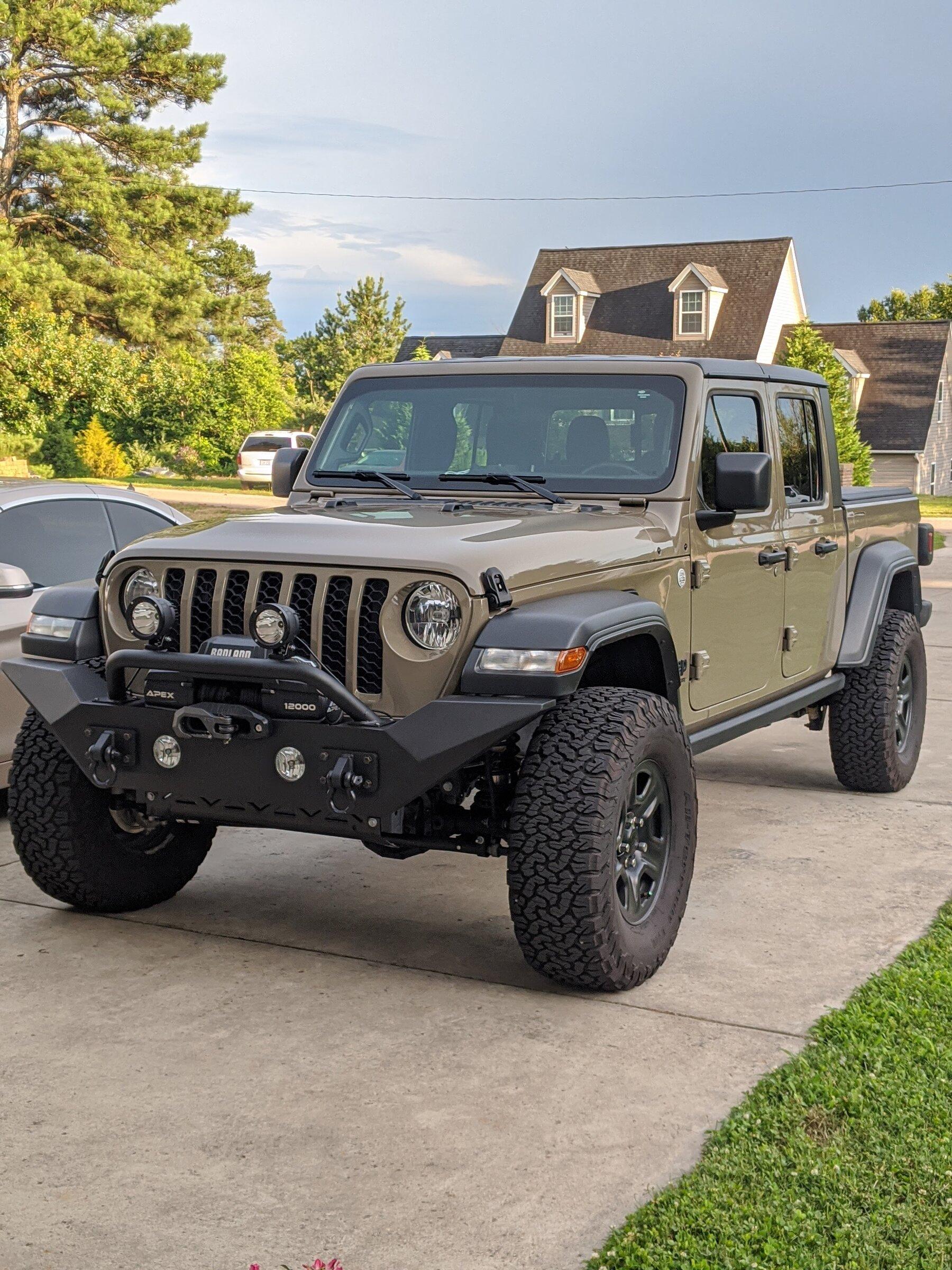

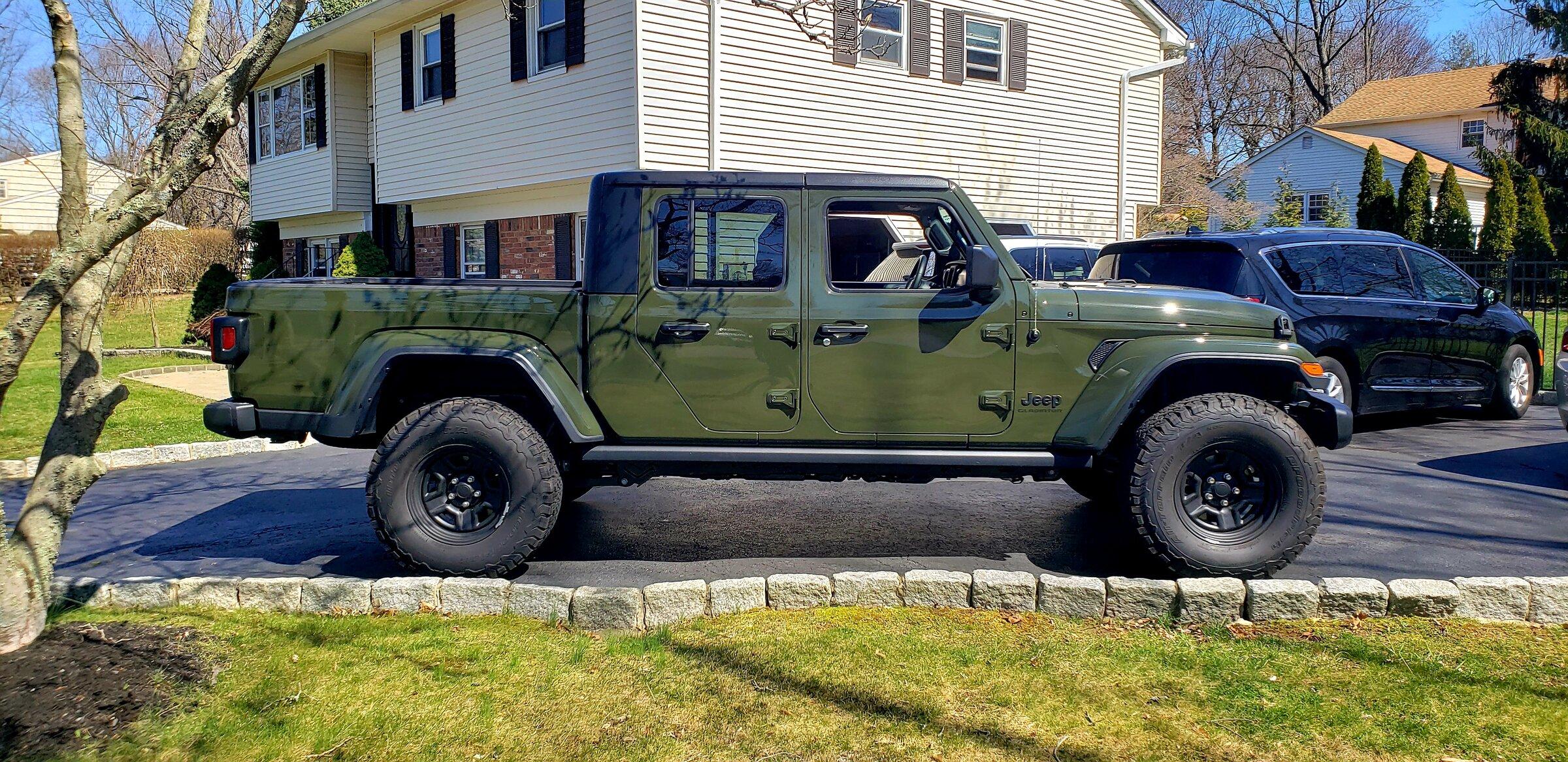

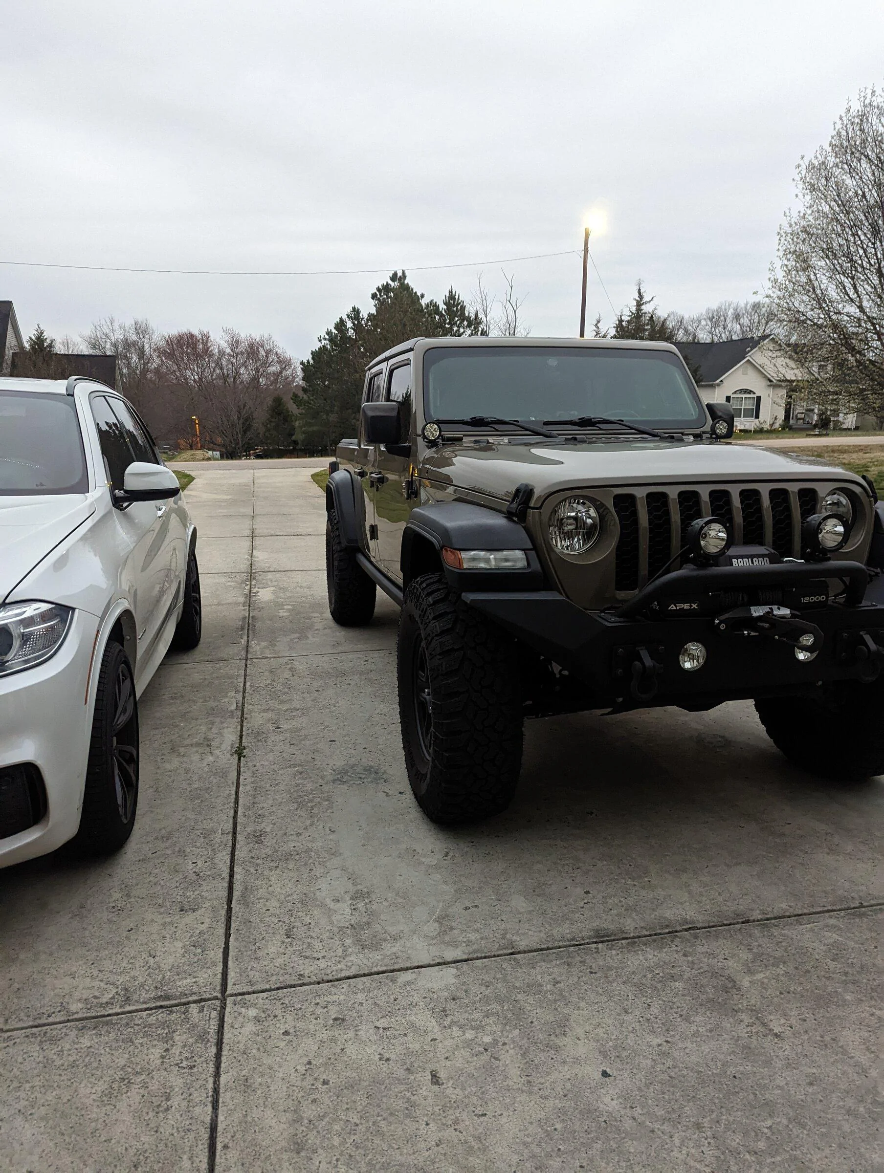

Not the AEV but I went with the Readylift 2.5 SST spacer lift. I also installed Rubicon takeoff springs in the front. I think the amount of lift it gave me looks good with 35's or 37's, altogether gave me 3-1/4 inches of lift and maintained the stock ride feel pretty much. It's a complete kit as well.
315 70 17 BFG KO2s with 1-3/4 wheel spacers

37 12.5 17 Kanati trail hogs with no wheel spacers
Jeep Gladiator AEV 2" Spacer Lift PXL_20220311_233348879.MP

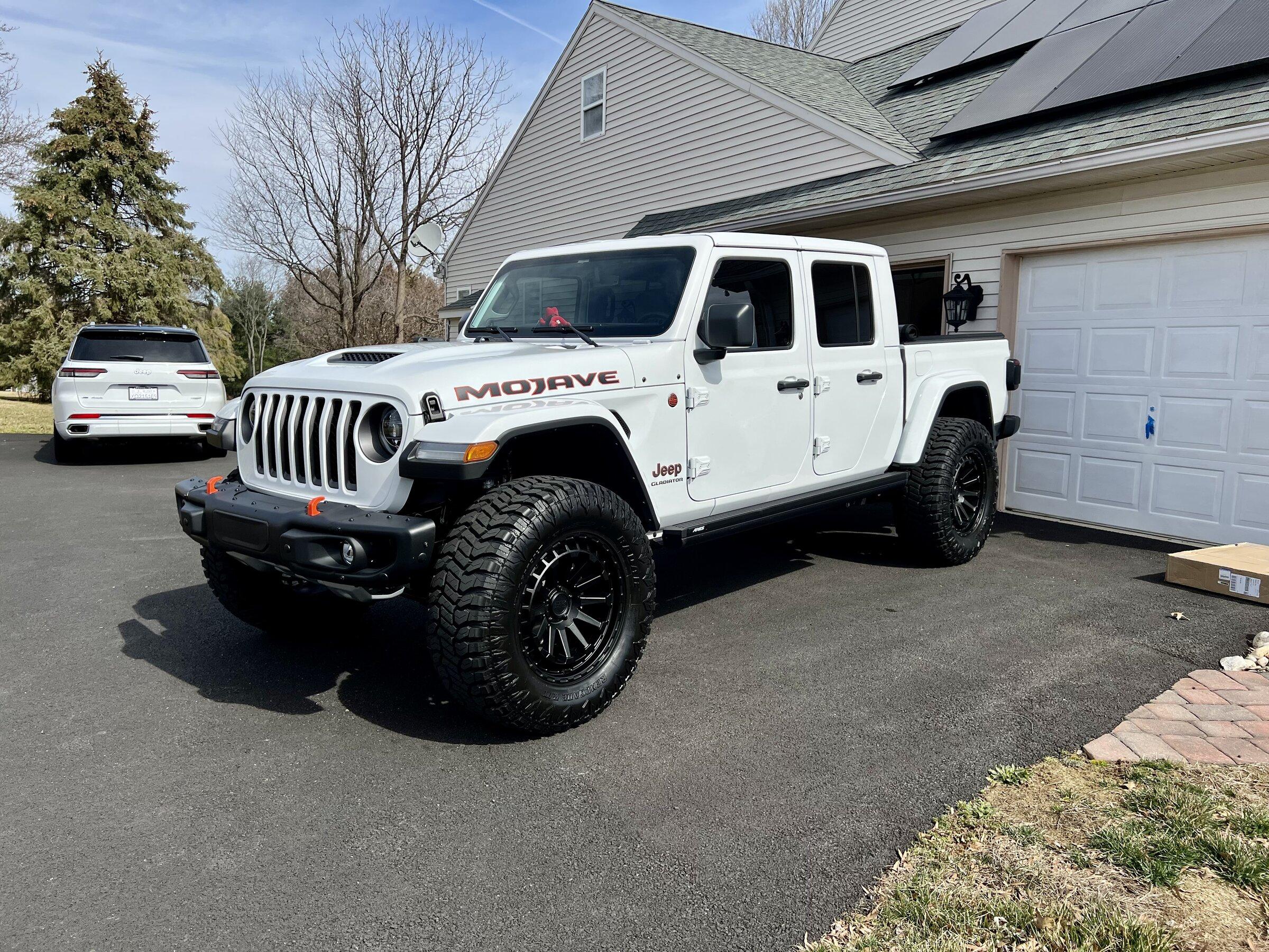

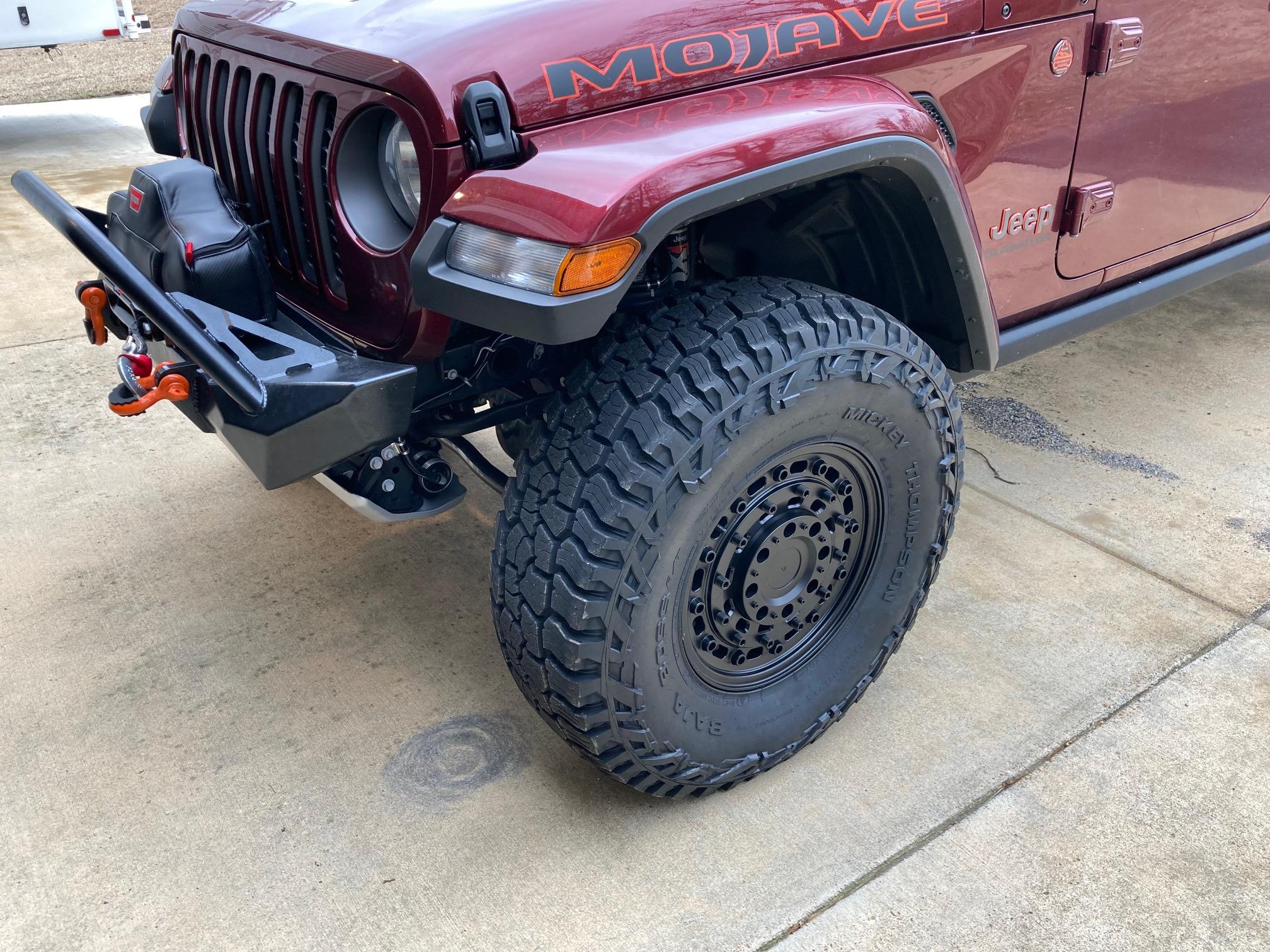

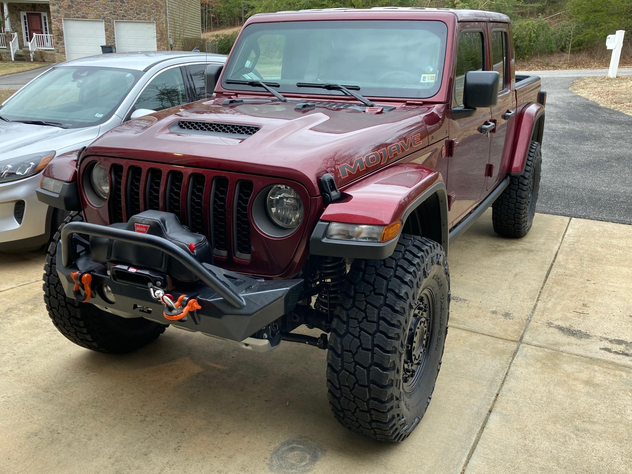

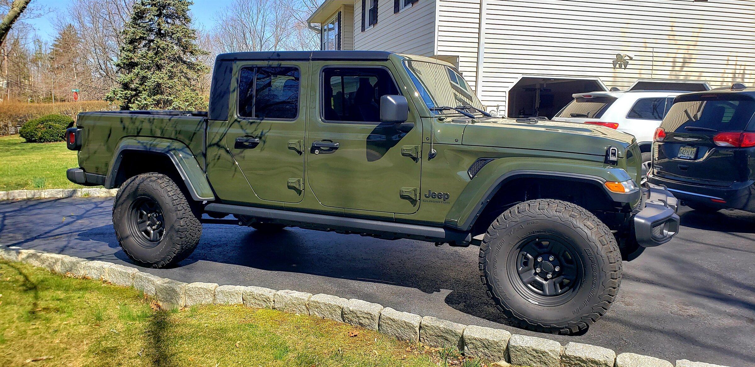

Installed the AEV 2” spacer lift on my 22 Mojave with 37s. Honestly love the look however I do wish the gladiator sat maybe 1 or 2 inch taller. I’m looking to either swap my factory coils with the skyjacker 1 or 2” coils but not sure if the Mojave factory shocks can support the additional height.

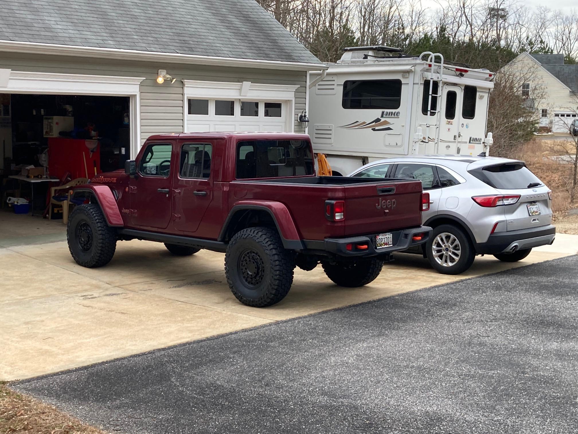

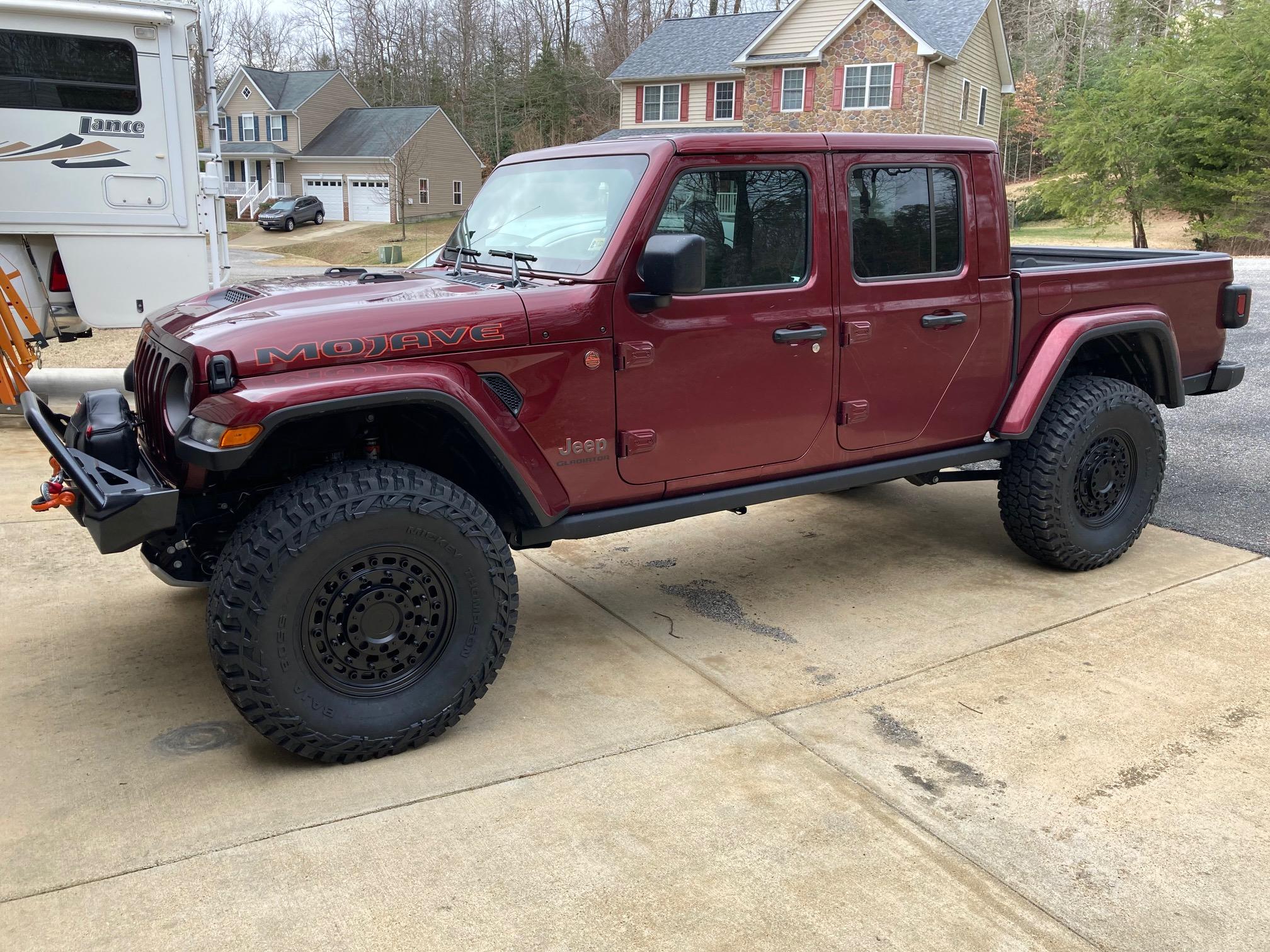

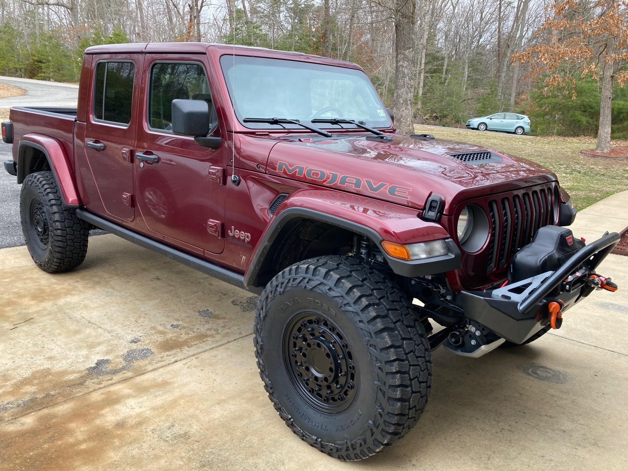

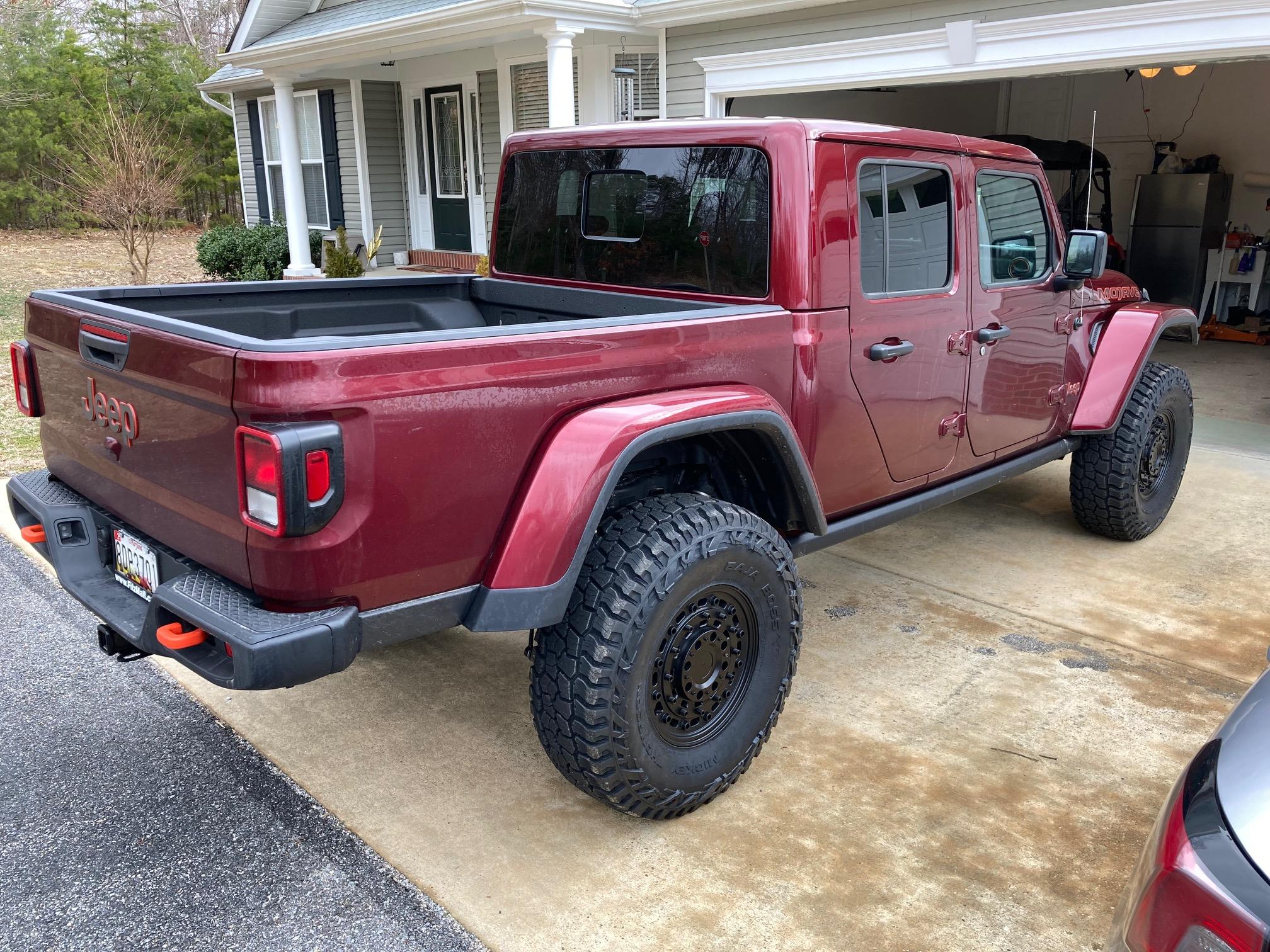

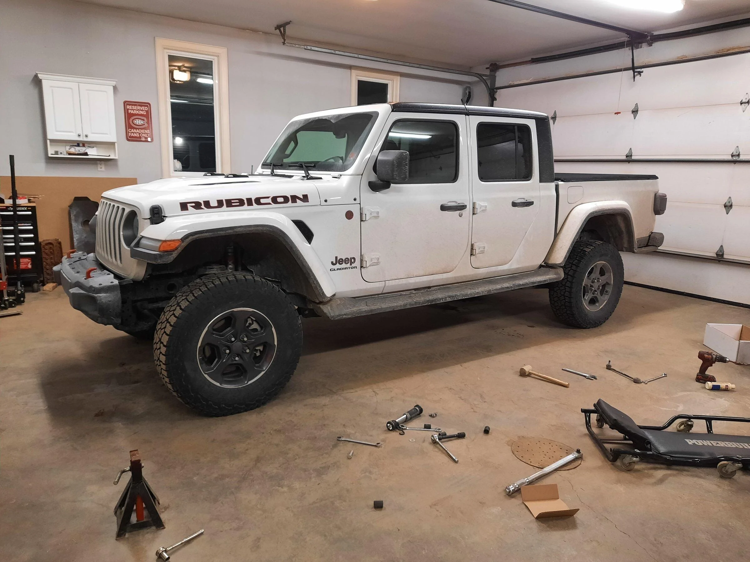

A buddy and I installed my AEV 2" kit in a few hours about a month ago. I also swapped to a set of 37x12.50x17 Baja Boss A/T's and Arsenal wheels.
As a heads-up, you do NOT need to loosen (at all) the front upper control arms to be able to get the front coils out.
Also, a good 1/2" impact gun is your friend.
