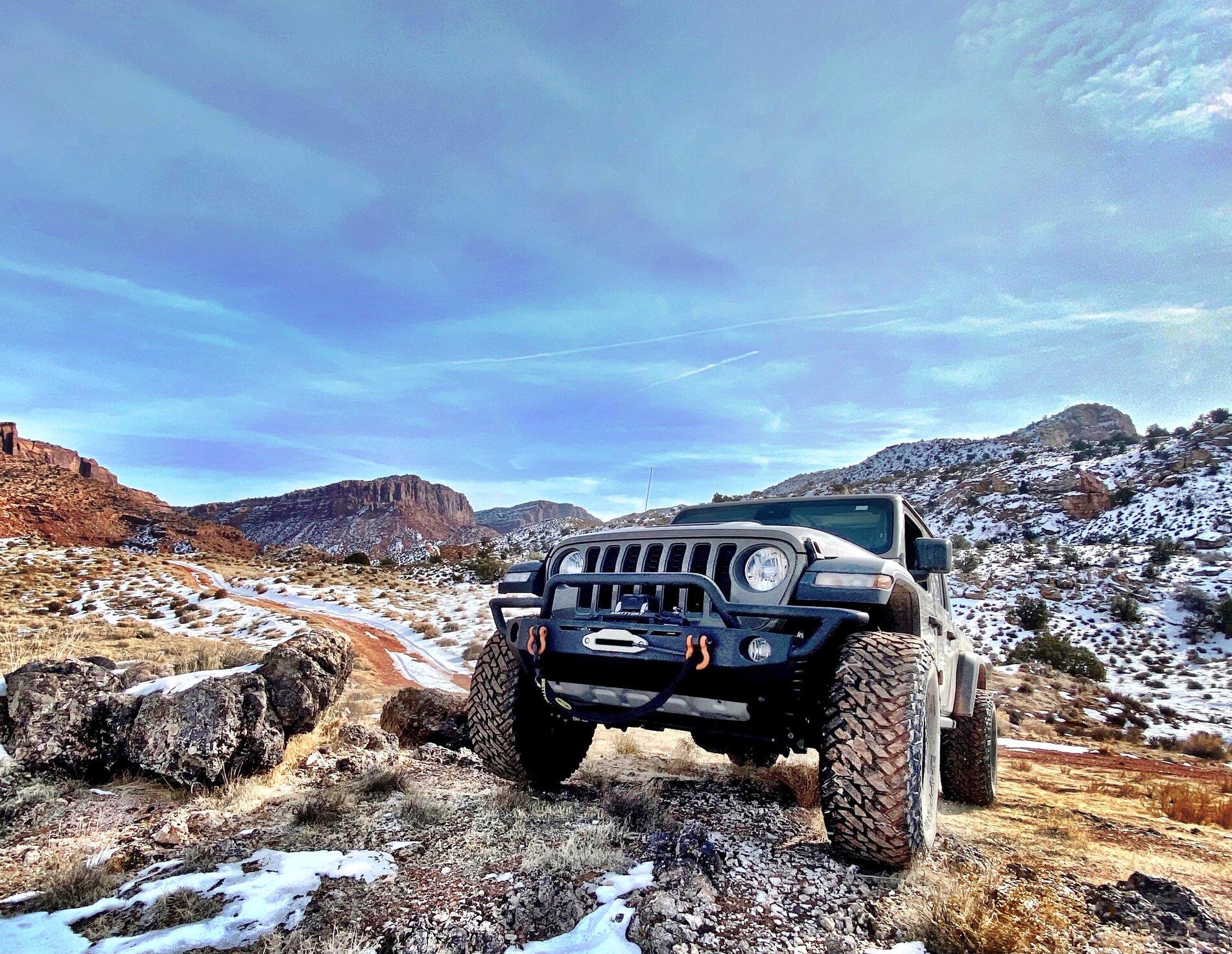

I’m using Iron Rock 2inch lift front and rear. I had no problems with the lift kit in the rear with Mojave, but in front I had to ask an additional pair of bracket to drill a hole myself in the correct position of the suspension. One concern was about the hydraulic joint bumpers, but the kit worked just fine with that. I received really good support from Iron Rock from start to the end.

Iron Rock is well made and pragmatic. Less changes compared with other lifts you find in the market. I just return from Moab and stressed the lift to the limits.
No changes in links and sway bar. I wanted to keep the stock maximum and minimize changes on Mojave and Iron Rock was the right choice for my project.
I did not add bump stops. In Mojave they are hydraulic ready.

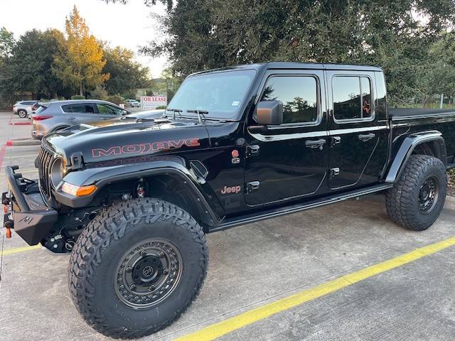

Just went to M/T 37's, honestly the 4:10s feel fine, dropped MPG 1-2. While I do plan to regear next year, it's not as pressing as I thought it would be. My first time on Mickey Thompsons and I am very impressed.
