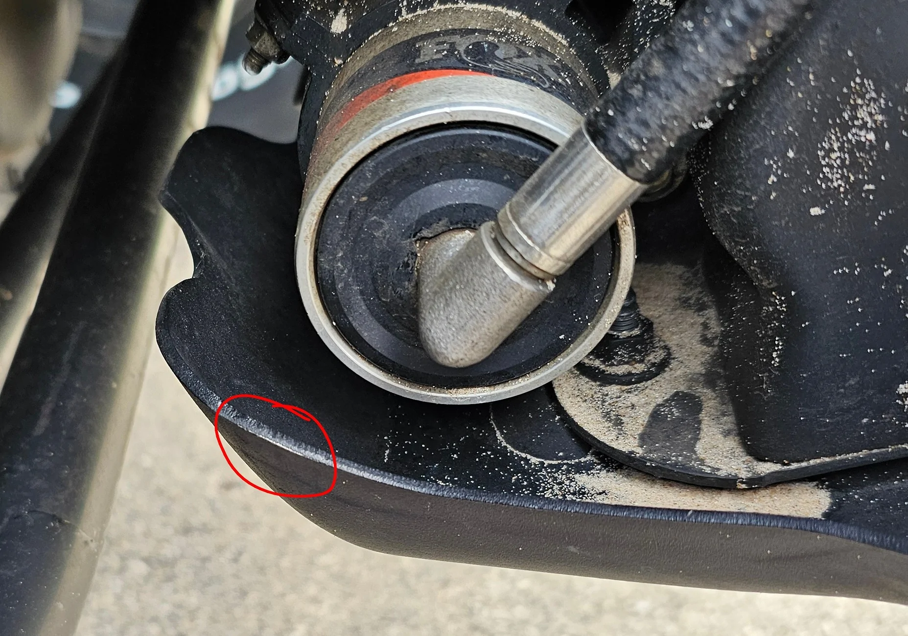

There's no rub when reviewing flat, but when offroading dunes my right tire rubbed the rubi skid plate (mates with metal bumper) on full left turn. I was not disconnected. I was at 12psi, but bulge is mostly at the foot print.

1. Trim the rubi skid, which lips a little higher than the Mojave skid. If no one else had rubbing, this may be the deal. But with the reservoirs so close, I don't want to assume it's all that's needed.

Suspected rub point based on powder coat missing (but further back than expected):
