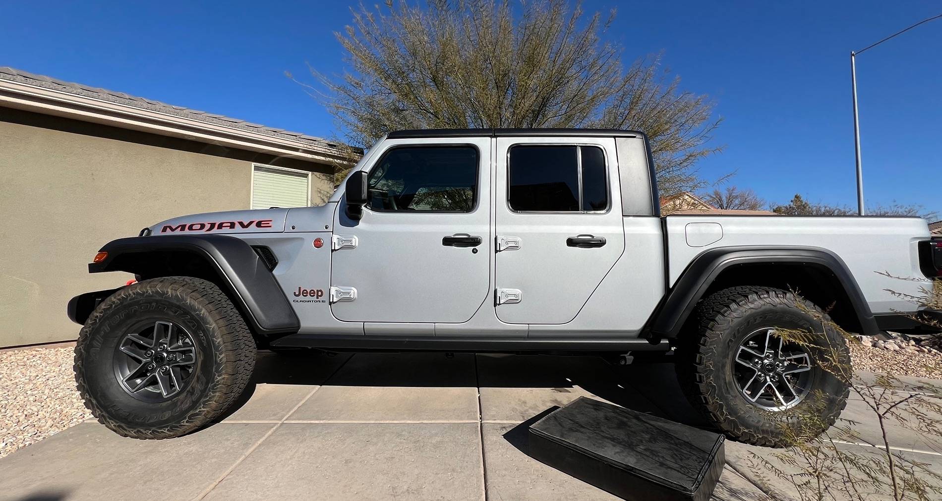

Can I run 37" KO2's with stock wheels without rubbing anything? Will I need wheel spacers? I have an opportunity to grab some Bronco Raptor takes offs with less than 500 miles on them. Plan is to do the 2" AEV spacer lift in a couple weeks. The weight of the tire is the same basically from the stock AT3's vs 37 KO2's.

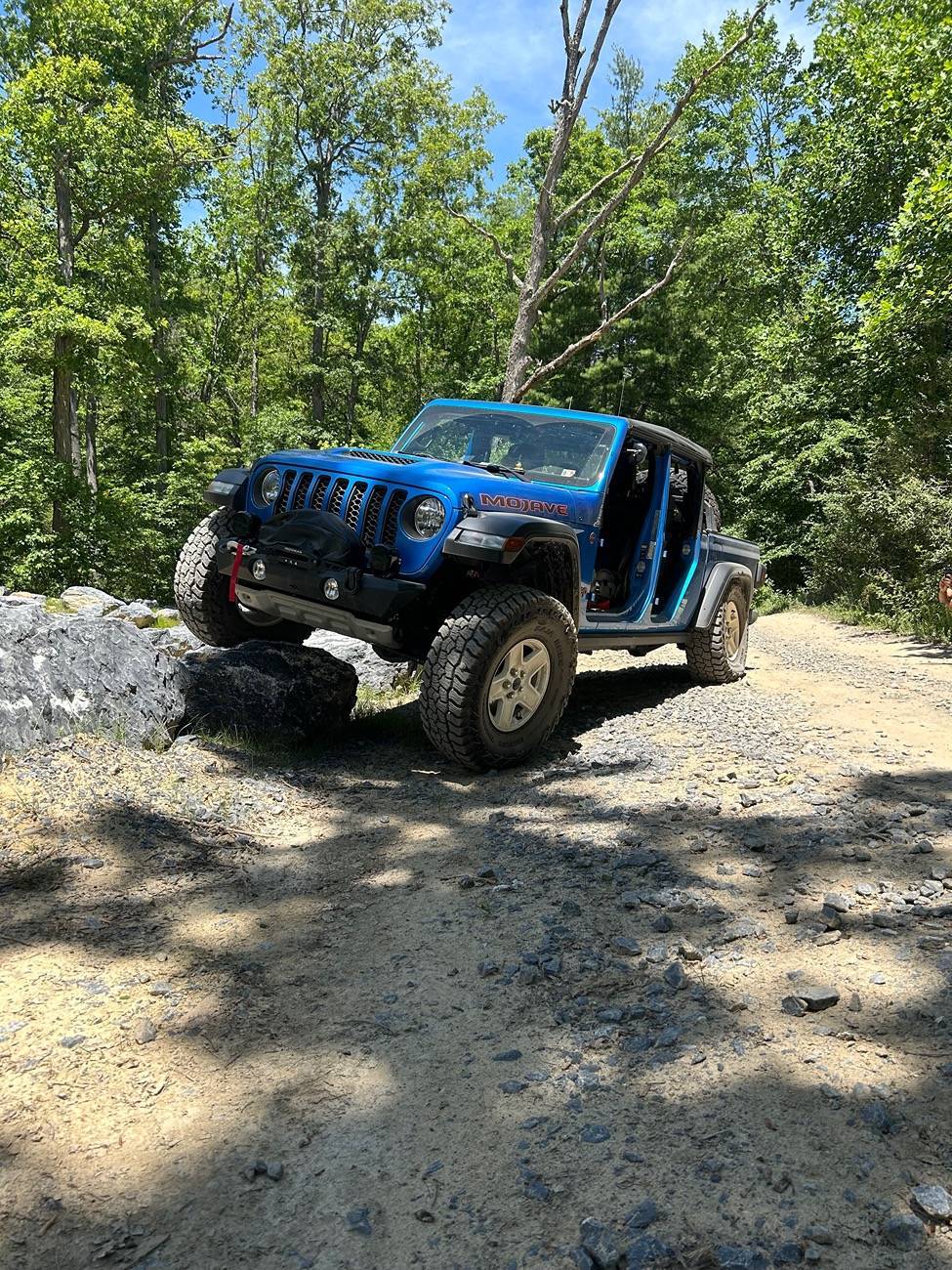

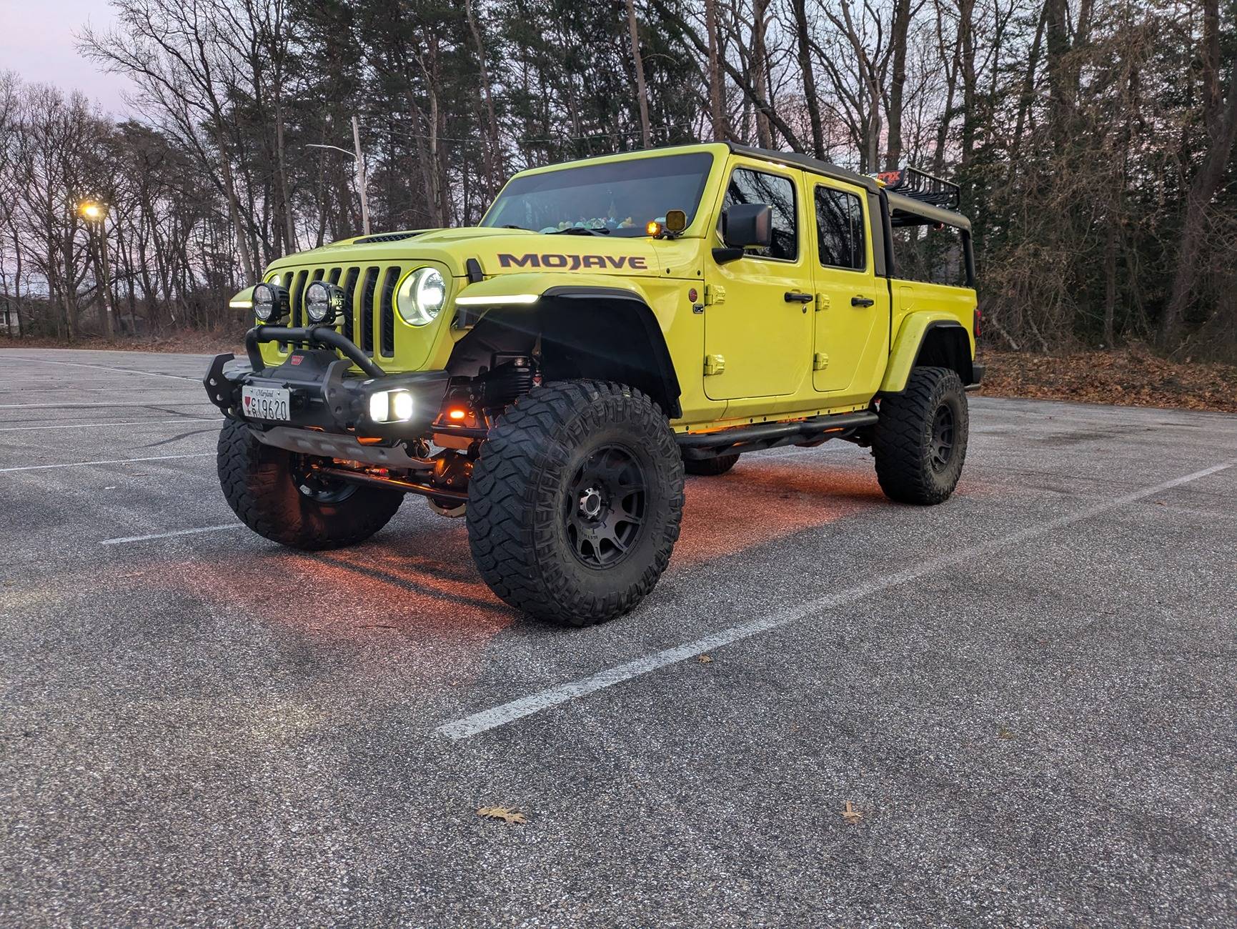

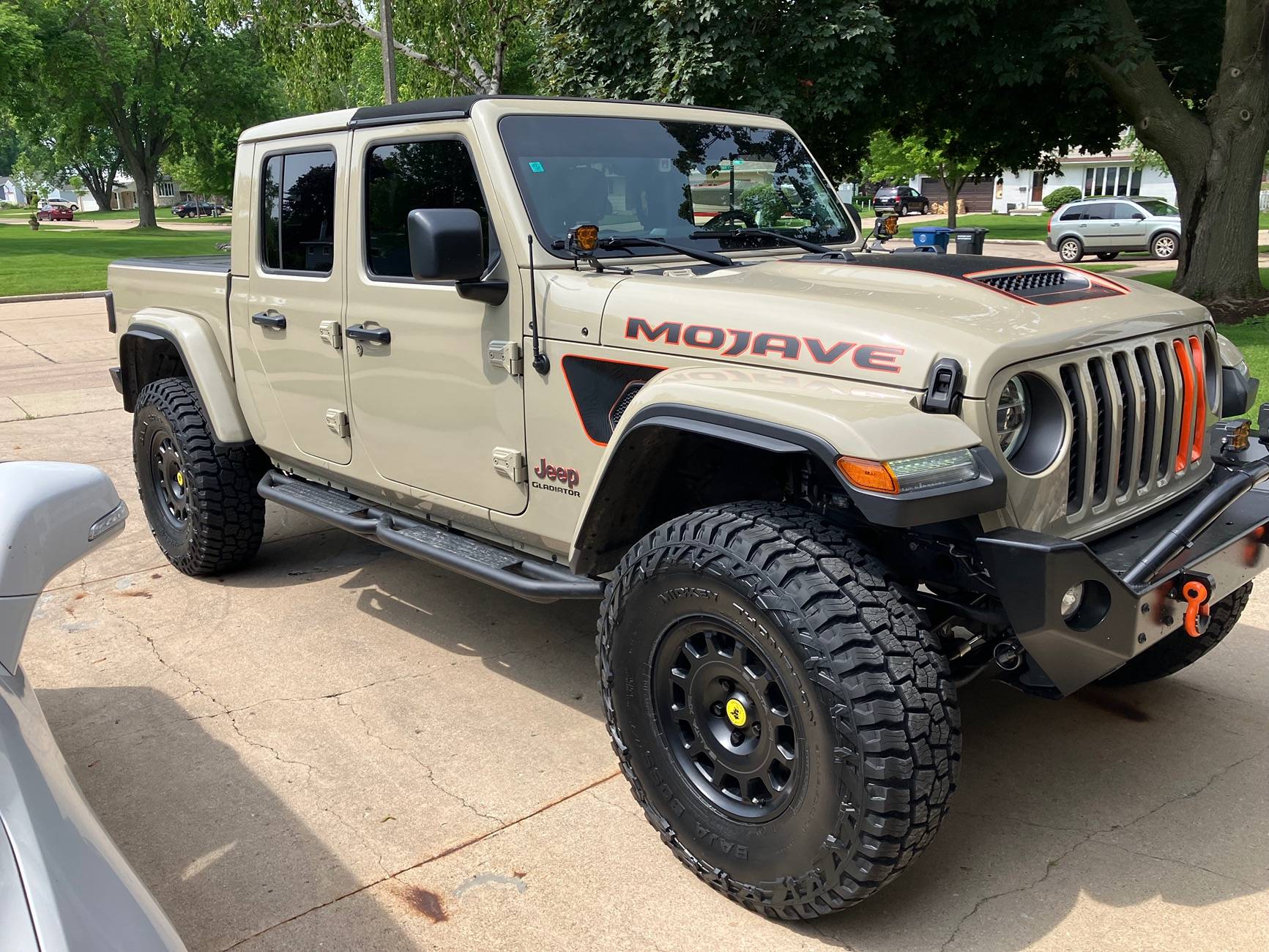

Pics to follow.
MC GC 4.5 on 37x13.5 Maxxis RAZR MTs
Jeep Gladiator Lifted Mojave Club PXL_20241219_215324927.MP
Jeep Gladiator Lifted Mojave Club PXL_20241219_215311849

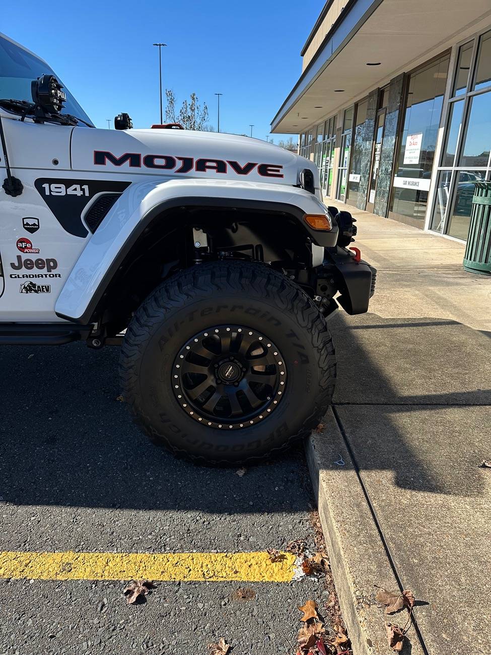

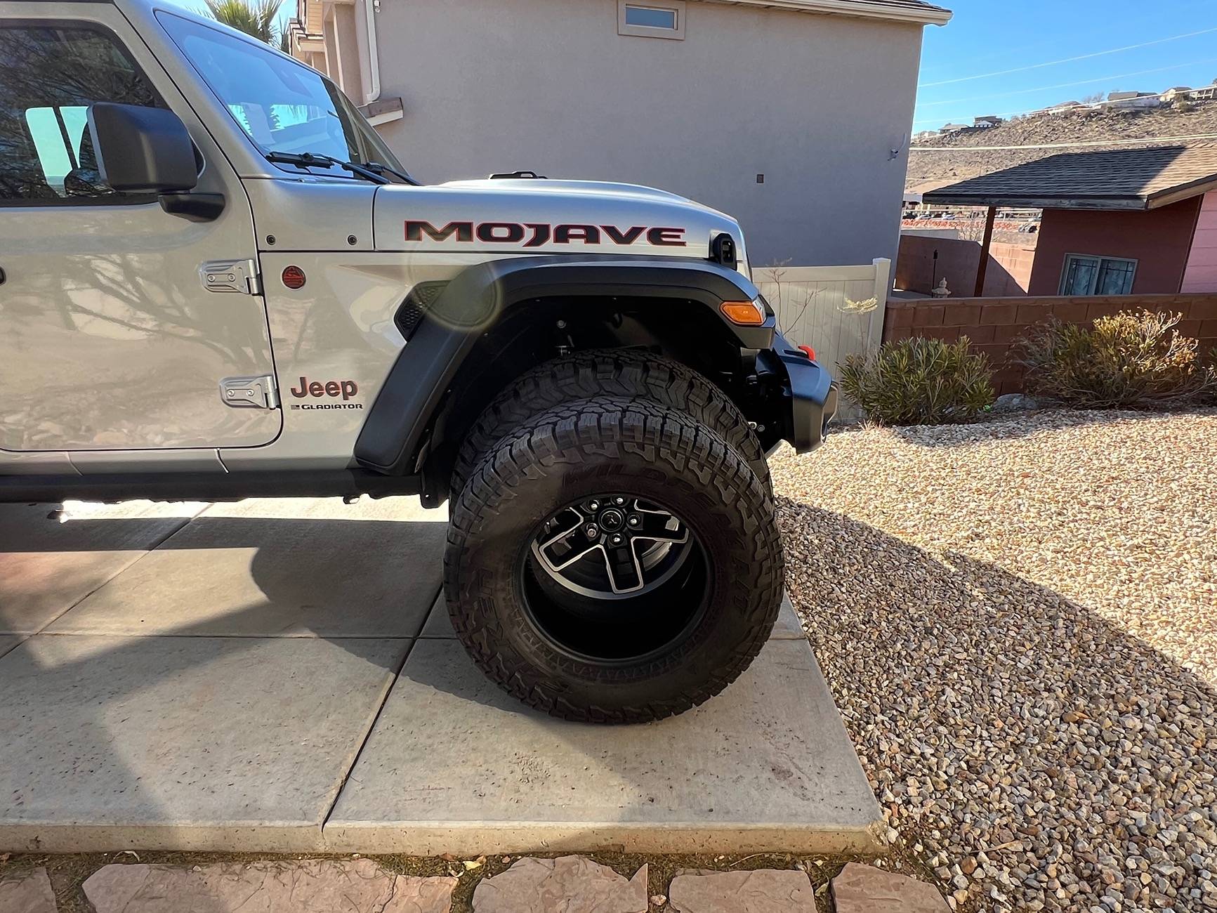

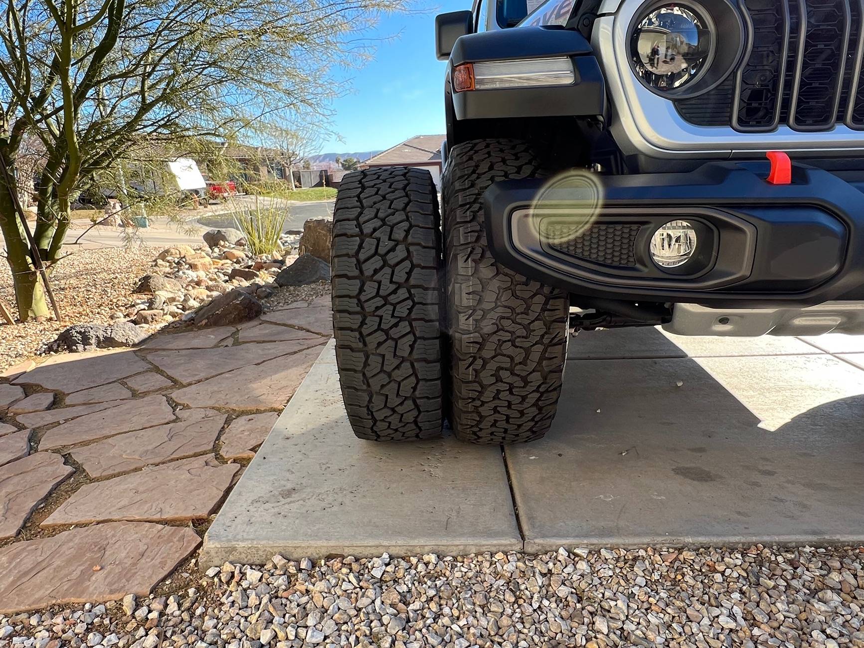

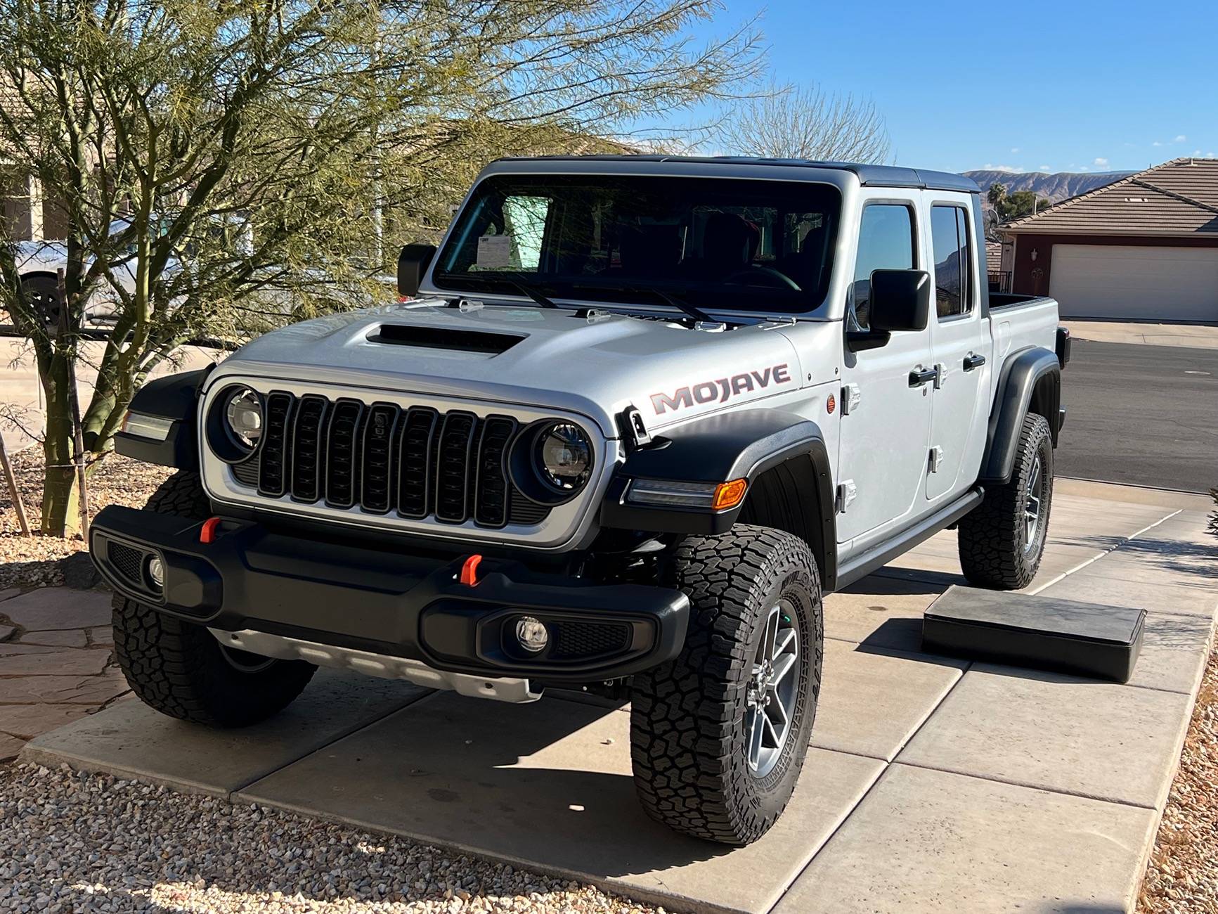

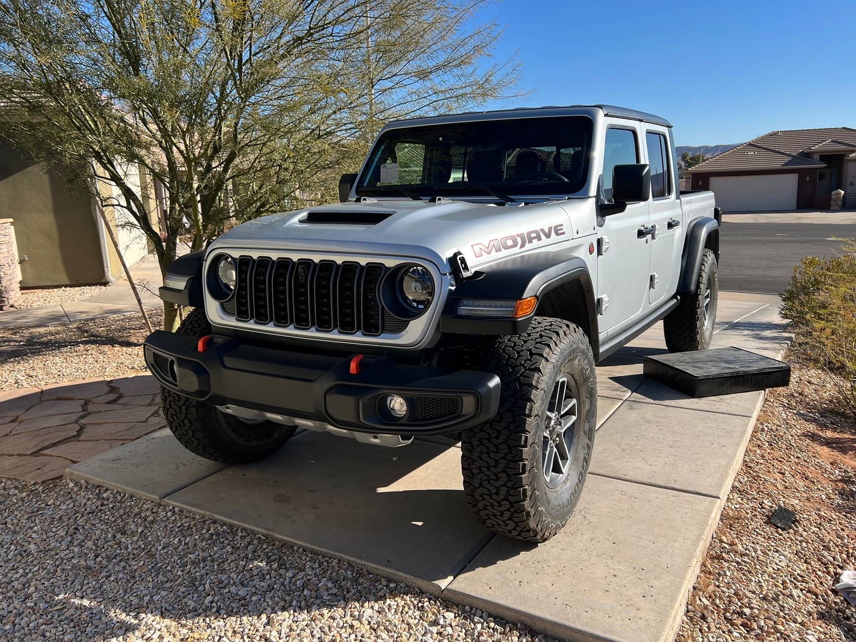

Well I jumped on a deal for 5 new takeoffs on a Bronco Raptor for $1200. So far on the road I haven't heard or felt rubbing. The spare also fit under the truck. A real 37" probably wouldn't, but these are barely a 35 as everyone knows. I like the AT3's better, but the KO2's have always been reliable. The weight difference was 1/2 a pound per tire. I think I read the KO2 37's run less wide than the 315's. Thats crazy to me.
Before:
Jeep Gladiator Lifted Mojave Club IMG_0171
After:
Jeep Gladiator Lifted Mojave Club IMG_0197
Jeep Gladiator Lifted Mojave Club IMG_0199
Jeep Gladiator Lifted Mojave Club IMG_0196
Jeep Gladiator Lifted Mojave Club IMG_0195

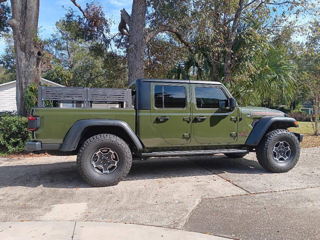

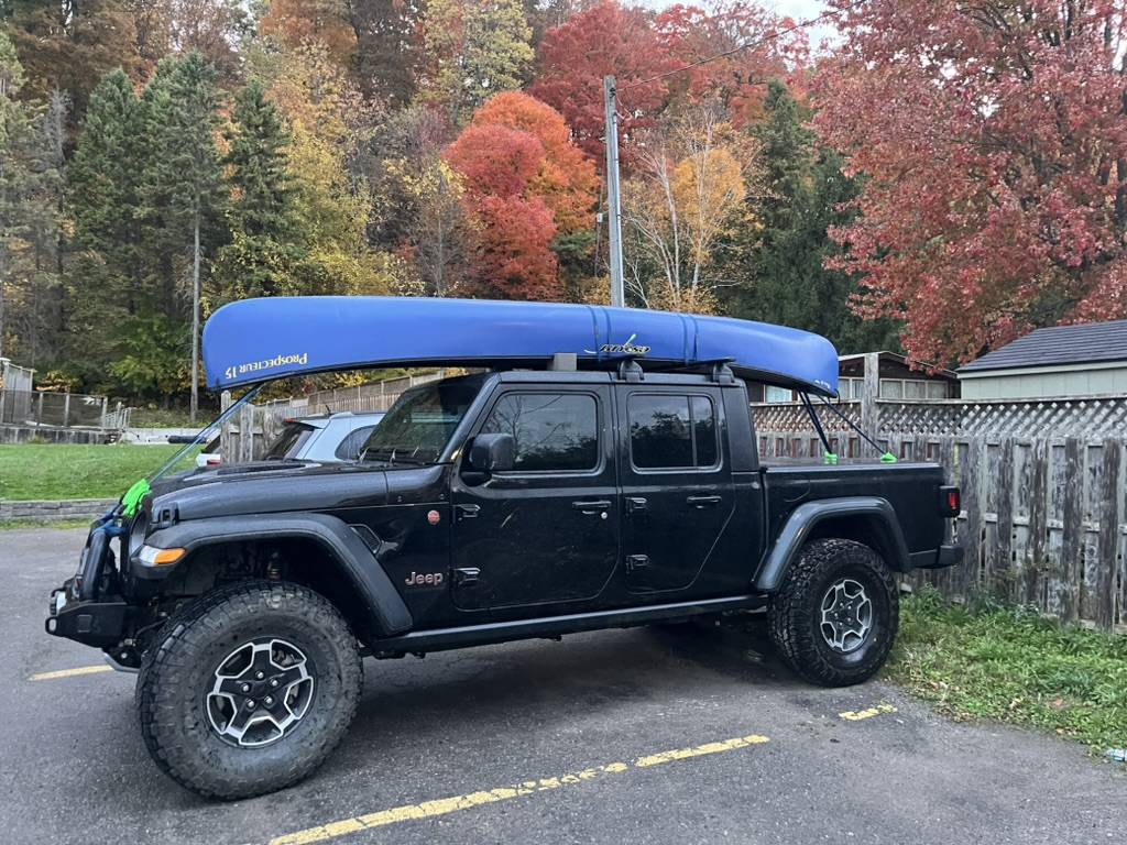

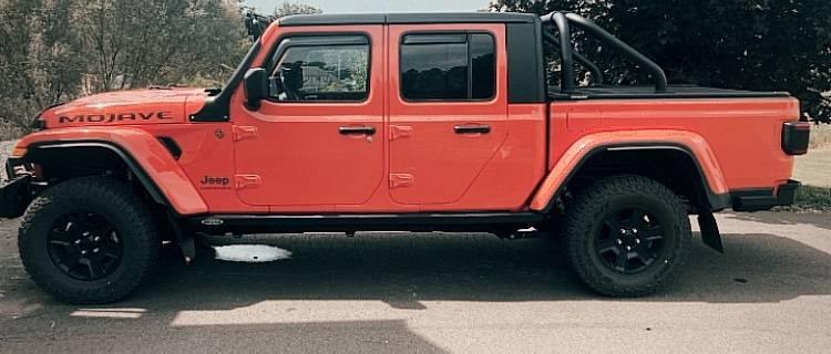

Yes, yes you can. No you will not need spacers. Maybe a couple of washers on your steering stops and trim the plastic fender liners a little.
Jeep Gladiator Lifted Mojave Club 1736881177597-wi
Yeah it has a little rubbing somewhere so I'm going to start with zip tying the liner a little and see. Then maybe a trim. Trying not to mess with suspension at the moment.
