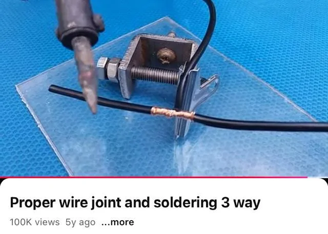

Would that be something like this? How do you heat shrink the t joint?

Liquid electrical tape; it works but can be sloppy. I also zip tie the extra wire to one of the existing as a strain relief. Wrap with traditional electrical tape, then cover with plastic wire loom.
Others may have a better idea.
