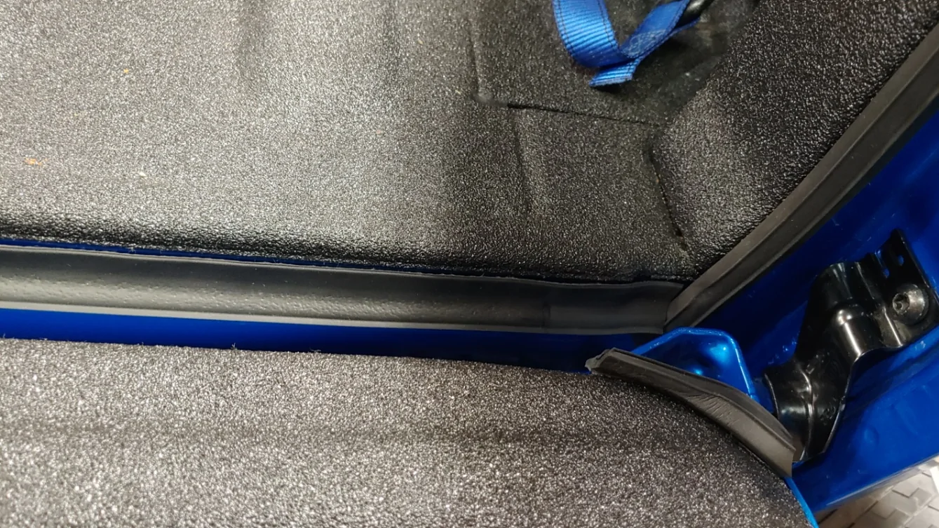

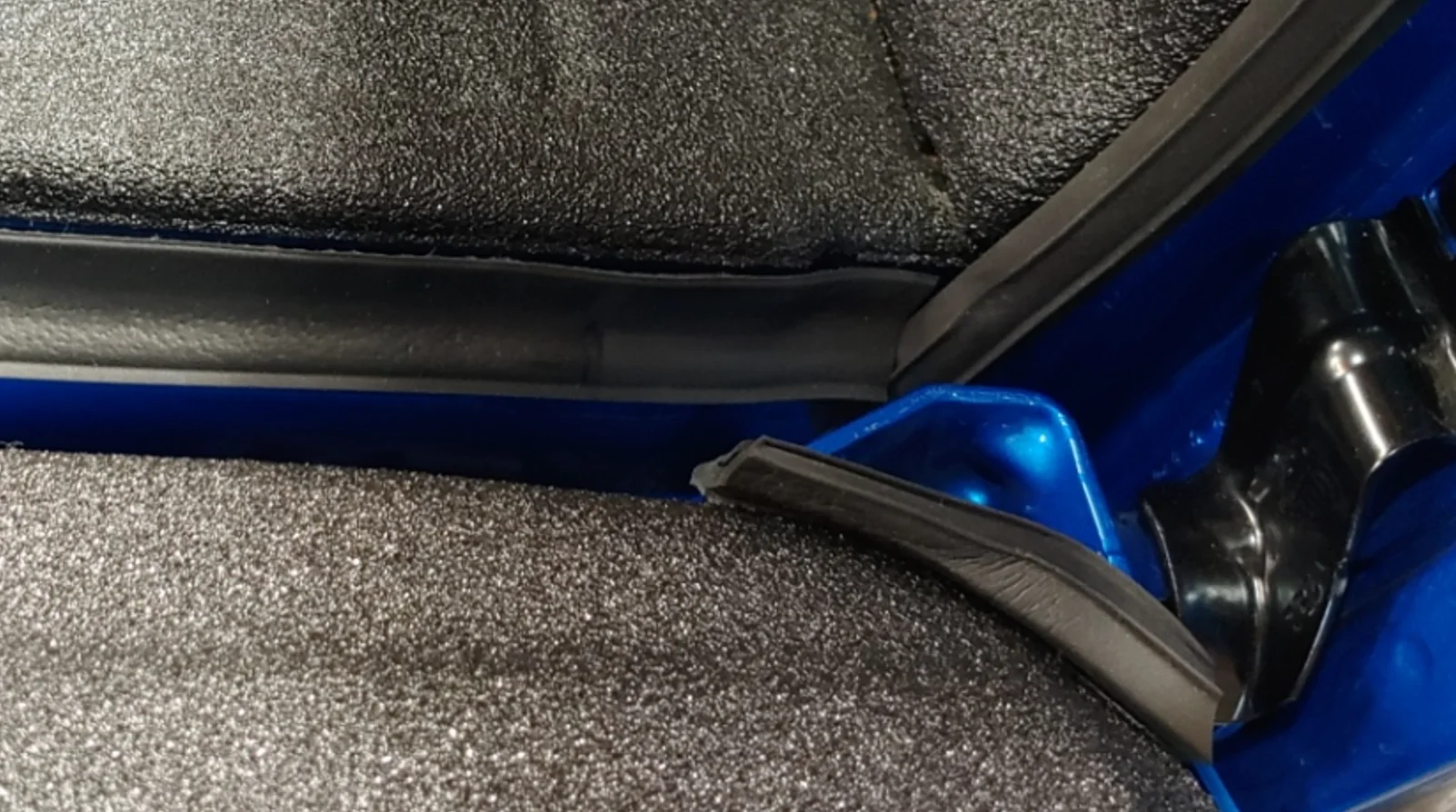

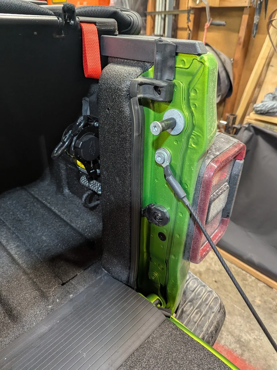

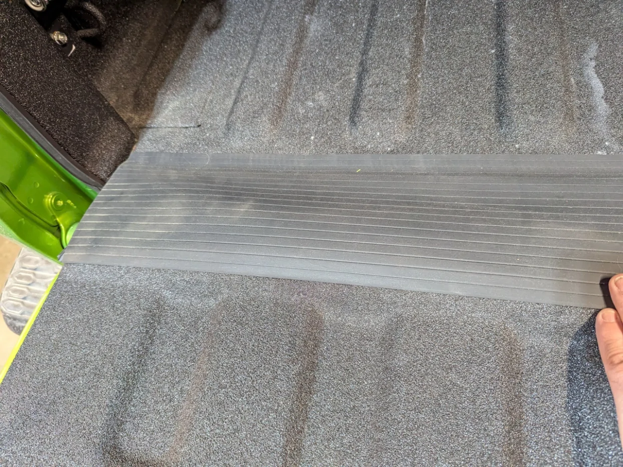

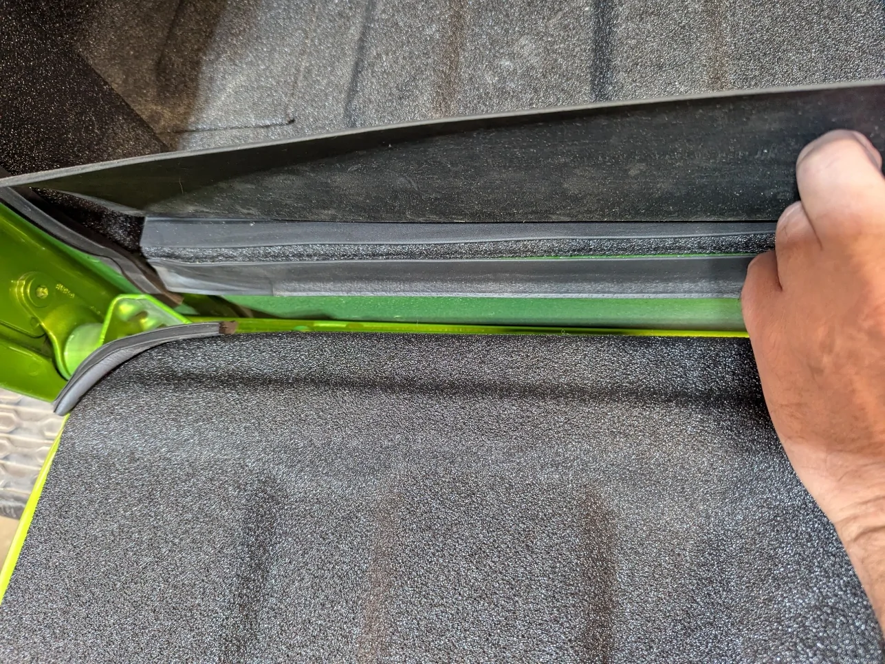

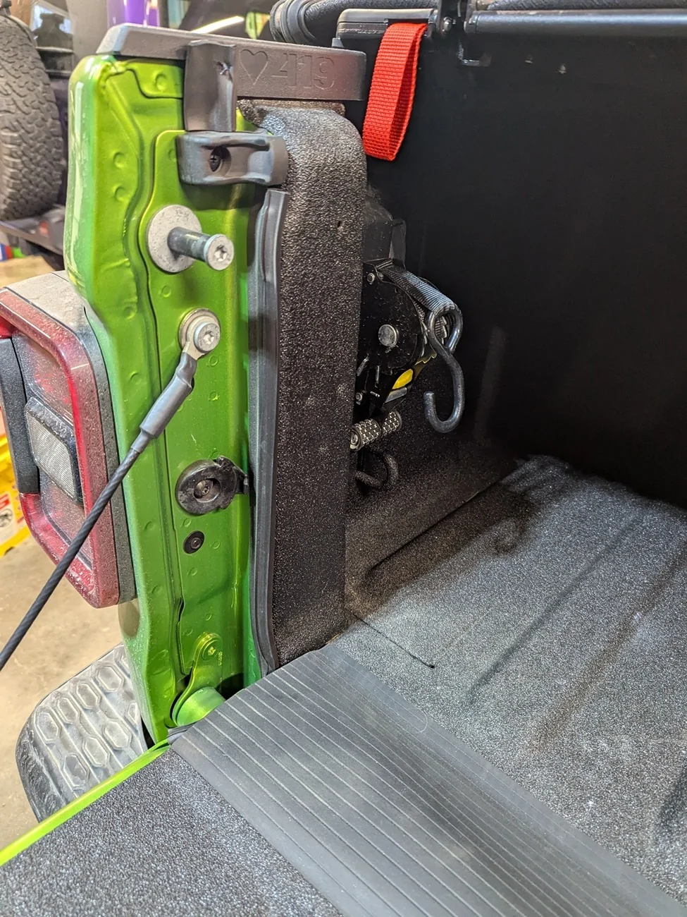

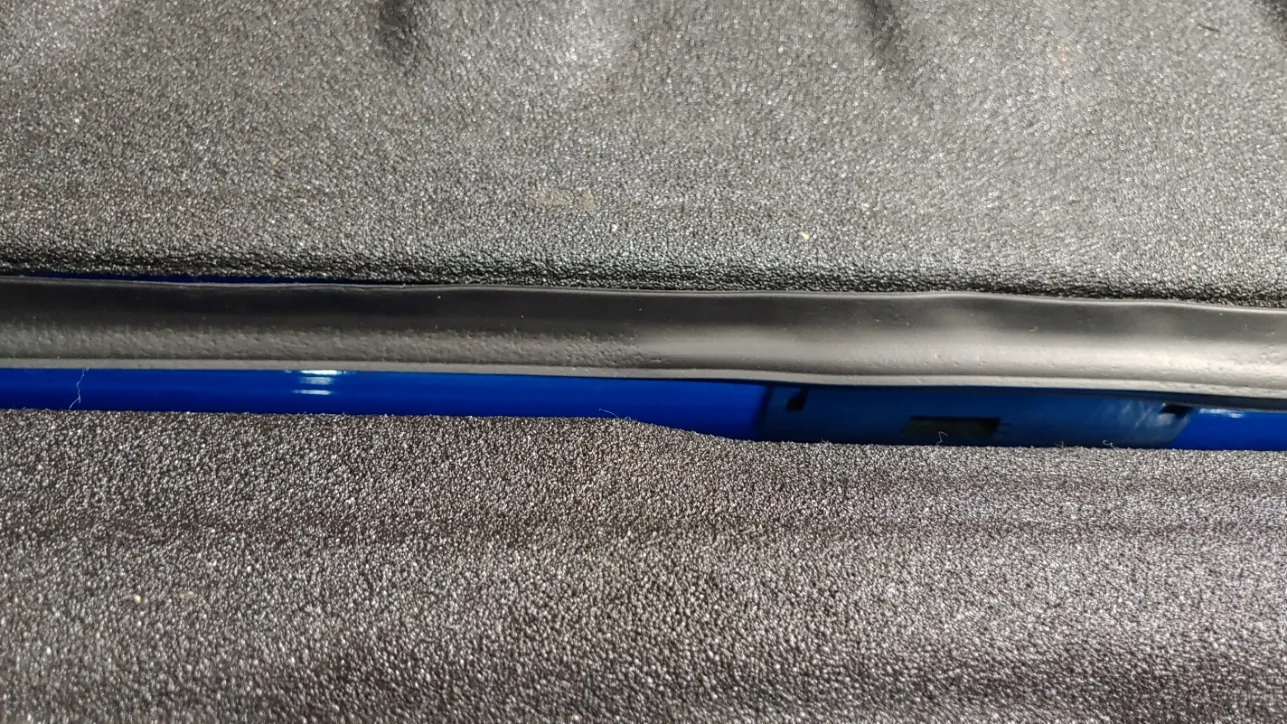

Tailgate seals on two JTs I've owned, the gap bridge I added to the 25
Otherwise, the side seals and the lower seals I did both on my 22 and 25 - I was tired of the DUST getting in on trails and gravel roads, and the snow getting in via the bottom gap in the winter.

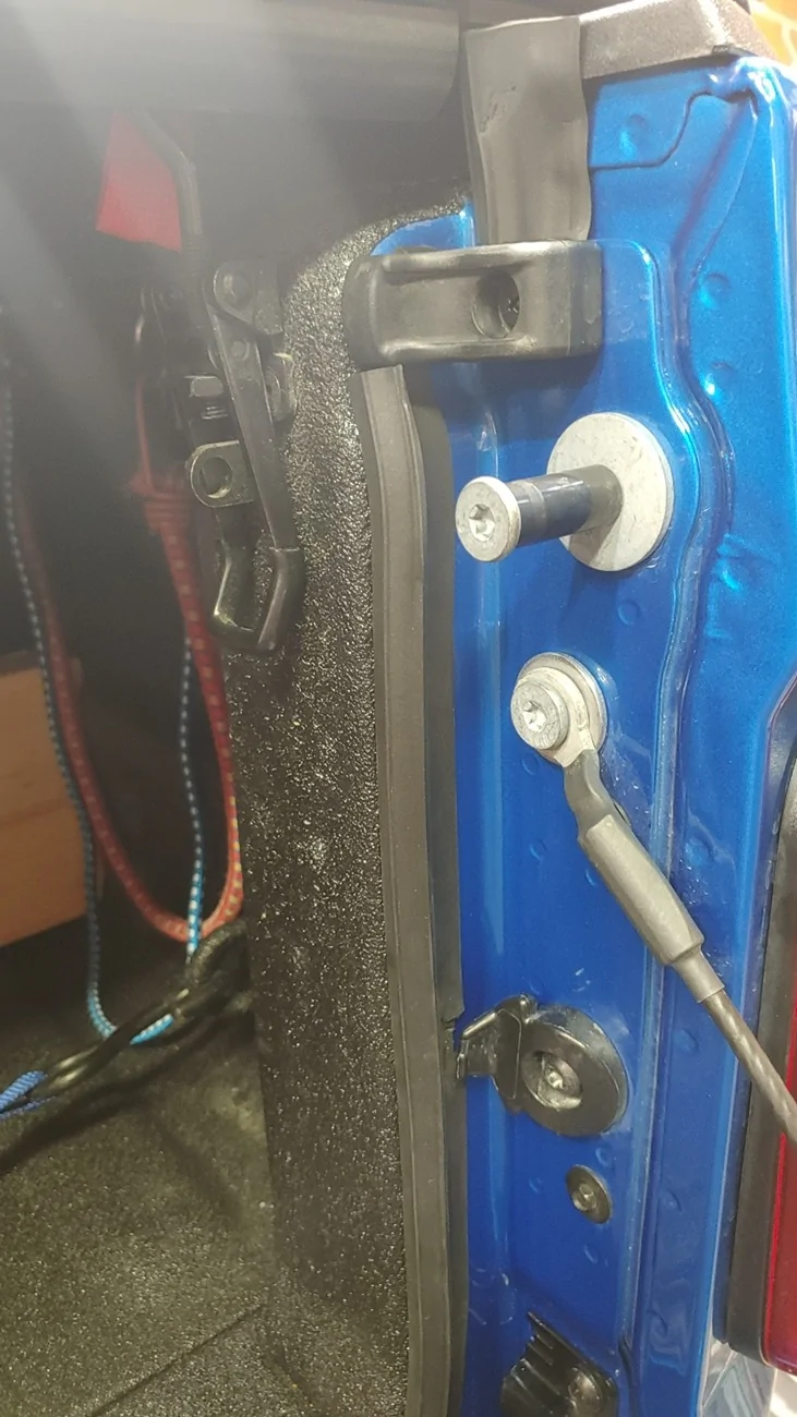

Basically what I did... However I never seen the bridge gap seal. Kinda cool
