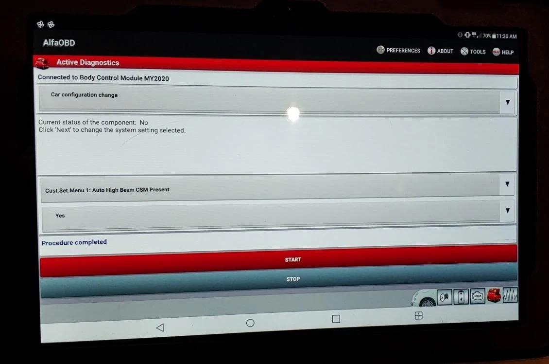

This is what I love about AlfaOBD - the logging - but I have used it to add my passive entry, add automatic high beams, and other stuff.

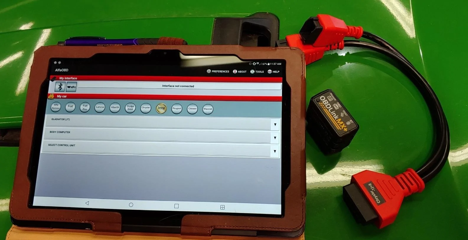

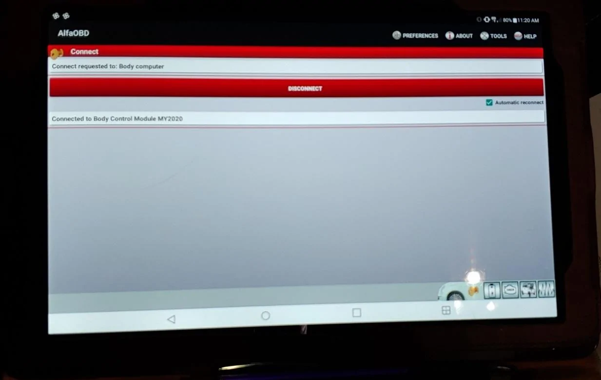

You can install AlfaOBD on any android you own once you buy it. I have it on my phone and my LG tablet. I usually use it on my tablet due to the 10" screen vs. the phone.
Jeep Gladiator Taser vs Alfa OBD vs other 20210110_113706
Jeep Gladiator Taser vs Alfa OBD vs other 20210110_113058
Jeep Gladiator Taser vs Alfa OBD vs other 20210110_112001
