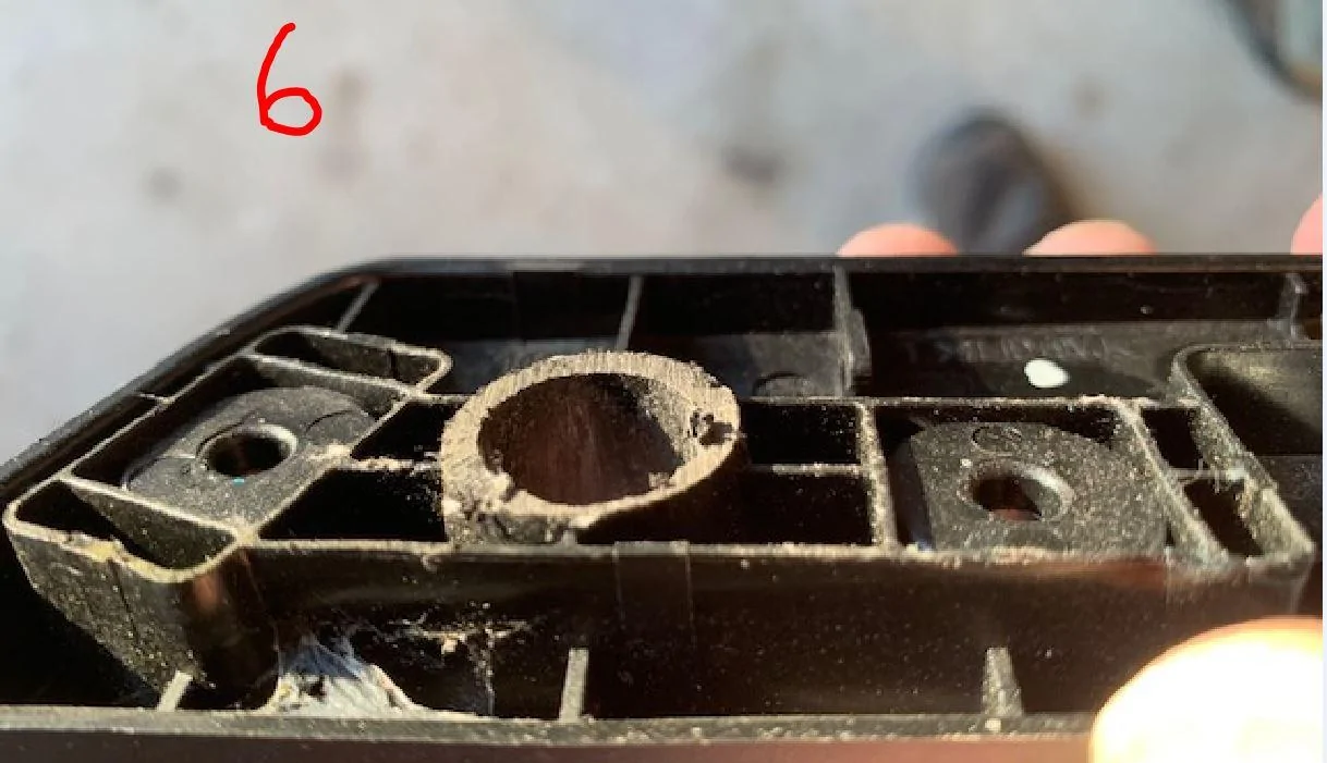

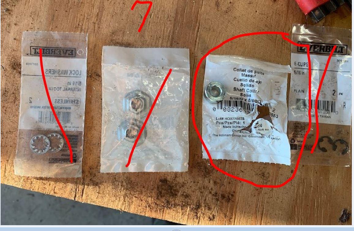

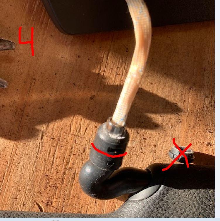

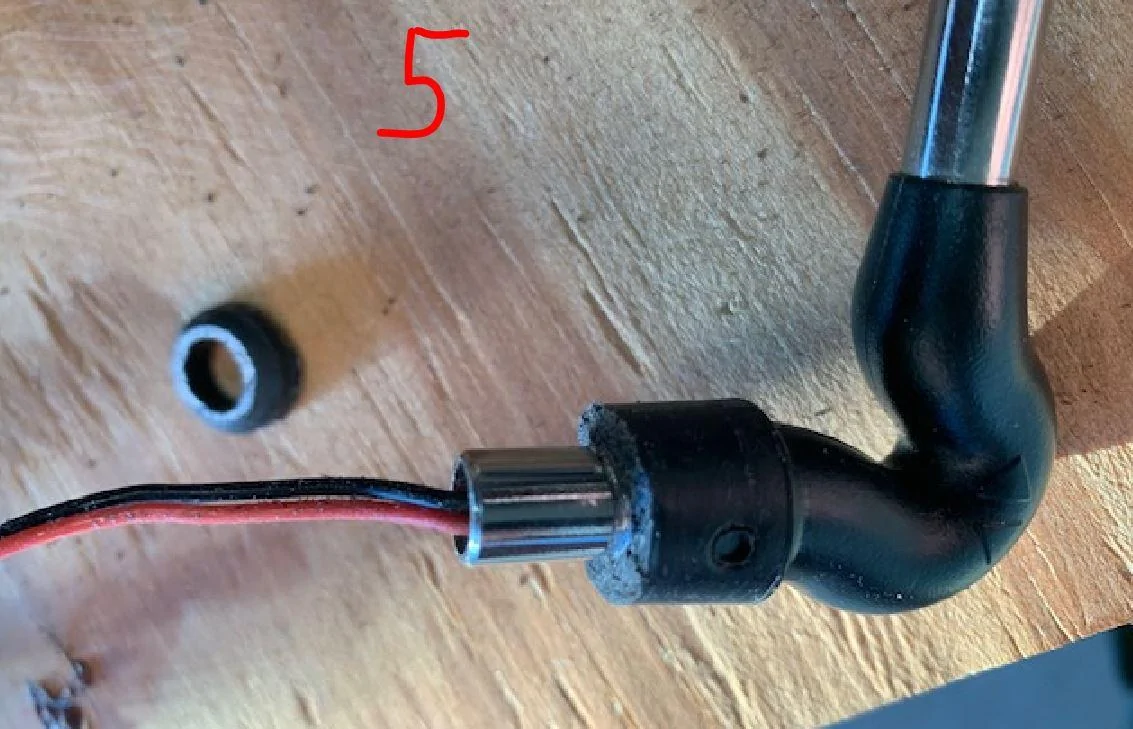

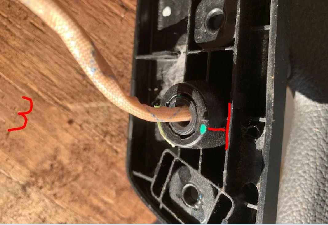

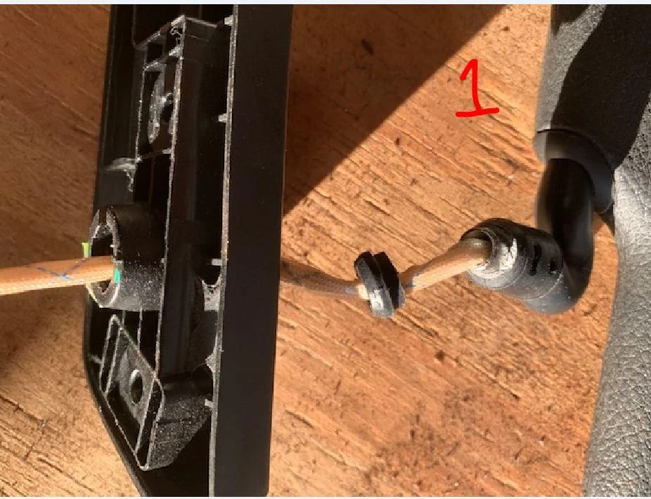

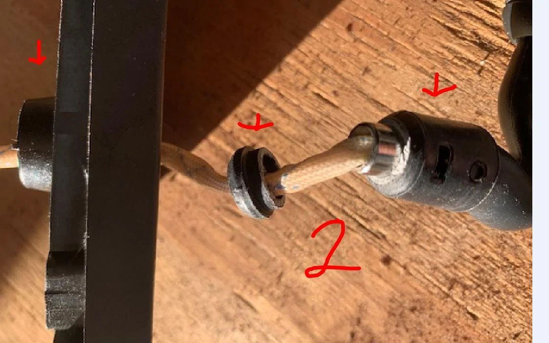

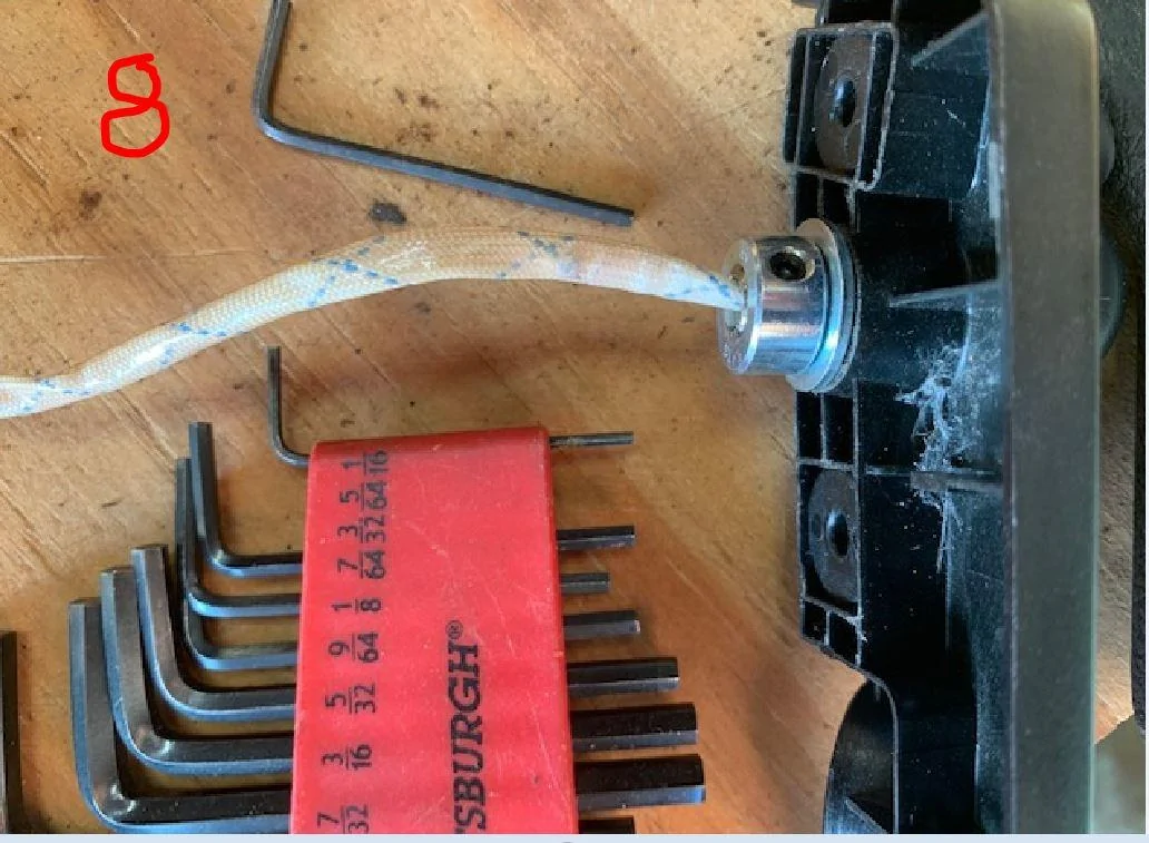

Hokey and rough, ain't no tech writer or photog. Damn strong, 3 bucks. 6MM or 5/16 shaft collar and 1 washer.
1 - shows the broken part, snip and dispose.
2- shows same, I trimed 3/8 off the metal shaft plastic and flush on the left trim piece.
3- Shows before cut on the trim piece
4 - Shows before cut on the shaft
5 - shows after timing the shaft, hacksaw, careful, slow. Might have used a vice with padding??
6 - Trim piece cut flush, hack job but done.
7 - Bought 4 packages only used the shaft collar ( and a washer).
8- Finished product. Been in the truck 2 months now and I use the visor northbound in the AM and southbound in the PM, 7 days a week.
This was the second one that broke. Drivers side. 5 year old grand daughter broke the passenger side last year but hey, she loves this truck!
