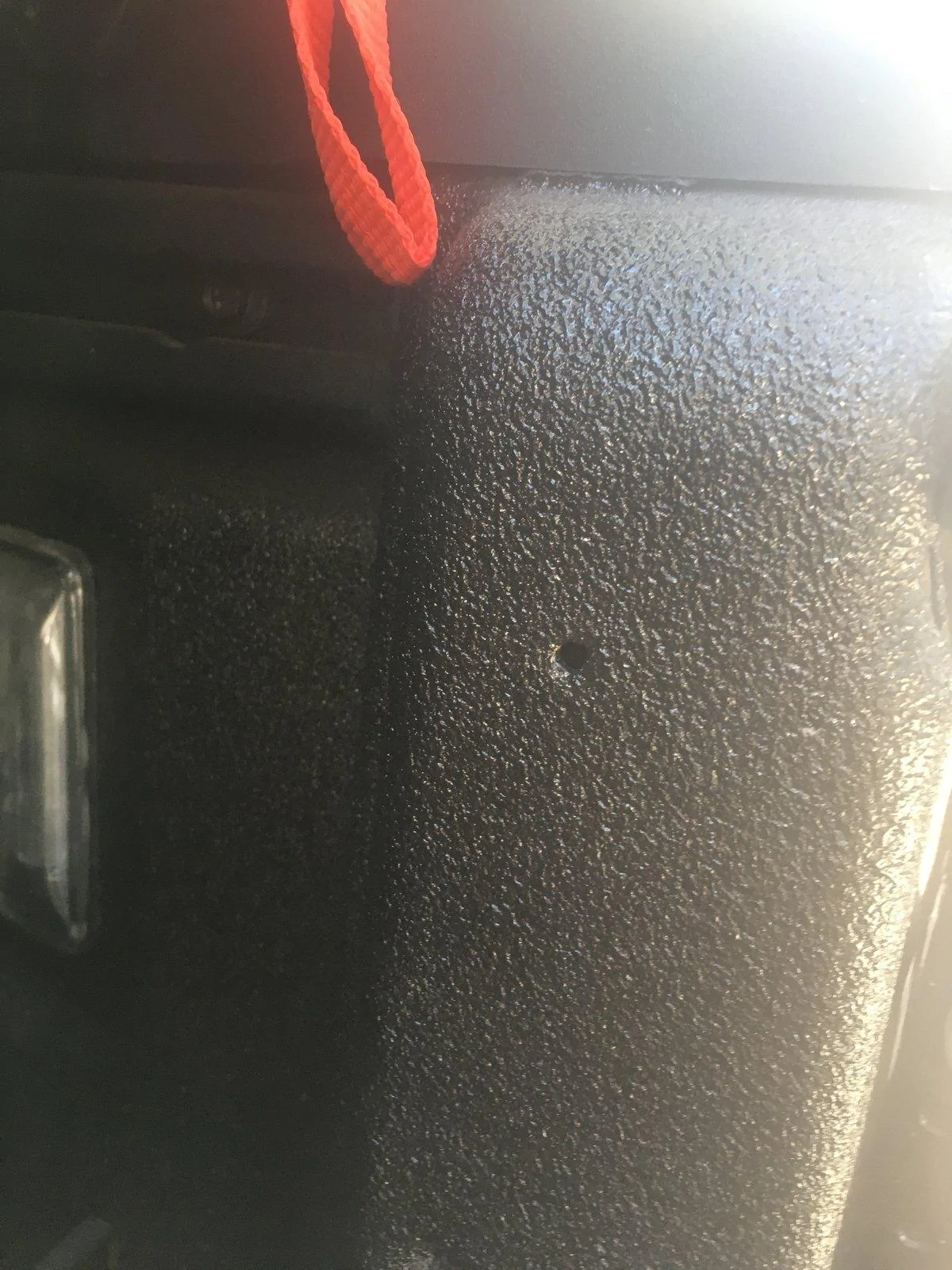

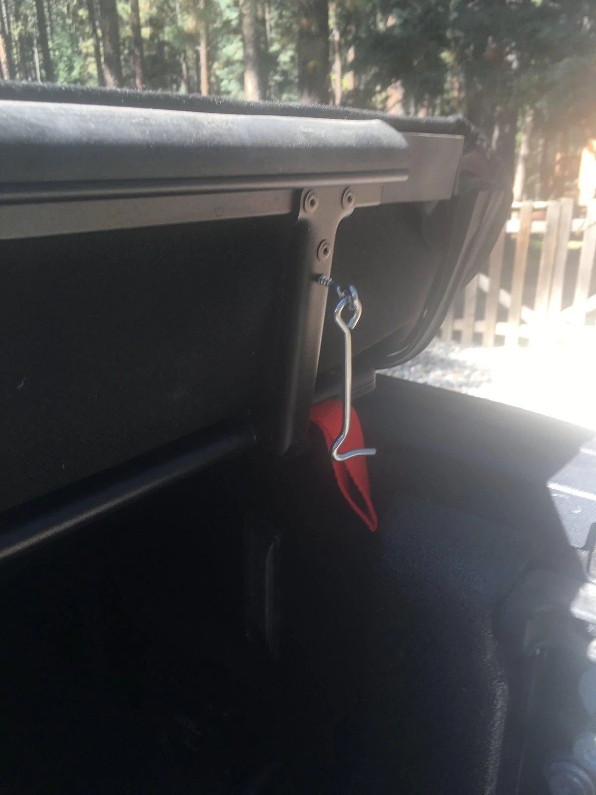

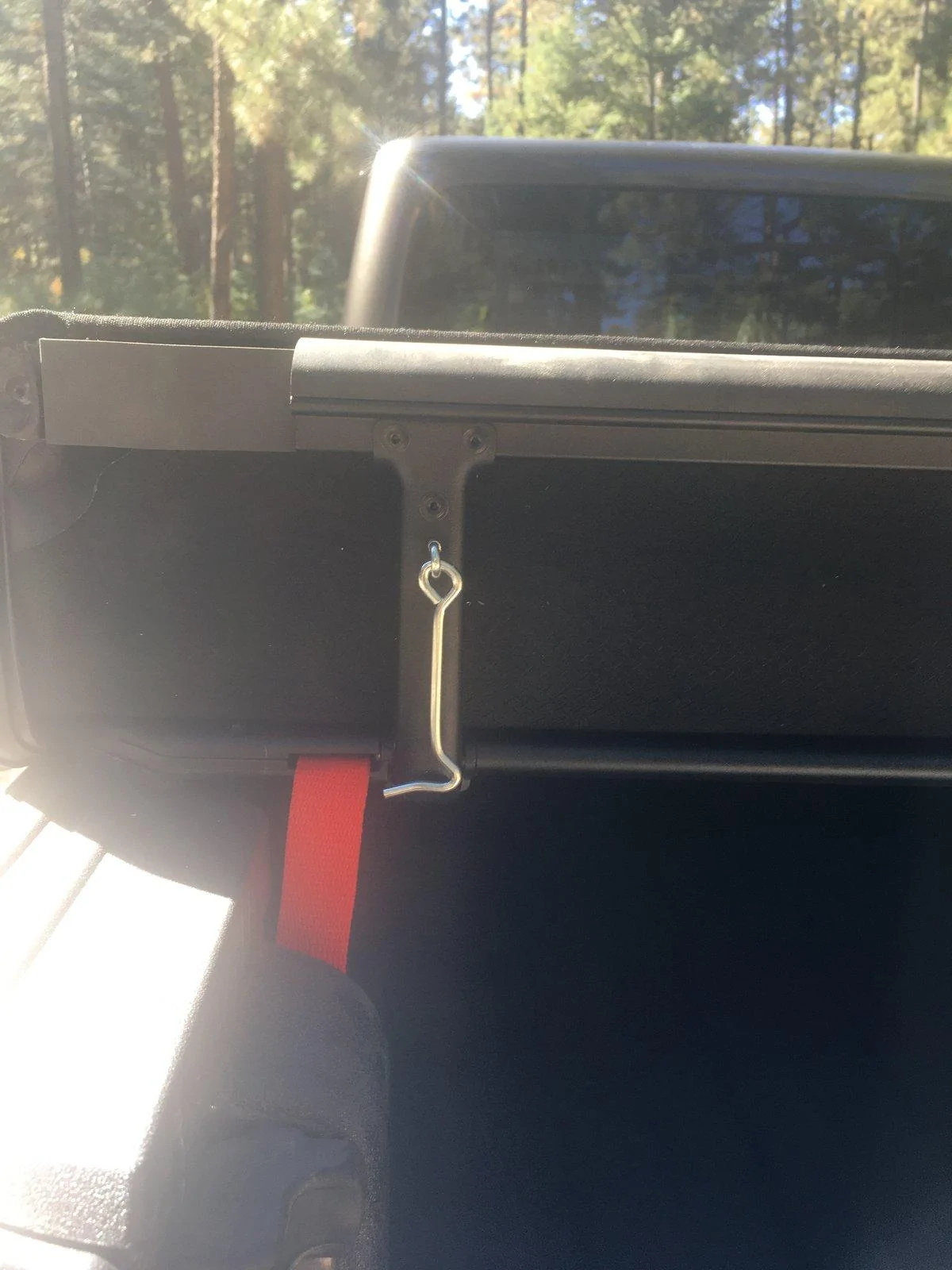

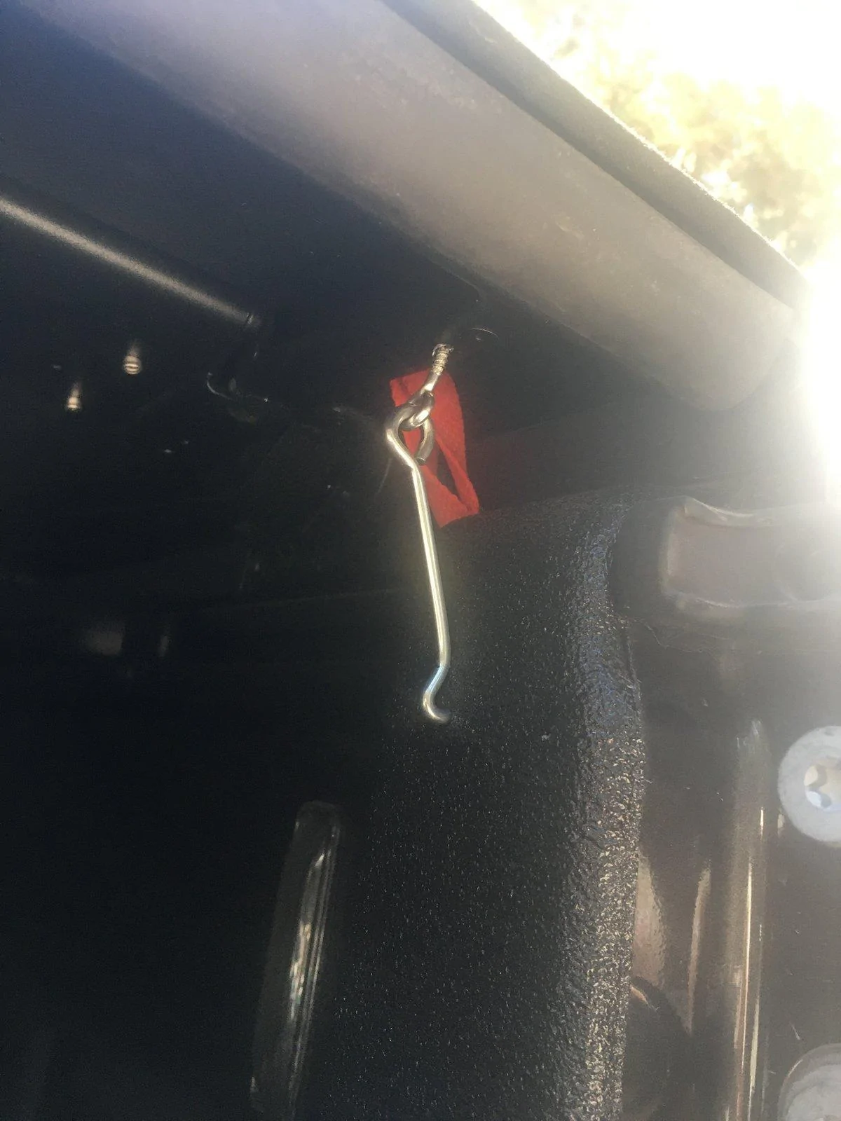

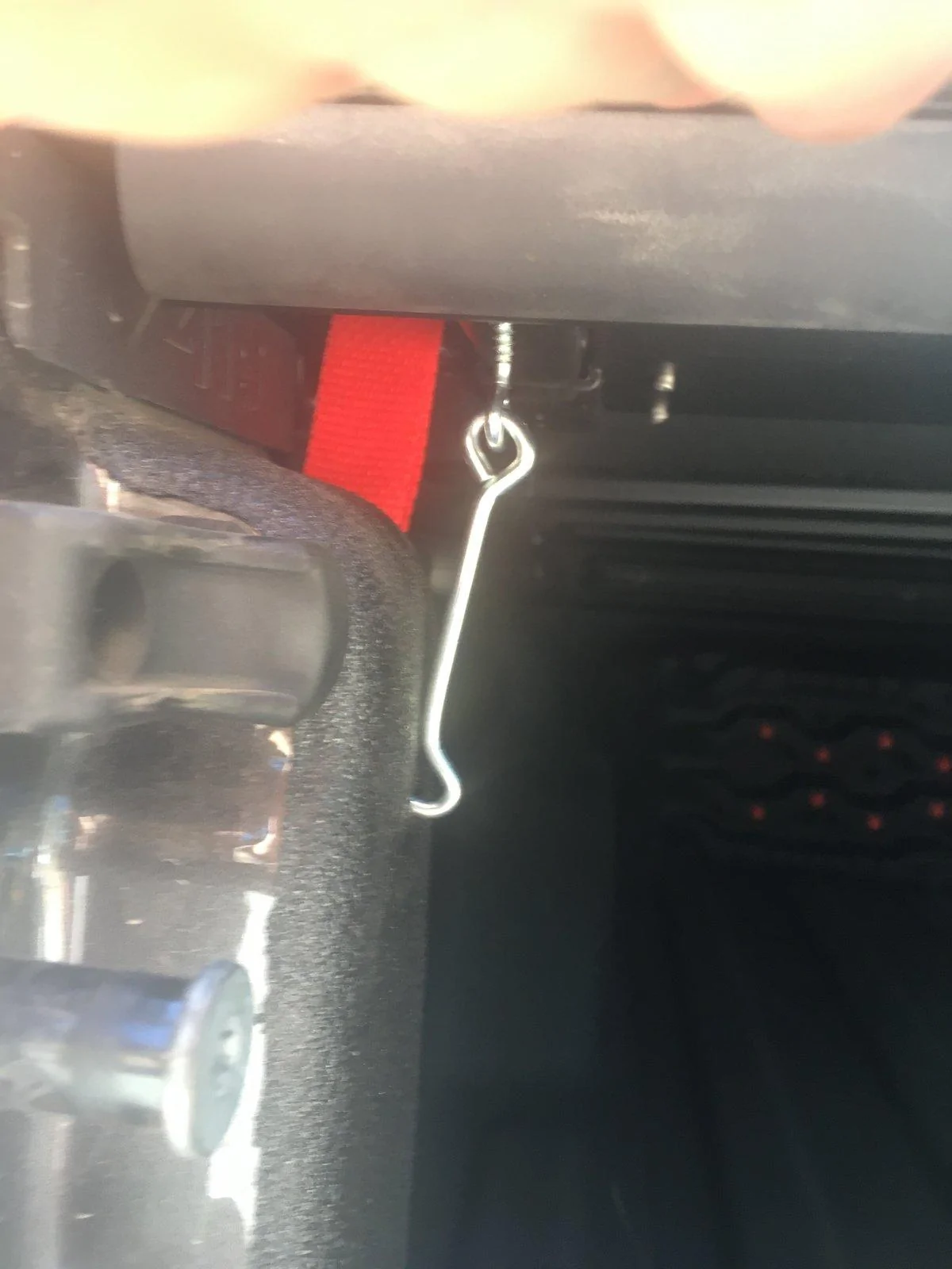

OK... finally got to try my theoretical fix for the “weekend warrior” flip up end of the tonneau cover!
3” steel gate hooks, screwed into tonneau brace bar, directly above factory hole in tailgate pillar. Tighten or loosen gate hook screw to adjust tension on hooks. They lock in super tight... can’t even lift tonneau edge with tailgate down! With tailgate closed, tonneau is completely locked! Thief will cut tonneau long before breaking lid open! Box of 2 gate hooks $1.98! Paint ‘em black and they disappear! (Drill hole in brace slightly smaller than gate hook’s eye screw, it self taps in tightly. I bought plastic lined stop nuts for pointed tips, but didn’t use ‘em cuz they end up recessed in brace channel!)

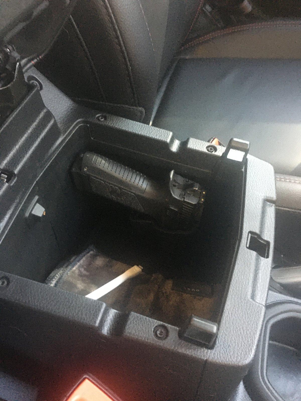

Also mounted plastic CC self locking holster in center console for 9mm CZ Po7... Gun snaps in and out. So I can lock it in console when entering Post Office, or other no-Gun facility.
(New Mexico has liberal open carry... and Castle law extends to vehicle, so we can carry loaded in truck!) ;{

I like your tonneau cover lock. Does it interfere with rolling up the cover? Would it be easier to thread the eyelet to the side of the bar on the last 6" so the hook would lie next to the bar? I pulled my tonneau cover off when I put the cross bars on, but may re-install in the future if I can lock it.

I placed ‘em where I could get the most purchase on the tailgate pillar... wasn’t sure how solid they’d be! (Turns out... super solid!) They lie flat against the brace when rolled up... no problem. But you could place them any way you want I reckon, as long as they easily insert into factory hole. This way (in photo) you can screw it in or out, to adjust tension. A little tension on the hooks keeps them locked in tightly! ;{

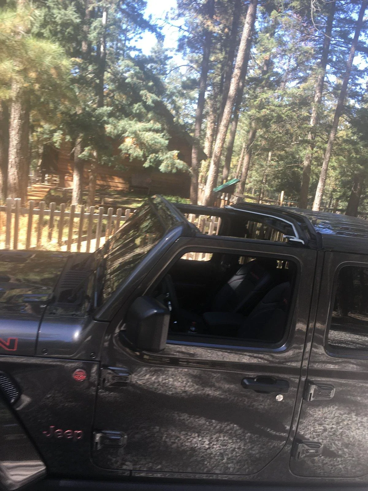

Ya know what it feels like to sit on a rock, in the warm sun, in the Pine Forest, in the Mountains, on a brisk fall morning... it feels like RECHARGING! Like a phone in a charging dock! Warm, tingling, electric, energy, flows onto, into, and all through, your body... surging Spirit, Wellness, Energy, and overall Zest for Life! My own private, wilderness, Charging-Dock! Feels just like I did, yesterday, cruising through the Wilds with my top off!
...Big Buck’s top! My JT’s top! Cruising in my Gladiator! Not my top! Sheeesh! (Well, I reckon we could BOTH cruise topless!) :turkey:

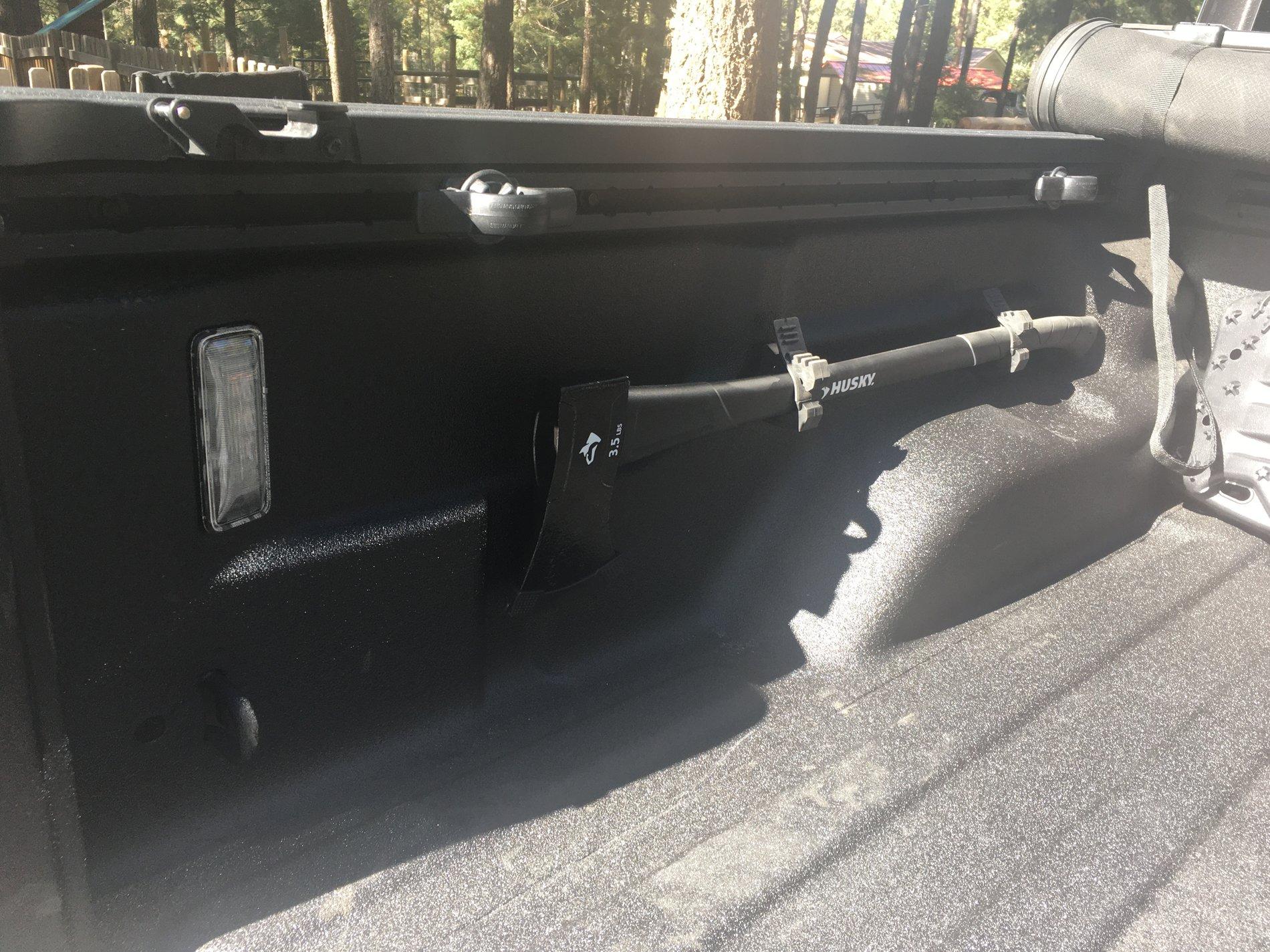

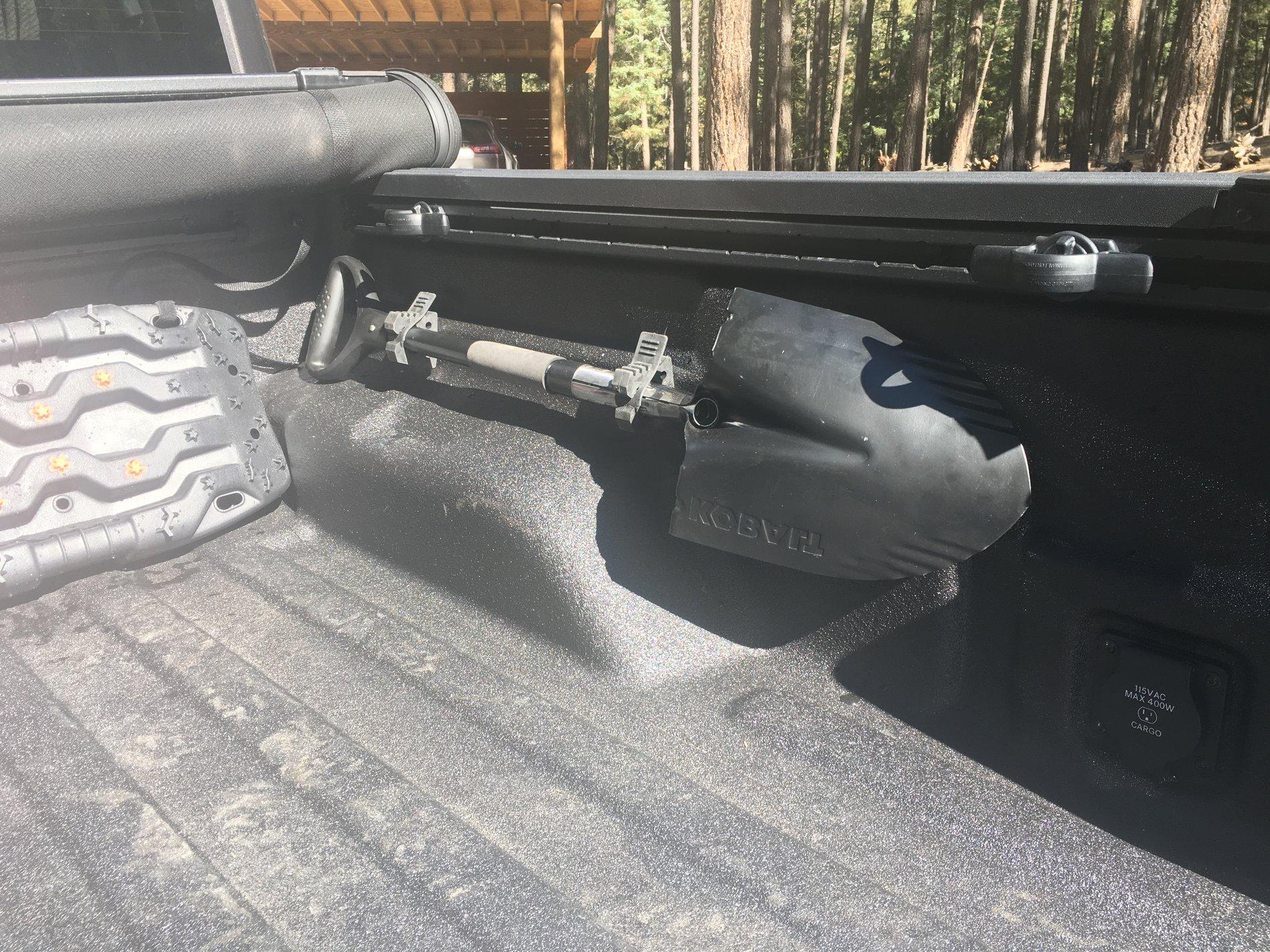

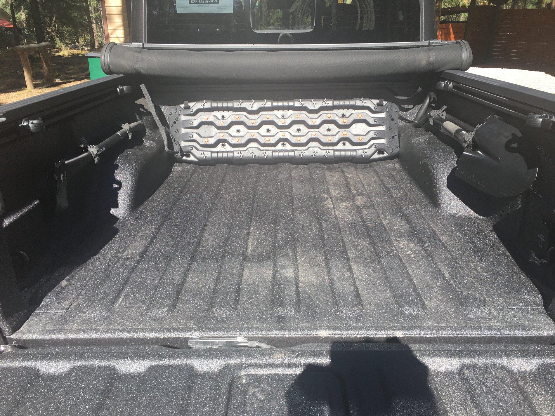

Got my axe, shovel, and maxtrax, mounted in bed today! ;{

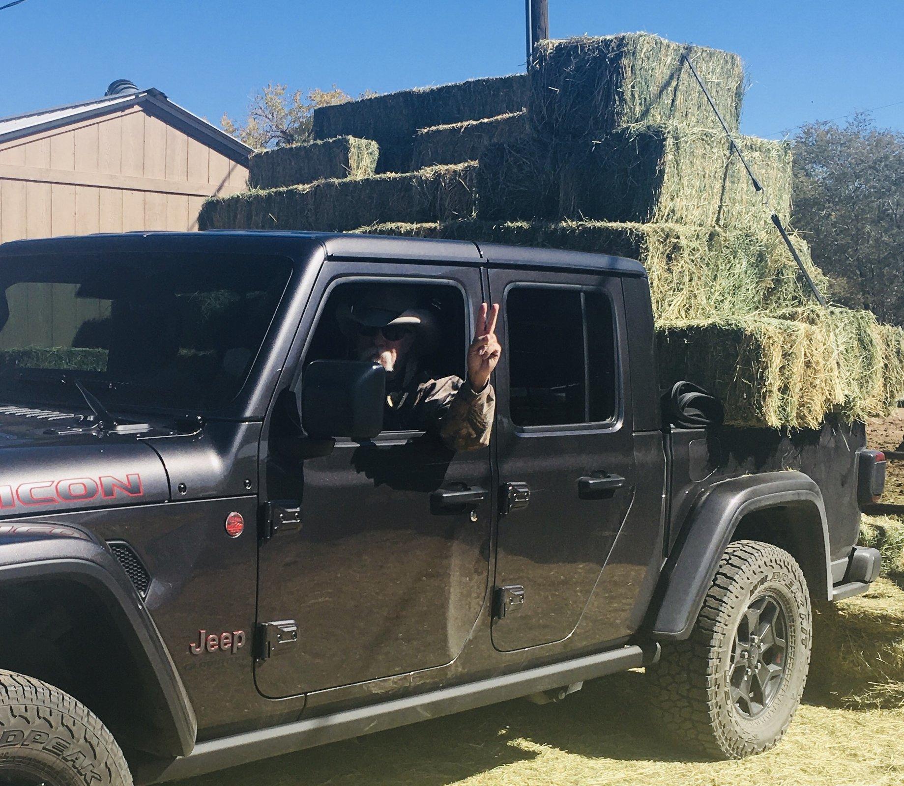

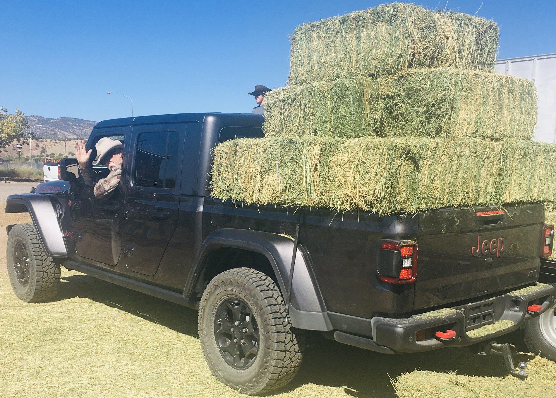

Haulin’ hay... backin’ up to load one more bale on top... one more makes 15... could easily haul 20, 25! :turkey:;{
