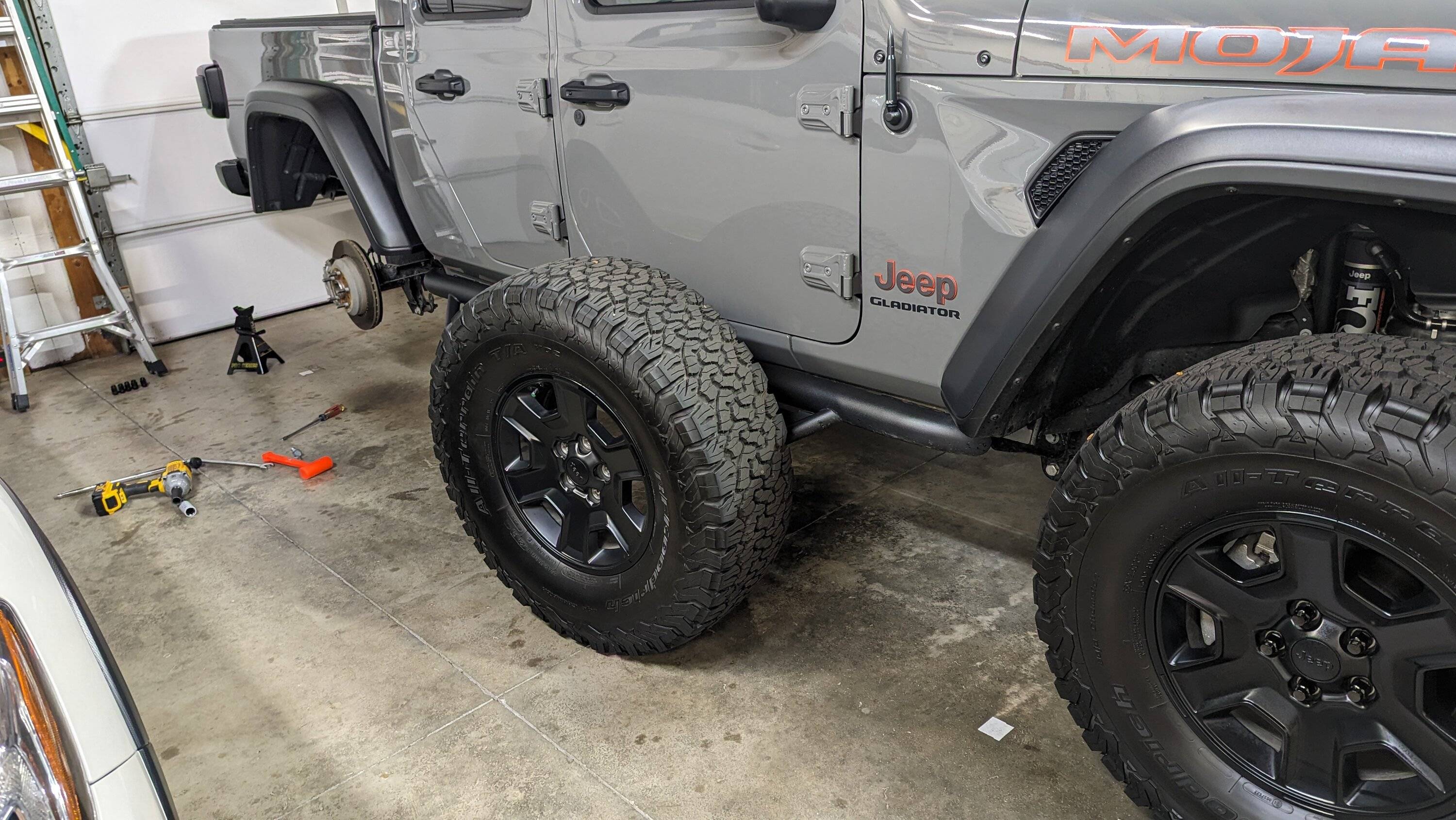

I will note that when I removed the lower mount bolts they were definitely NOT torqued to the spec of 89 ft lbs.
Felt more like 45
The AEV lift was installed by the original owner, so I guess I should have checked it. Can't blame Toledo for that one.

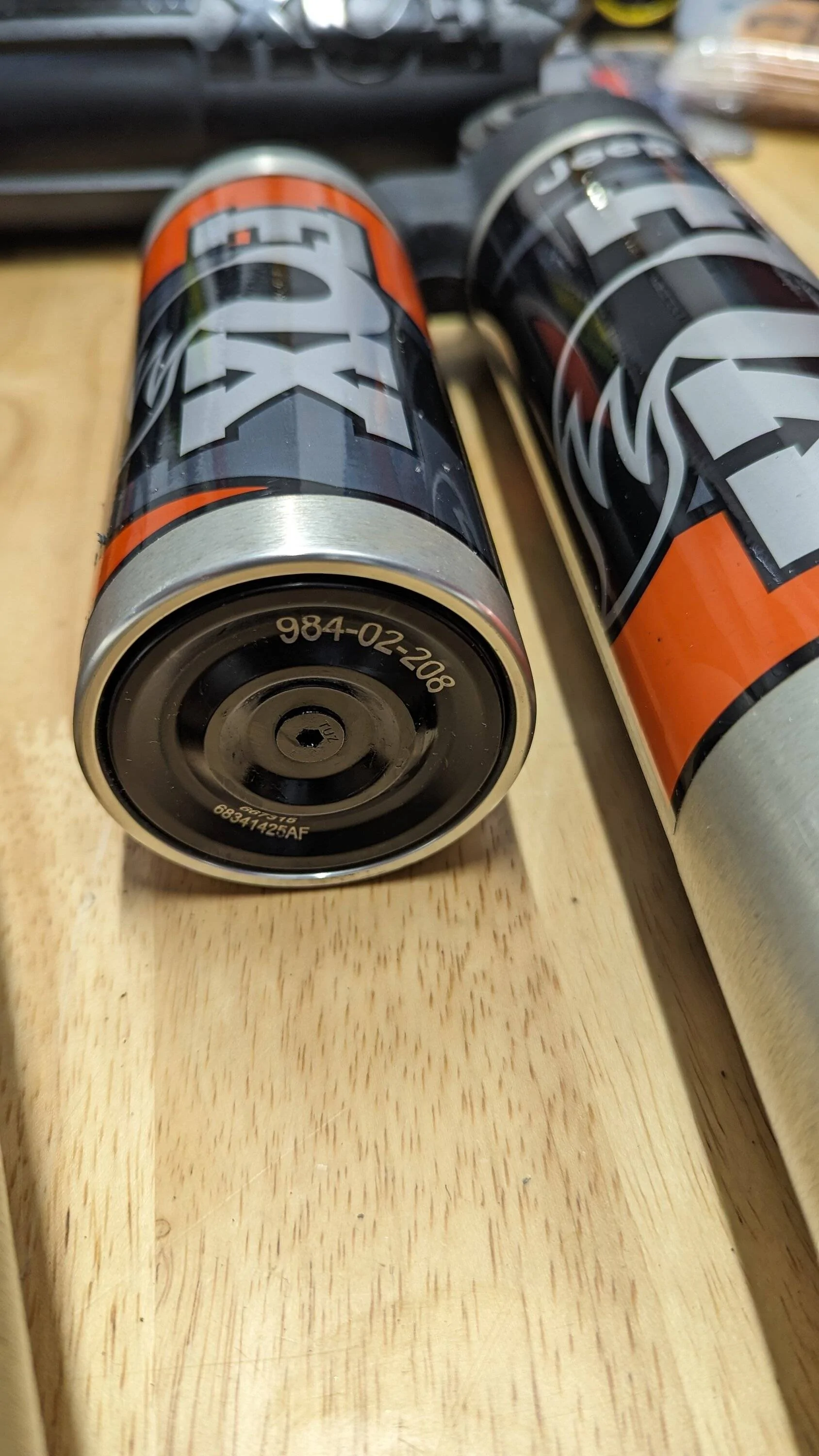

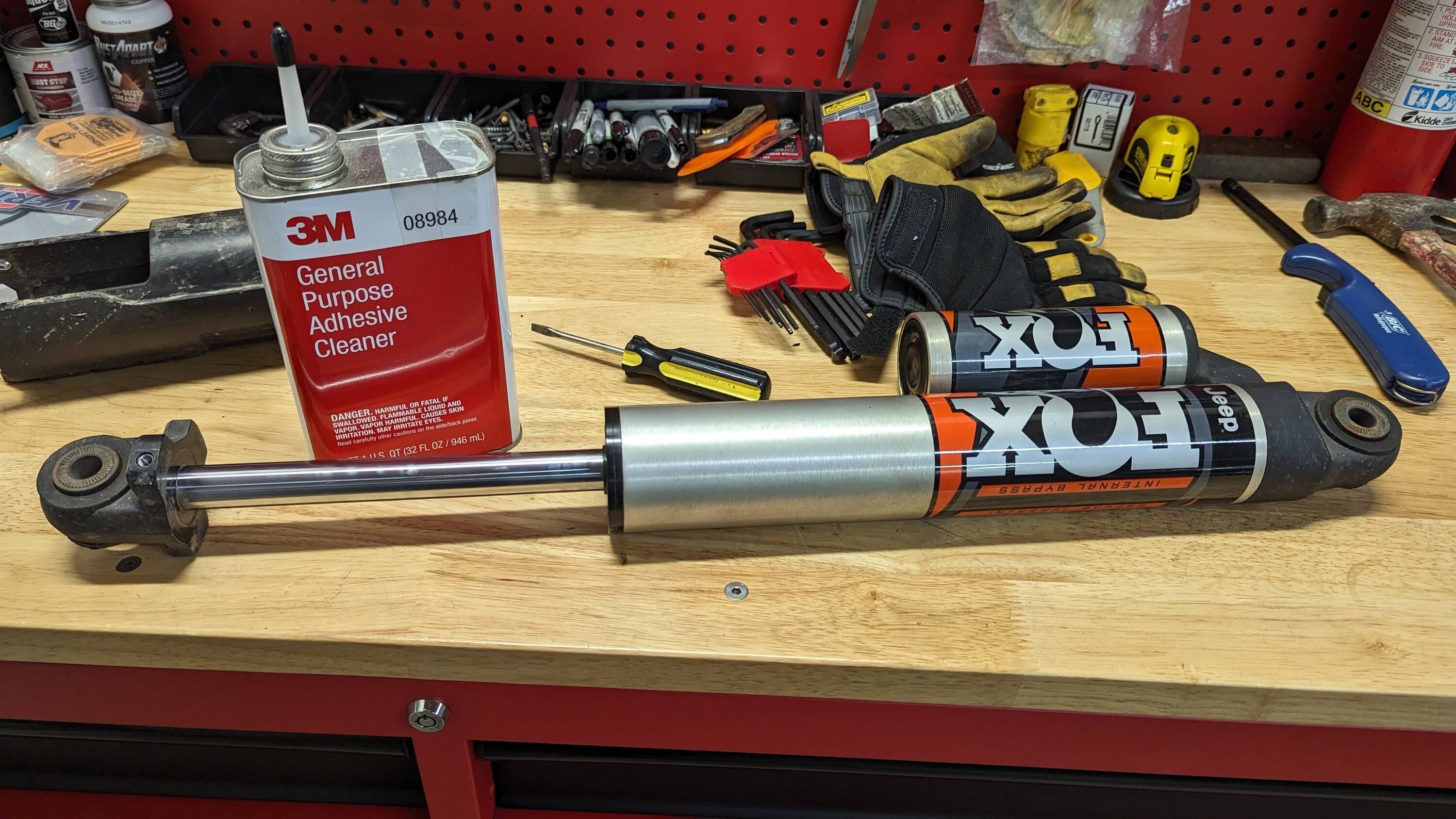

Removed both shocks and thoroughly cleaned everything. Note: the 3M adhesive cleaner will absolutely wipe the barcode sticker clean. Oh well. I was more cautious on the second one. This cleaner is very handy to have around by the way.​

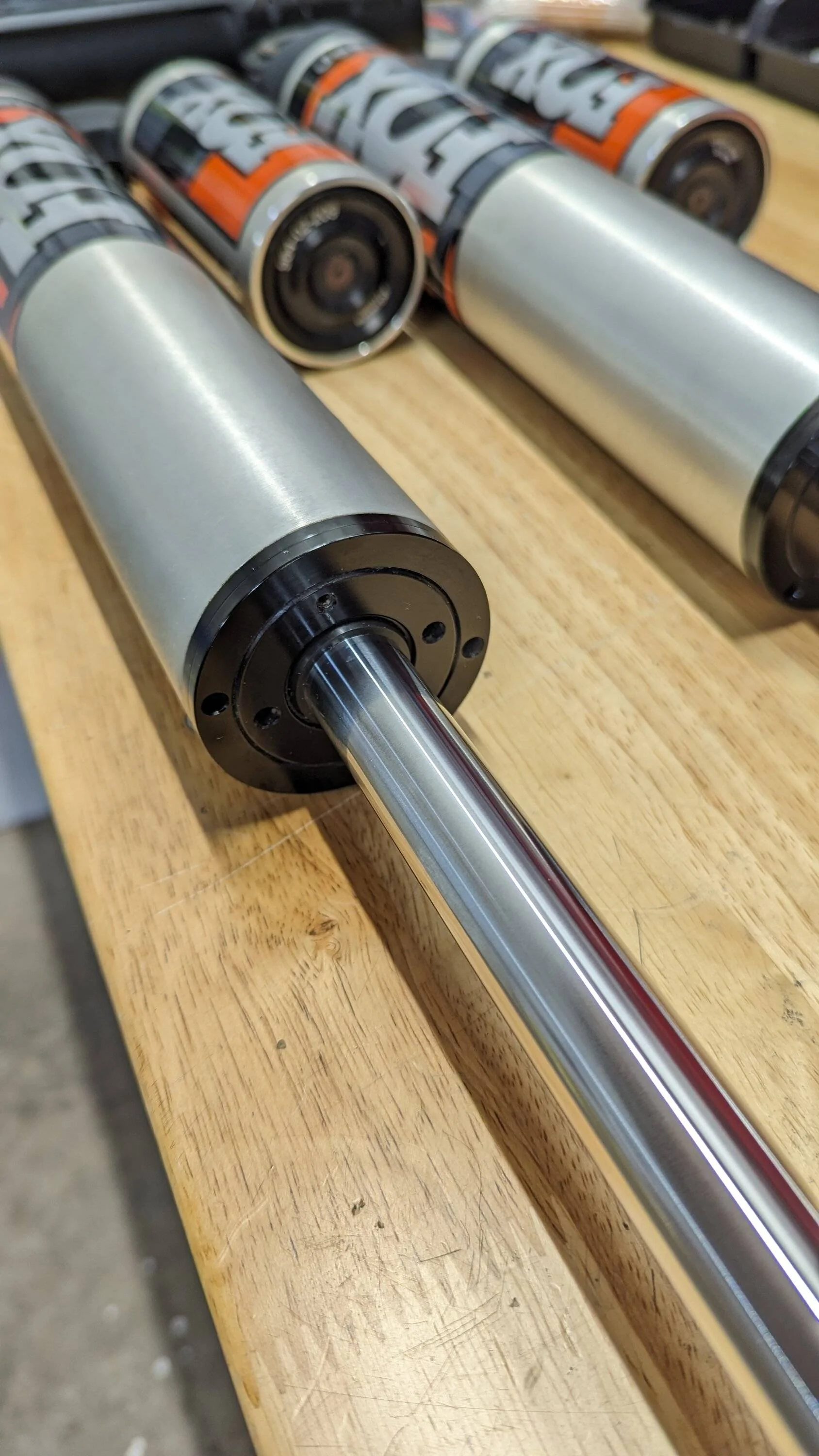

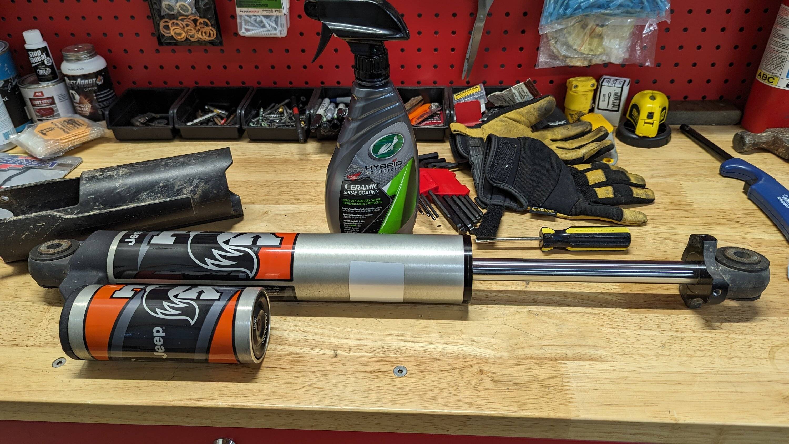

Applied the Hybrid Solutions to to the shafts and cycled the shocks about a dozen times. Applied some more and let it set and then polished to a shine.​
