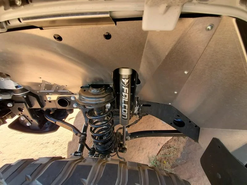

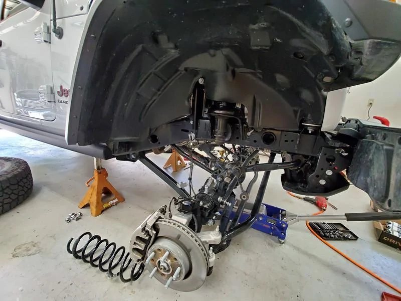

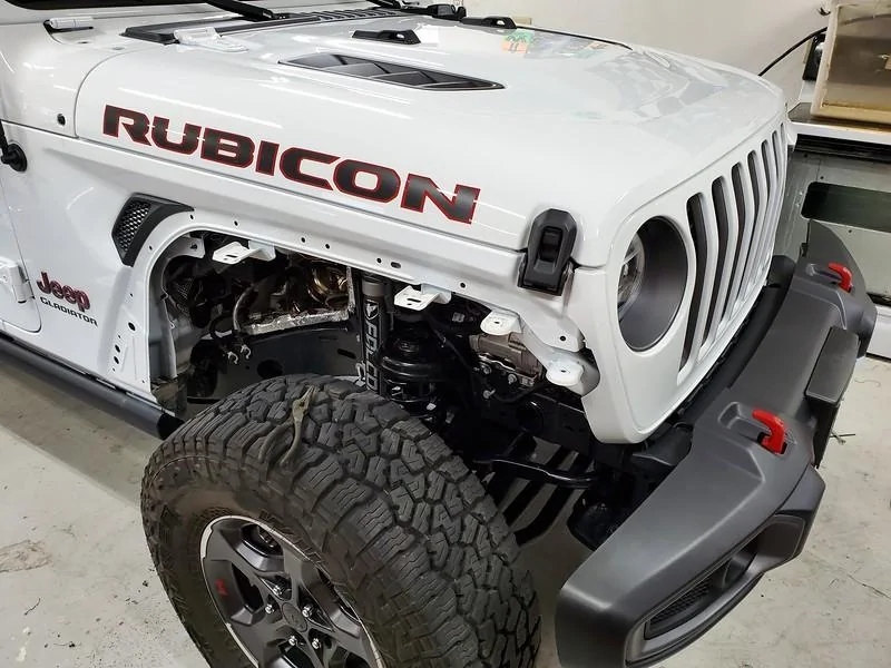

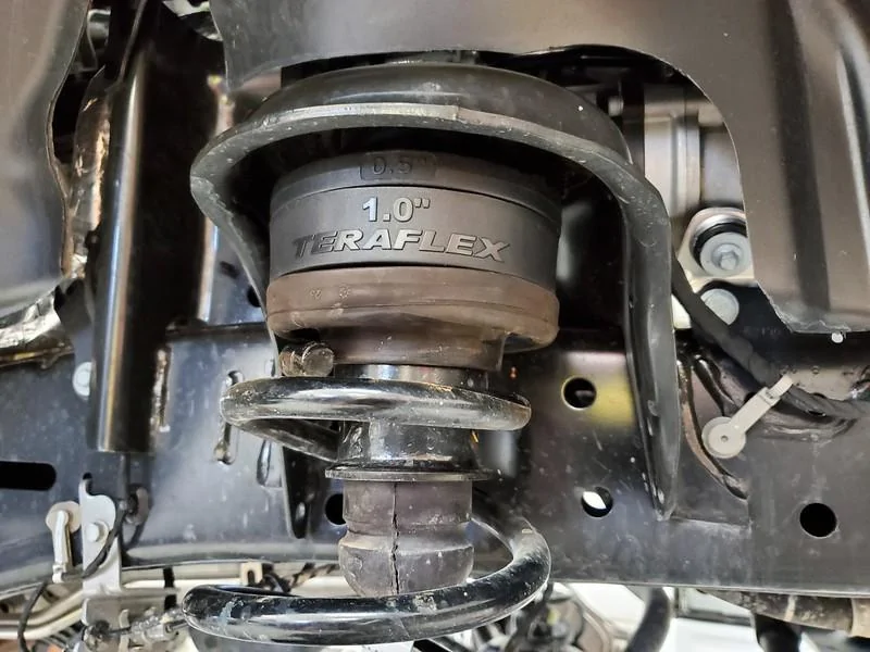

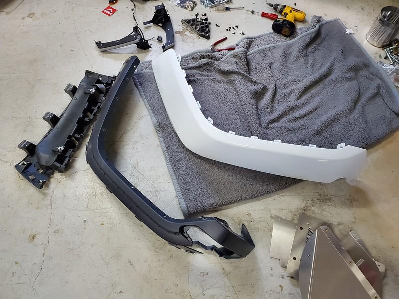

Well, onto Stage 2 of the build! Here's what it took;
  1. Teraflex 1.5" spacer leveling kit
  2. Daystar 3/4" rear spacer
  3. Falcon 2.1 monotube shocks
  4. American Adventure Labs Highline Brace & DRL's
  5. American Adventure Labs Quick Release Front Inner fenders
  6. AEV Salta JK-spec wheels, powder coated with Illusion Cherry
  7. BFGoodrich KM3 tires
I did the lift, shocks and AAL parts over 2 days. None of it was too difficult, just took some time. To install the leveling kit and spring spacer, I had to get the weight off the springs, remove the fronts and then slide the spacers in place. Getting the shocks on was simple, nothing difficult about them. The AAL fender parts were more involved, they required removing the front fenders and stripping out the plastic inner fender liners and bolting the new aluminum inner fenders.

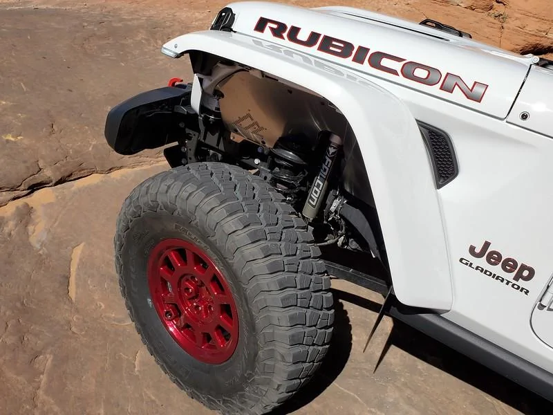

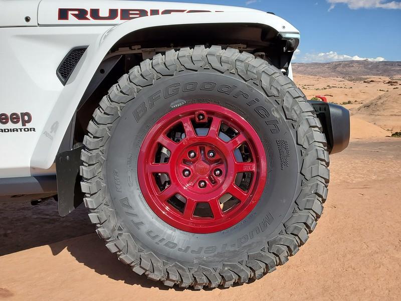

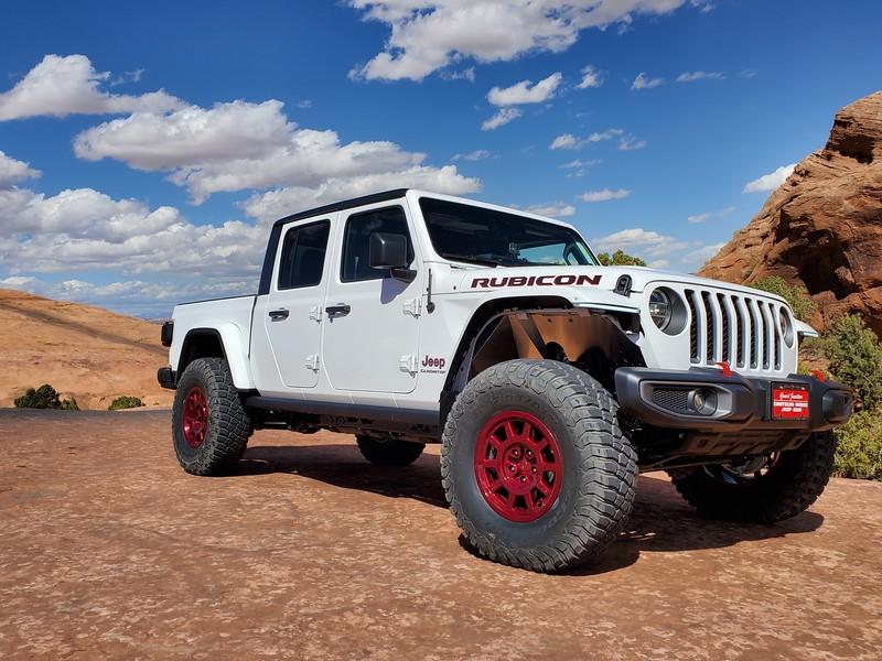

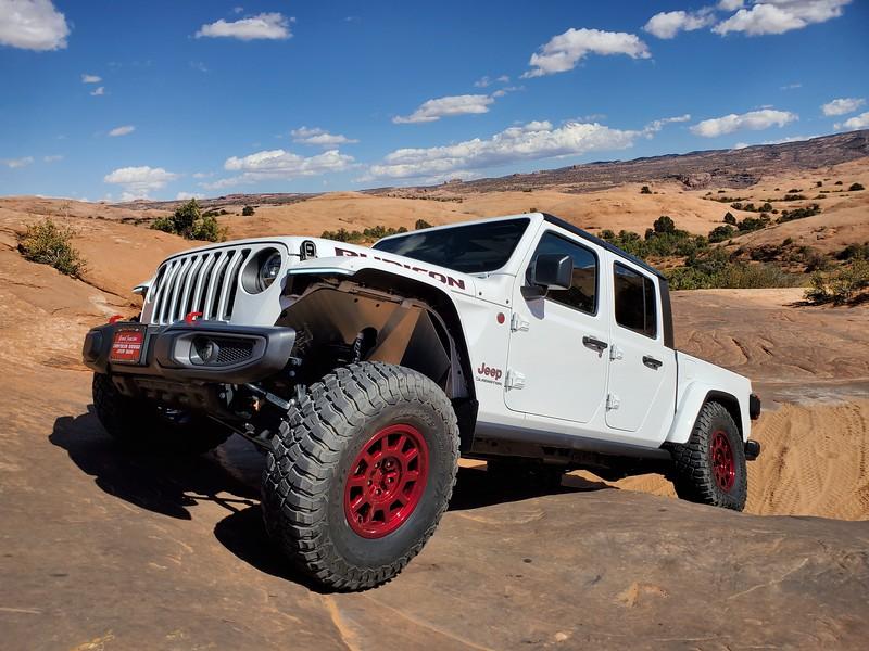

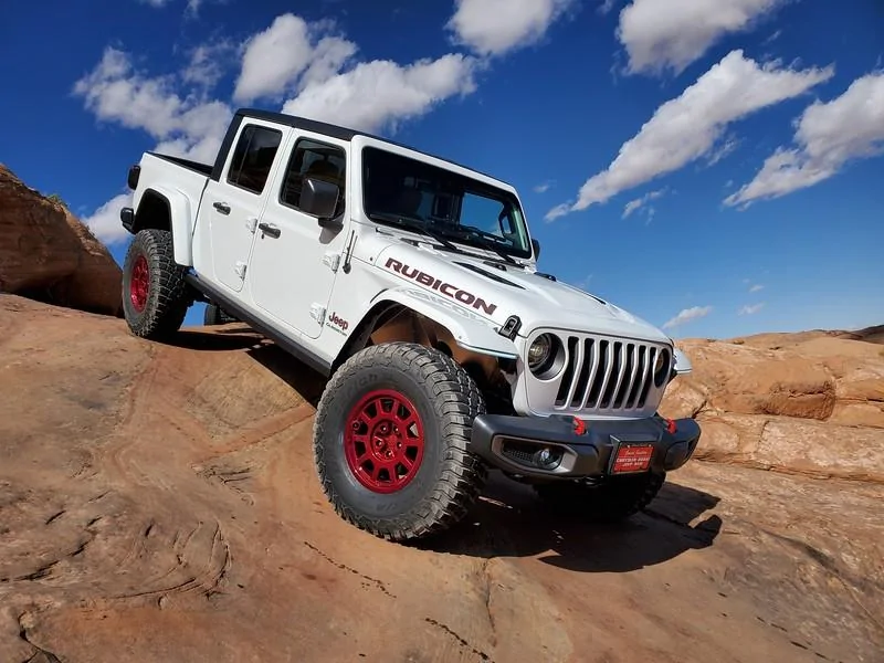

Time for the reveal of the Stage 2 mods!
I was able to get to Moab for a quick trail test, heading to Hells Revenge. I'm very pleased with the outcome of Stage 2, I gained much needed ground clearance, better approach, breakover and departure angle. I was able to check the tire clearance, bumpstop height and shock travel and it all looked good. The Gladiator worked great, I scraped the rear hitch several times, but that's to be expected. I was pretty happy with the wheel travel, considering I'm still running stock springs & control arms.
It took a MONTH to get the wheels back from the powdercoater! The color is pretty awesome, it takes on all kinds of different shades depending on the light. The 37" BFG KM3's look perfect with the amount of lift, wheelbase and they work great offroad and on. The Falcon 2.1's are a huge improvement over the factory Fox 2.0's, the Gladiator feels much more sure-footed on bumpy roads and the rough trails. It's obvious that they dampening makes a big, needed change. The 37's don't rub at all and the bumpstops all seem to be set right, which is amazing considering the low lift height! I feel like the Stage 2 mods all work together very well!
