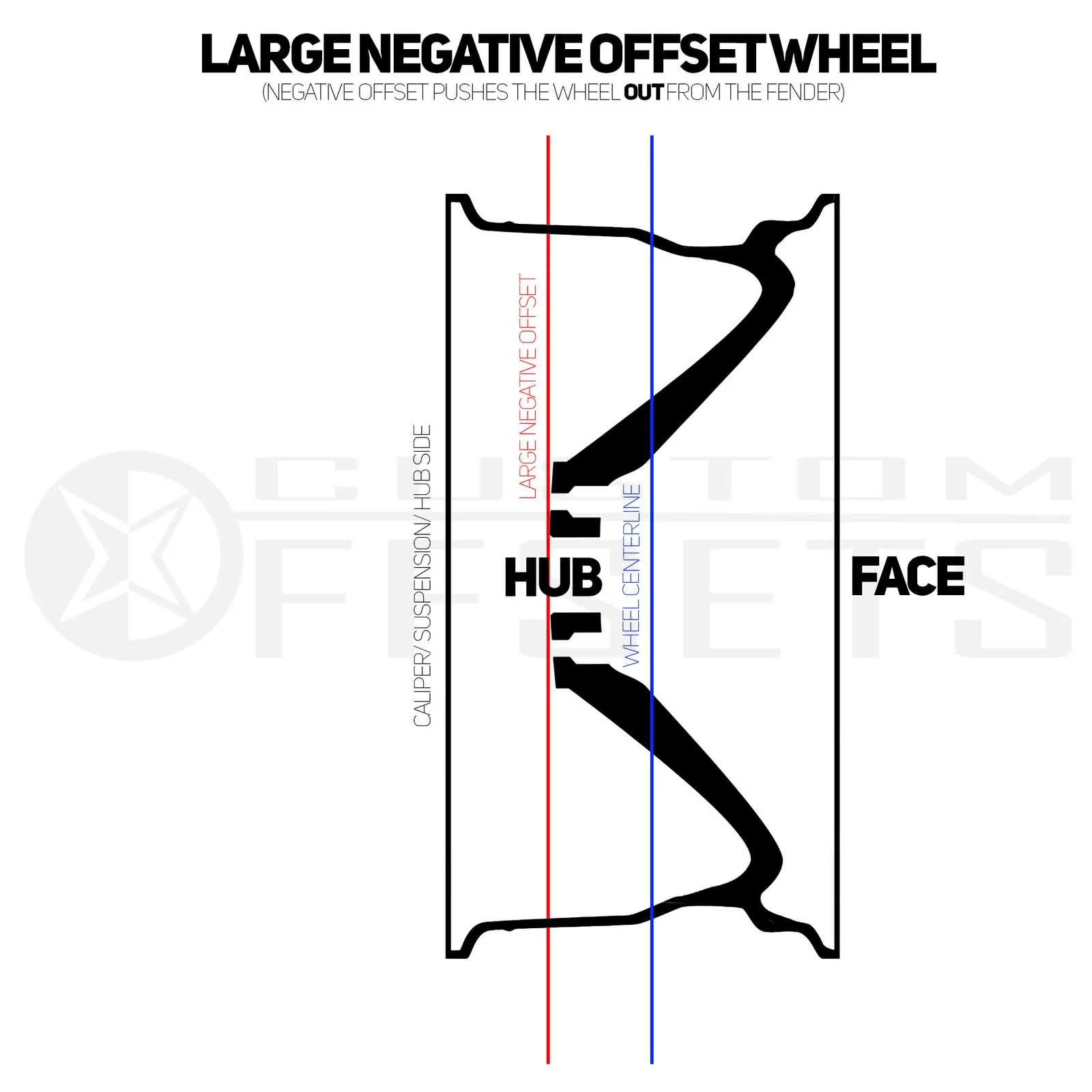

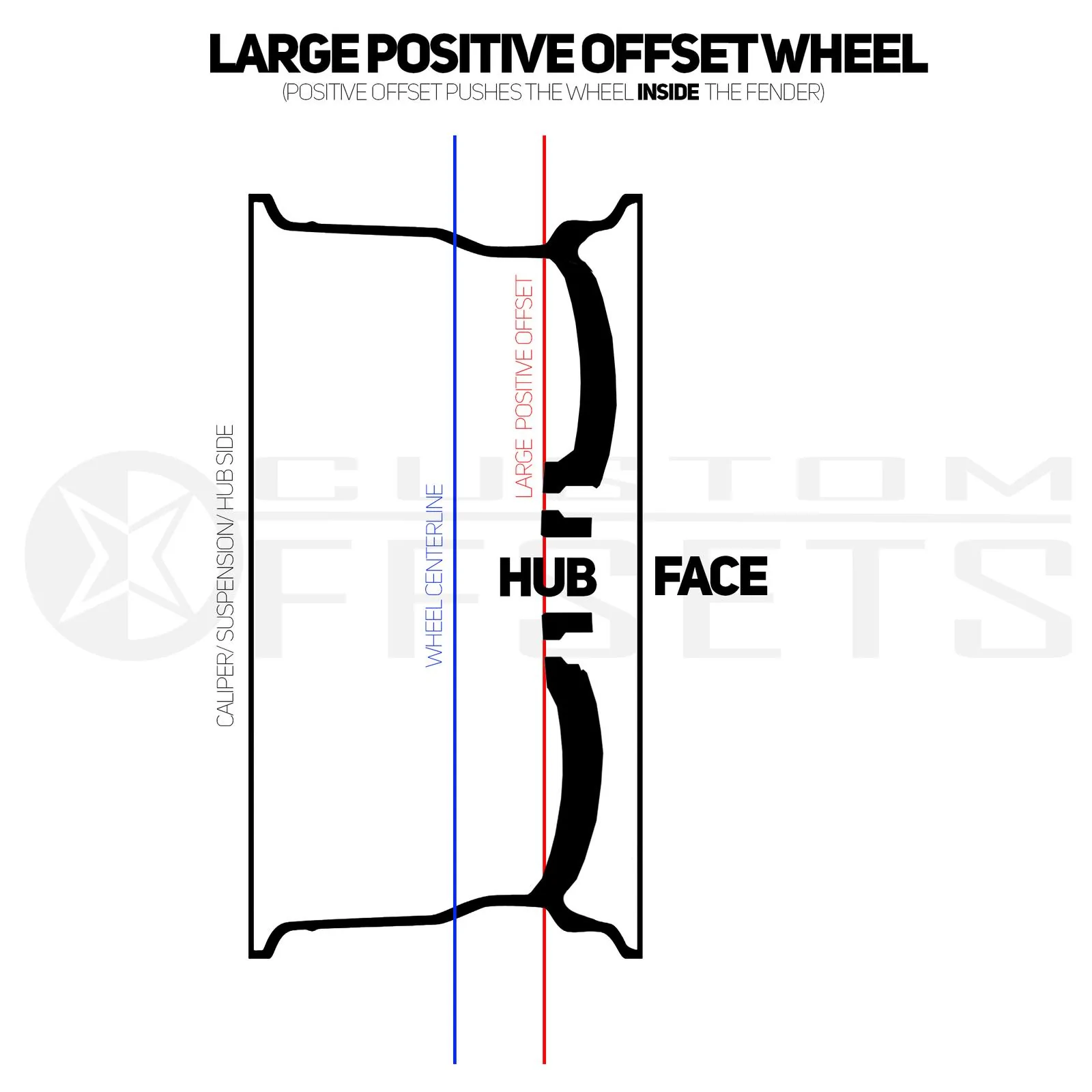

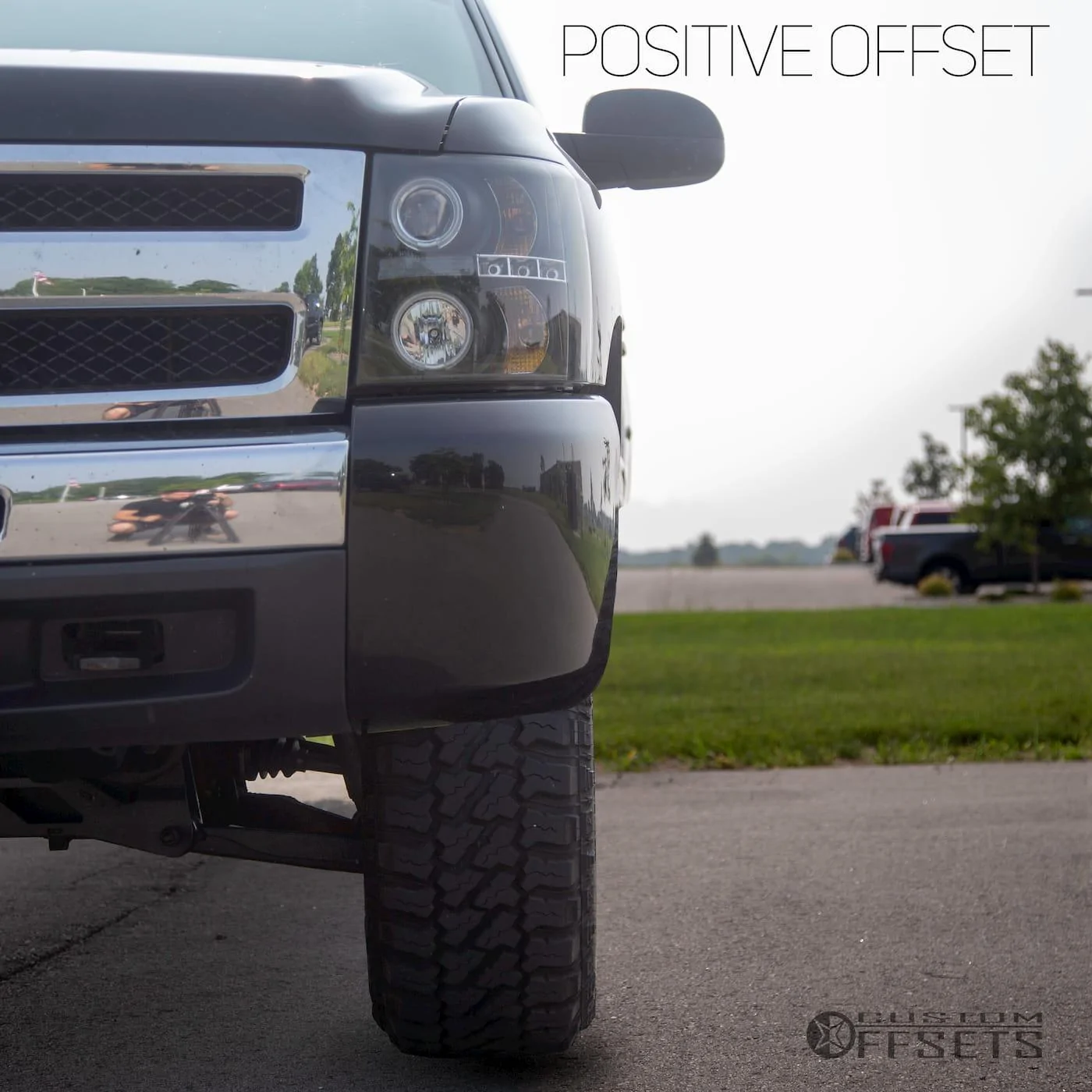

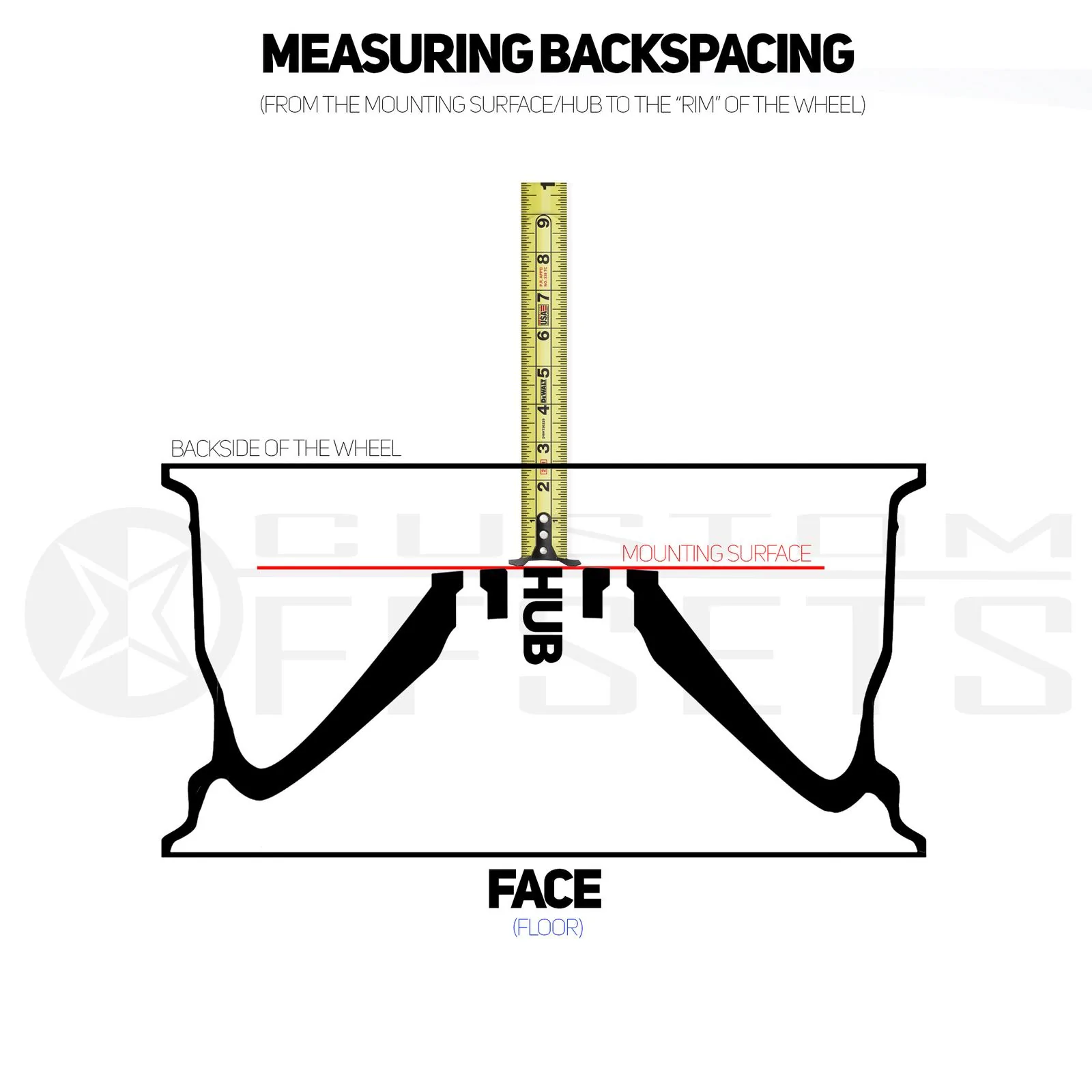

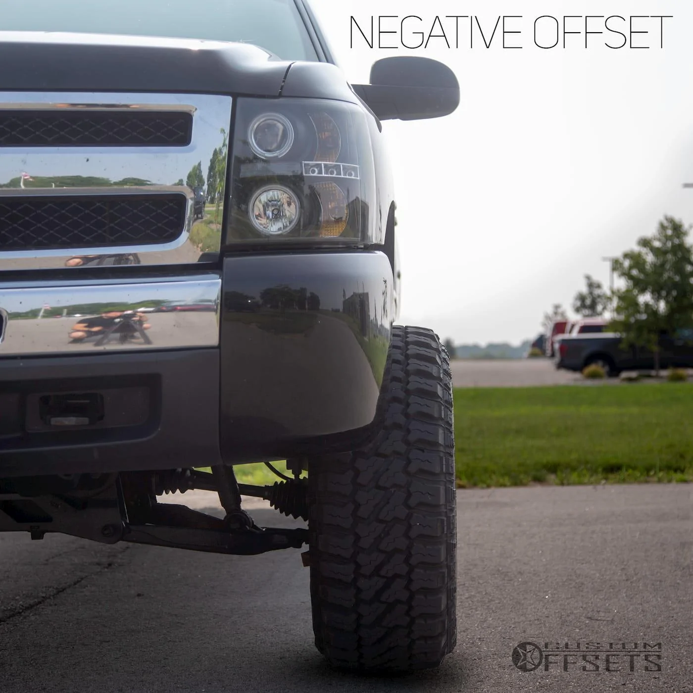

I’m a little bit of a novice on aftermarket wheels. The Salta’s have an offset of +10MM and backspacing of 5.2”. How does this compare to the Rubicon wheels? I’m trying to understand how far the tire will stick out (ie: roller skate). The Savagre II are specifically made for the JL (Salta is a JK wheel) and have offset of +25MM and backspacing of 5.77”. How does that compare?
The difference between the two wheels you mention is this:
Savagre II has backspacing of 5.77"
Salta has backspacing of 5.2"
The difference between the two wheels is 0.57" (just over a ½")
This may be helpful...
Backspacing is similar to offset, but it changes where we measure from. We are still looking for the distance from the mounting surface of the wheel, but instead of measuring the “center line”, it’s measured from the back edge of the mounting surface (hub). Backspacing is less commonly used than offset, because offset has replaced backspace measuring in common wheel fitment.
Reference:
So there’s wheel diameter, wheel width, and a “positive” or “negative” offset. What is offset? Offset is the distance in millimeters (mm) + or - from the hub (where you bolt the wheel to the vehicle) to the true center of the wheel.
A “negative” offset is where the mounting surface of the wheel is closer to the inside (brake side) of the wheel. In the truck world, many custom truck wheels come in aggressive negative offsets. The more negative the offset, the more aggressive stance you will get. This means the wheels will “poke” outside of the fenders. “Poke” or “Stance” is when the wheel and tire stick outside of your fender. A negative offset is what can create a larger lip or concave style, which will push the tire out.
A “positive” offset is where the mounting surface of the wheel is closer to the outside (fender side) of the wheel. This pushes the wheel in toward the brakes which can “sink” the tire and wheel into the fender well opening.
Jeep Gladiator The RME4x4 Gladiator Rubicon positive-offset
Jeep Gladiator The RME4x4 Gladiator Rubicon negative-offset

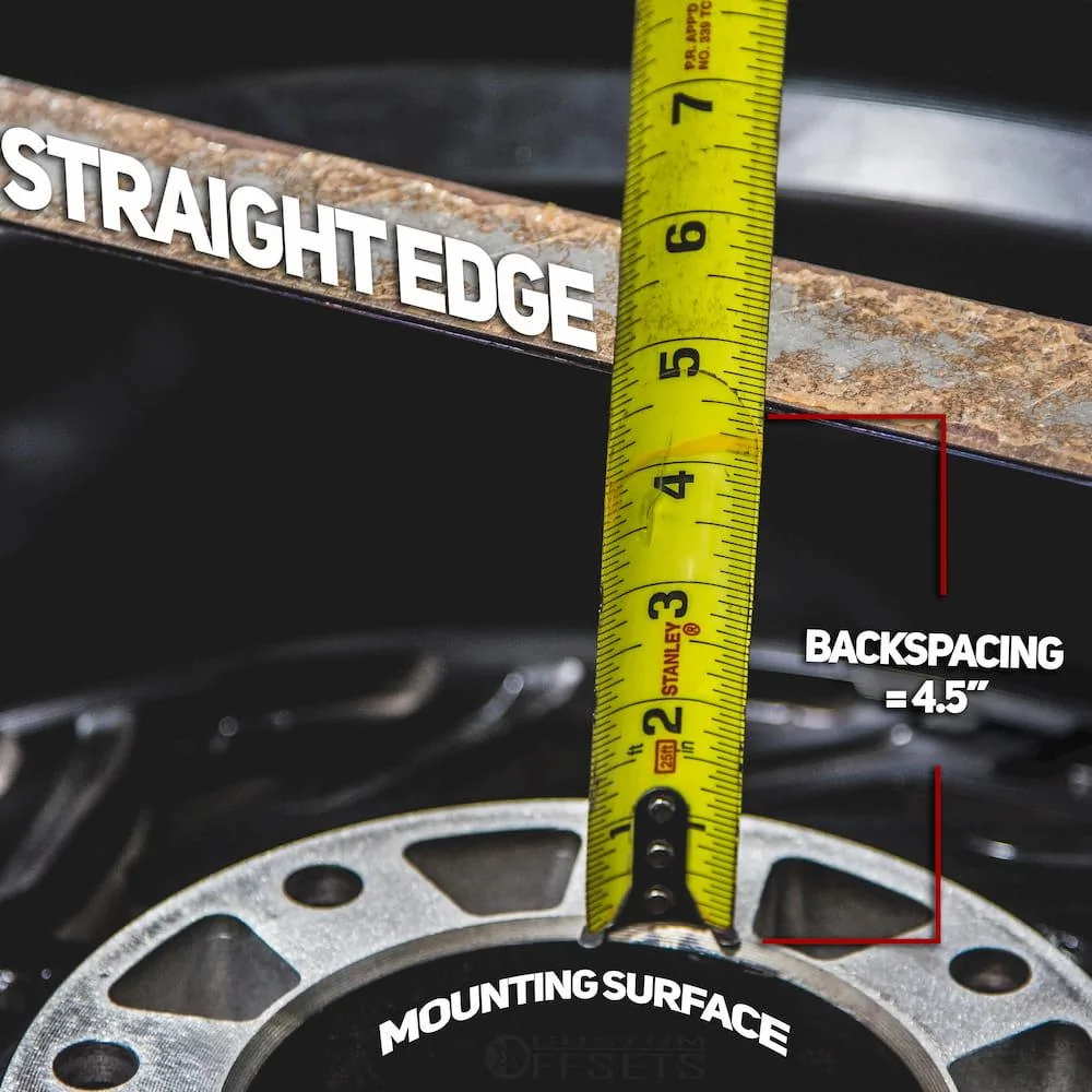

BACKSPACING
Does backspacing matter? Backspacing is similar to offset, but it changes where we measure from. We are still looking for the distance from the mounting surface of the wheel, but instead of measuring the “center line”, it’s measured from the back edge of the mounting surface (hub). Backspacing is less commonly used than offset, because offset has replaced backspace measuring in common wheel fitment.
Jeep Gladiator The RME4x4 Gladiator Rubicon backspacing-lg
Jeep Gladiator The RME4x4 Gladiator Rubicon backspace-resized
