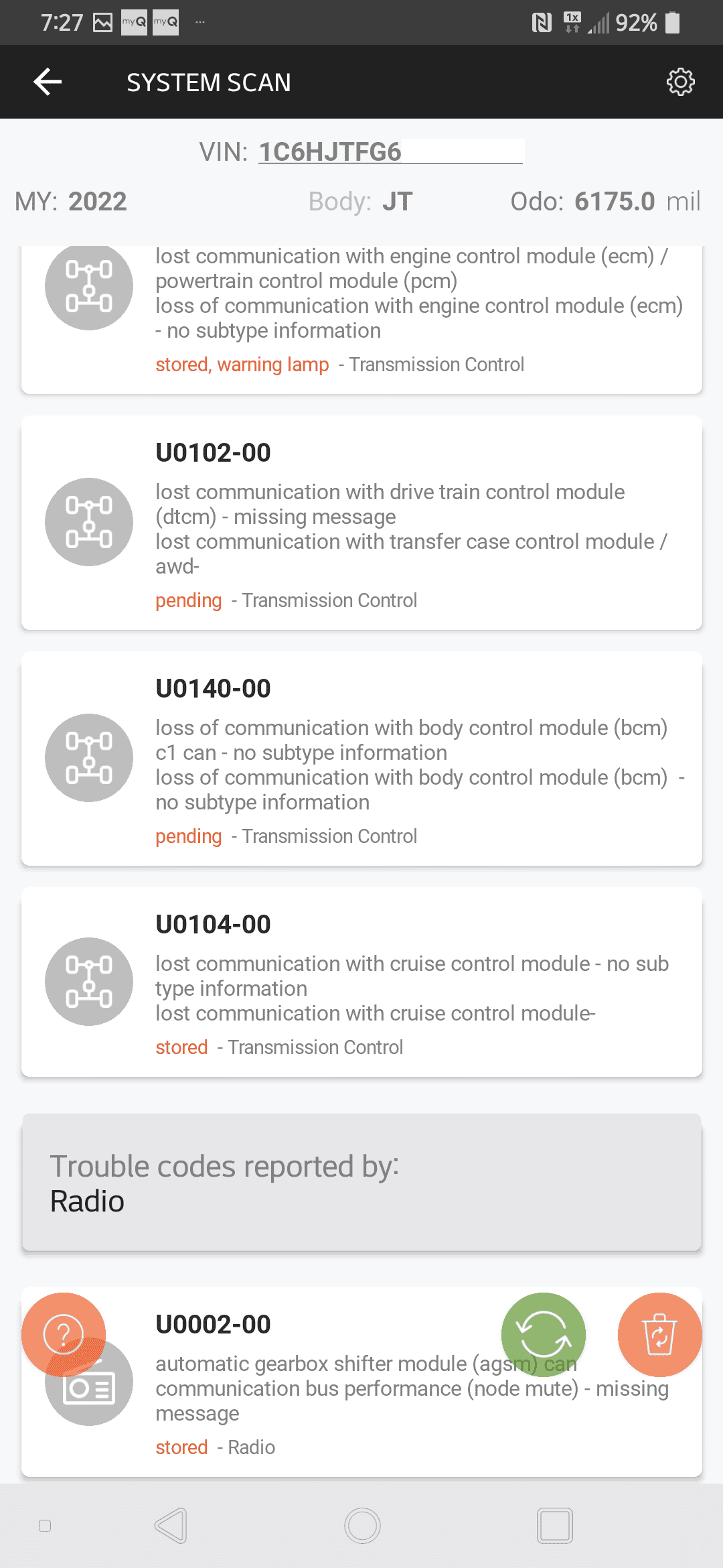

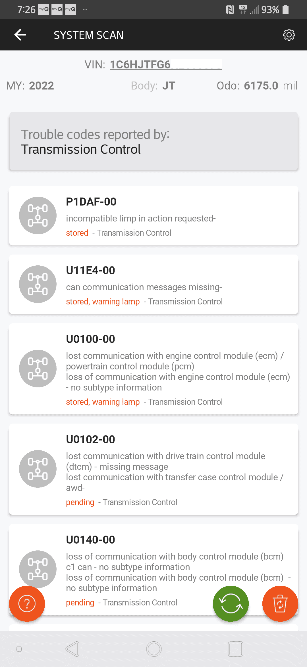

This diagram is for a JL but the connections are the same for the JT albeit in different physical locations.
The systems mentioned in the litany of trouble codes reference the transmission control module which feeds into connector XY313A in the diagram. Check this connector and ensure all connectors are clean and seated. Add dielectric grease while you’re in there. Next check the CSCIP star can connector and ensure all connections are good and add dielectric grease. The drivetrain control module feeds into this connection. Finally check the XY291A connector in the passenger fender well and add grease.

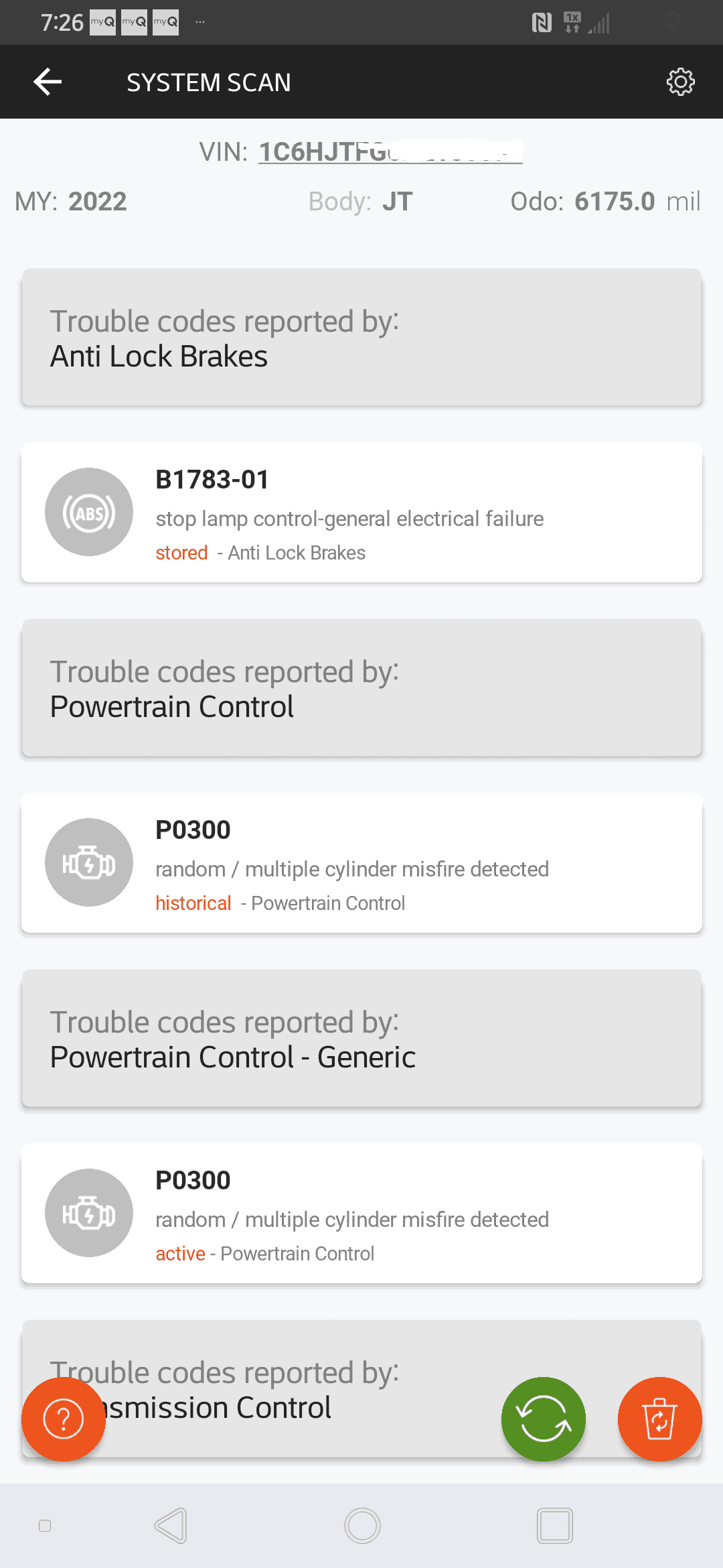

It's bloody cold out now (it's been nice and warm, so 19 feels worse than it really is) so as long as this thing is totally behaving - I likely won't touch anything. But if the issue comes back as far as the module communications, I'll dig further.
The MIL isn't on, there was no dinging and it did fine this AM so either they fixed it and didn't write it down, or, who knows.
I did find it interesting that the service writer said "that's taken care of" but it's not written down or recorded on anything - yet - I had a pile of error printouts on the passenger seat. I figured just in case there was a question I'd point them to those. When I got in the truck, they were laid up on the dash on the right side as if someone had been in the right seat. Did they move the papers so they could access the area back of the glove box? LOL - likely I'm just hoping and trying to find indications they did something there. But I see no reason for anyone to take stuff off the passenger seat for a CCDIF relearn alone. They don't even have to open the hood for that as far as I know.

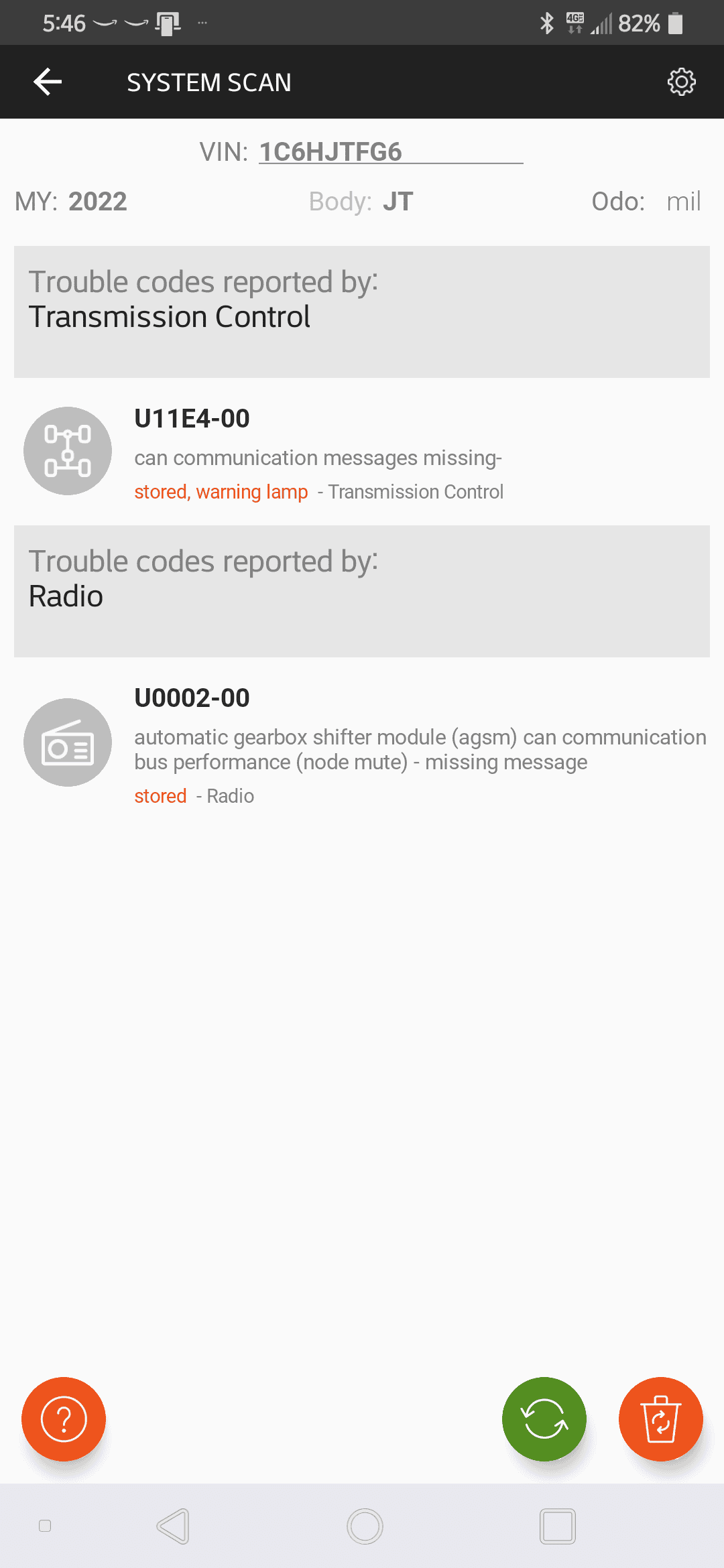

Everything fine again today. No CEL, no codes for communication......... that's not proof of anything really.....
But - I find it interesting that as my wife got in the truck tonight, she asked who moved the seat back and leaned the seat back back. I can't see why anyone would have moved the RIGHT seat or done anything at all with the right seat, or the papers that were in the right seat, unless they were accessing something over there on that side.
I'm still thinking they did more than just have the cam/crank relearn process take place. Isn't that done via connection to the OBD port.
