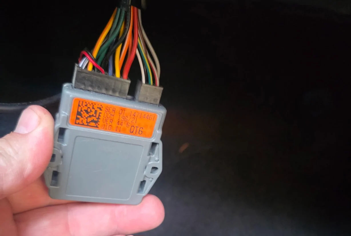

What is this, and why does it have a rocker switch running to it?

My buddy bought a 2021 Rubi diesel and found a rocker switch under his dash, and says its wired to this thing which was running to the BCM. We are trying to figure out what it might be for, any guesses? Gemini says either a SOTF tuner, locker bypass, or sway bar bypass. Nothing came up Googling the numbers.

Aftermarket immobilizer with valet switch.
Google image search to the rescue. :like:

Is this using the SGW connectors?
If so, I'd be more worried about getting my vehicle hacked over the cellular/XM connection than what the switch is for. I'd then unplug it as most thieves know what the SGW is for and where it's located.

Anyone scan the QR code to see where it takes you?

Dealer added on option that you paid them to track you 😂

I just purchased a 24 jeep compass for one of my grandsons last week, I noticed when they drove away with the car to their shop area to do some prepwork before taking it home, when they hit the brakes the brake lights flashed three times. No sooner than I asked the sales guy what the hell was that, he started pitching this new awesome feature that the dealership installs on all cars on their lot, and he says to me as he’s showing me the final pricing documents. He says it’s a security tracker and safety feature and only increases the bottom line an additional $600.00…and a small monthly service fee. My reply was, Remove now or I walk. He repeated himself three times on the great technology that it adds and the Value it adds to the Jeep. No less than three additional people on the lot, the Controller, the sale mgr and the service mgr all took a run at me to jump on this exciting new technology. After another 30 mins of bs from them, they had the service tech remove the device. Unbelievable. Stealerships, be aware!
