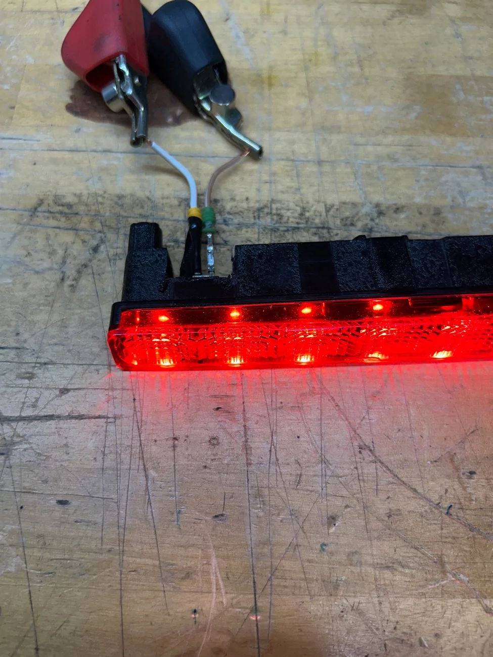

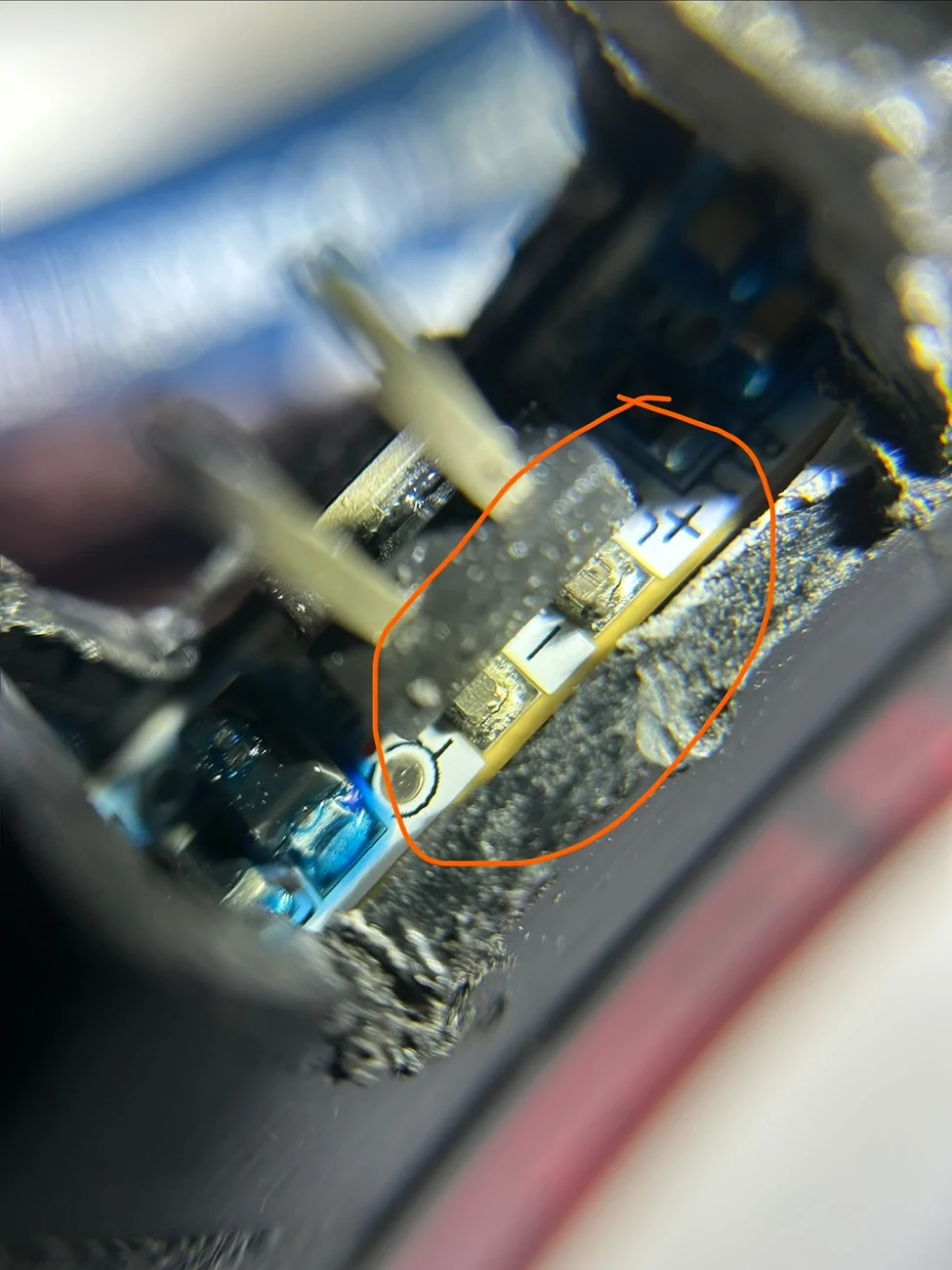

Have some free time and decided to cut it open to see why it failed. As expected, cracked cold solder joints on both positive/negative legs.
