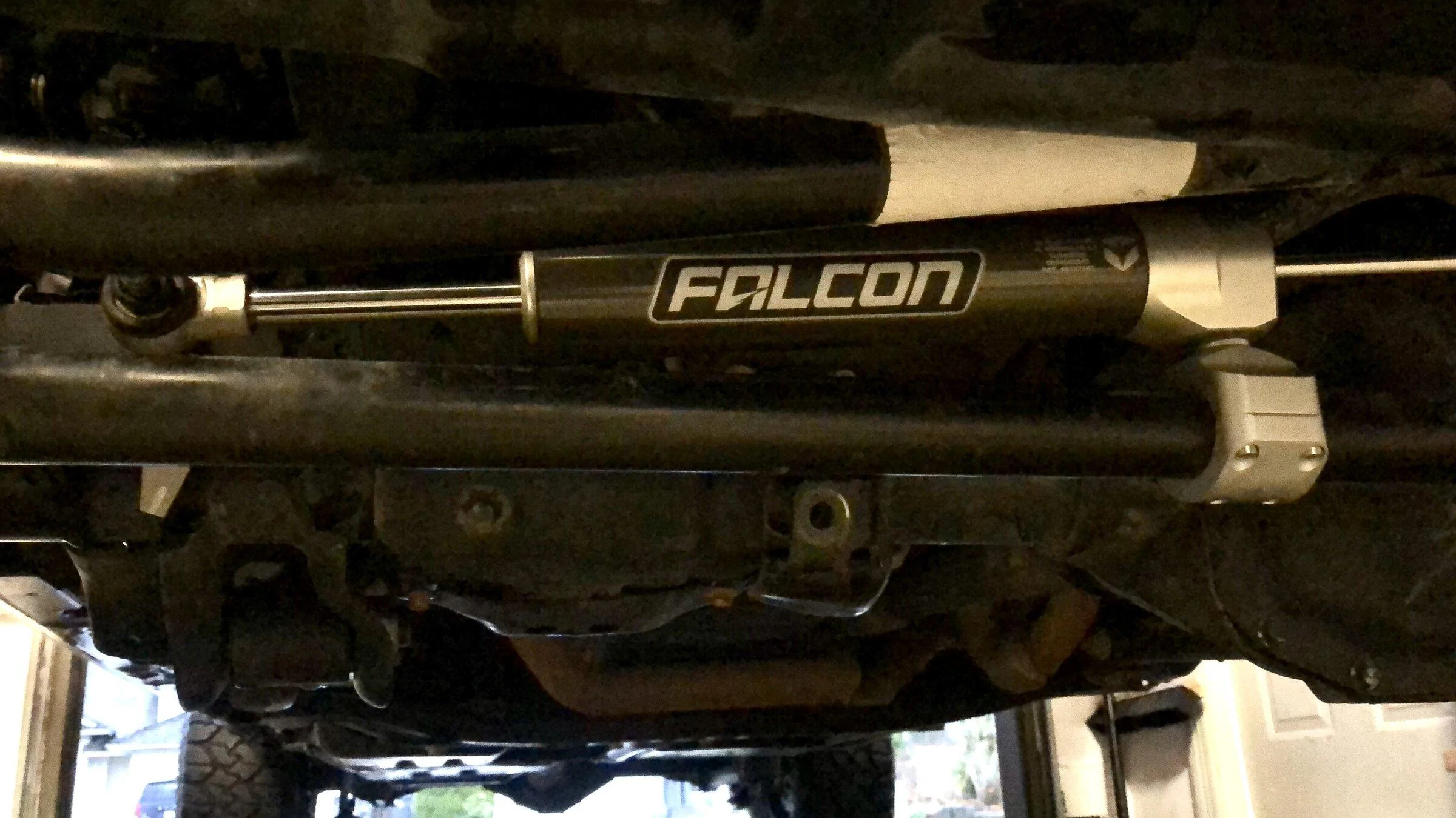

1.75" if you have the absolute BEASTLY Artec steering like I do... HAHA!
Jeep Gladiator Tie Rod Diameter/size 1638379276692
However... I do have my stock track bar still laying in the garage. I just went and threw a caliper on it and it came out to 1.58"... so I don't know which one of those clamps you would want to use. Maybe you could force the 1.5" to work.
Also, check out TMR for your clamp... SUPER nice part. Like, one of those parts you pull out of the box and are just impressed by the machine work.

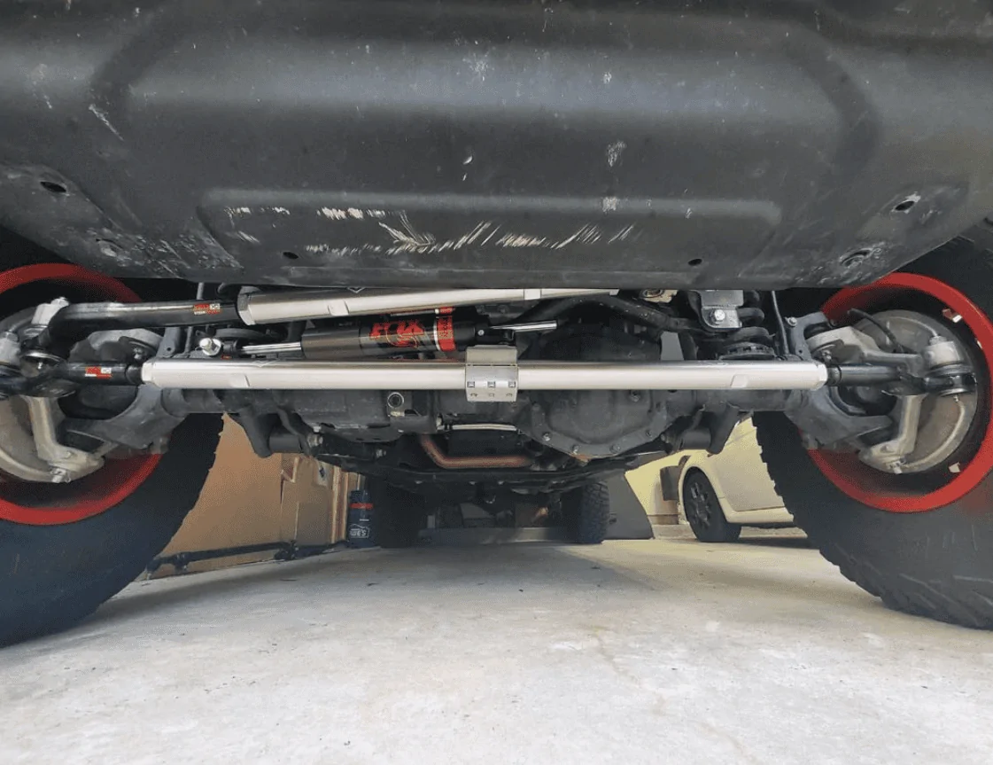

Just got the 1 5/8 teraflex relocation steering stabilizer bracket
fits perfect on my JT rubicon stock tie rod
