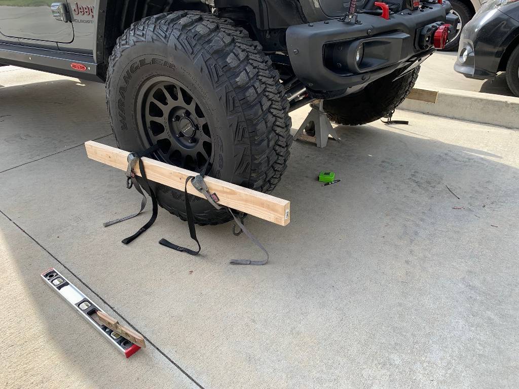

Here is a quick way... Get two long straight 2x4s and strap them tight to the tires. Make sure the 2x4s are level and get the tires off the ground. Measure front and back of the 2x4s to get the toe in you want. I like zero toe in. here is a pic. Note: it would be better if the 2x4s are closer to the center of the tire than what you see in the pic. I was pulling the tires on and off, so, that is why you see the 2x4s strapped too low.
