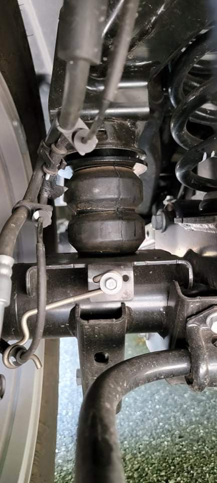

I was able to add the SES timbren on my 2021 Overland. Not sure what the issue is.
Jeep Gladiator Timbren SES requires spring removal received_1426354607748492

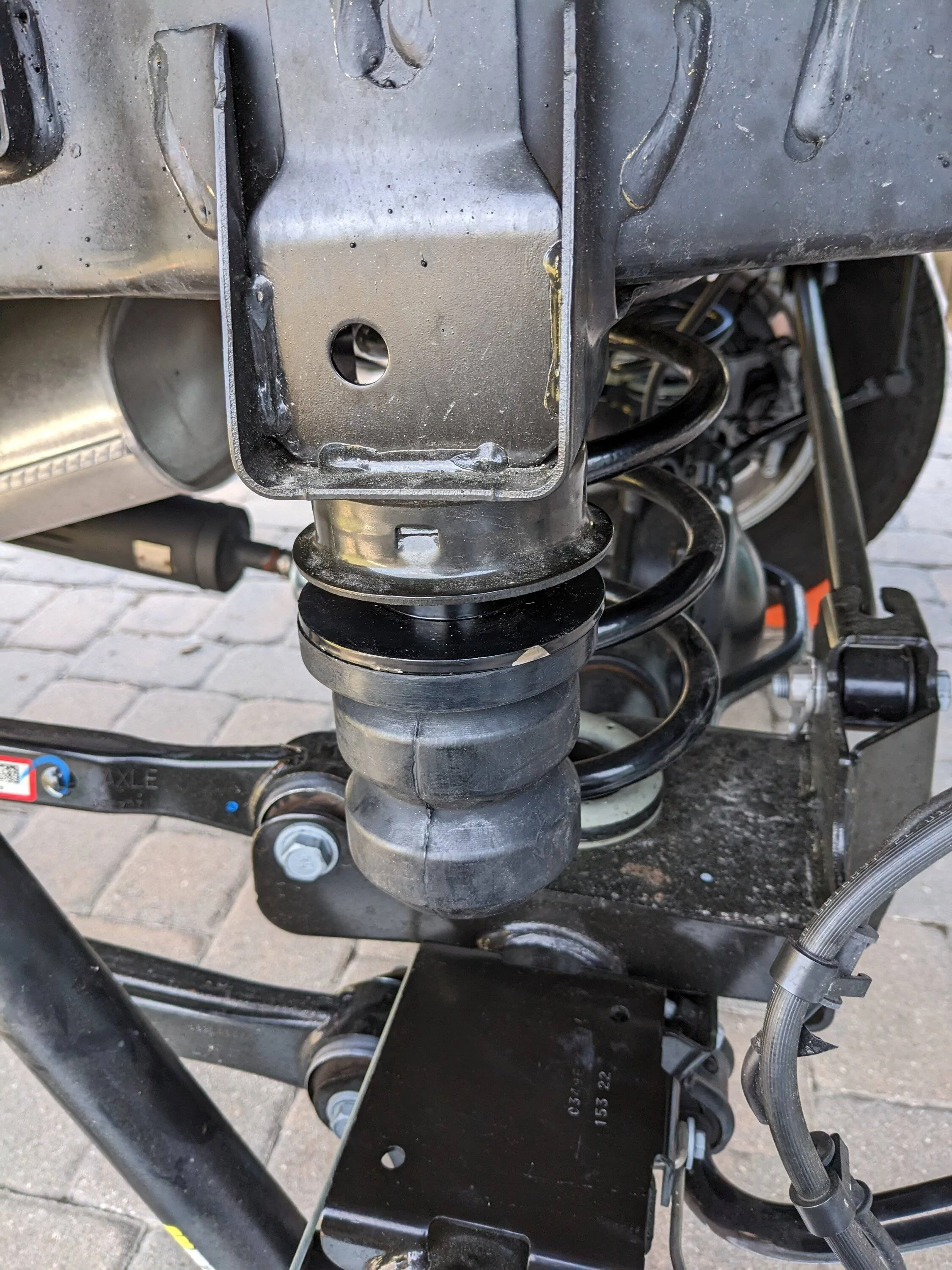

The metal plate with the round hole...apparently is not how the other trucks are.
Jeep Gladiator Timbren SES requires spring removal PXL_20230219_151542076[1]

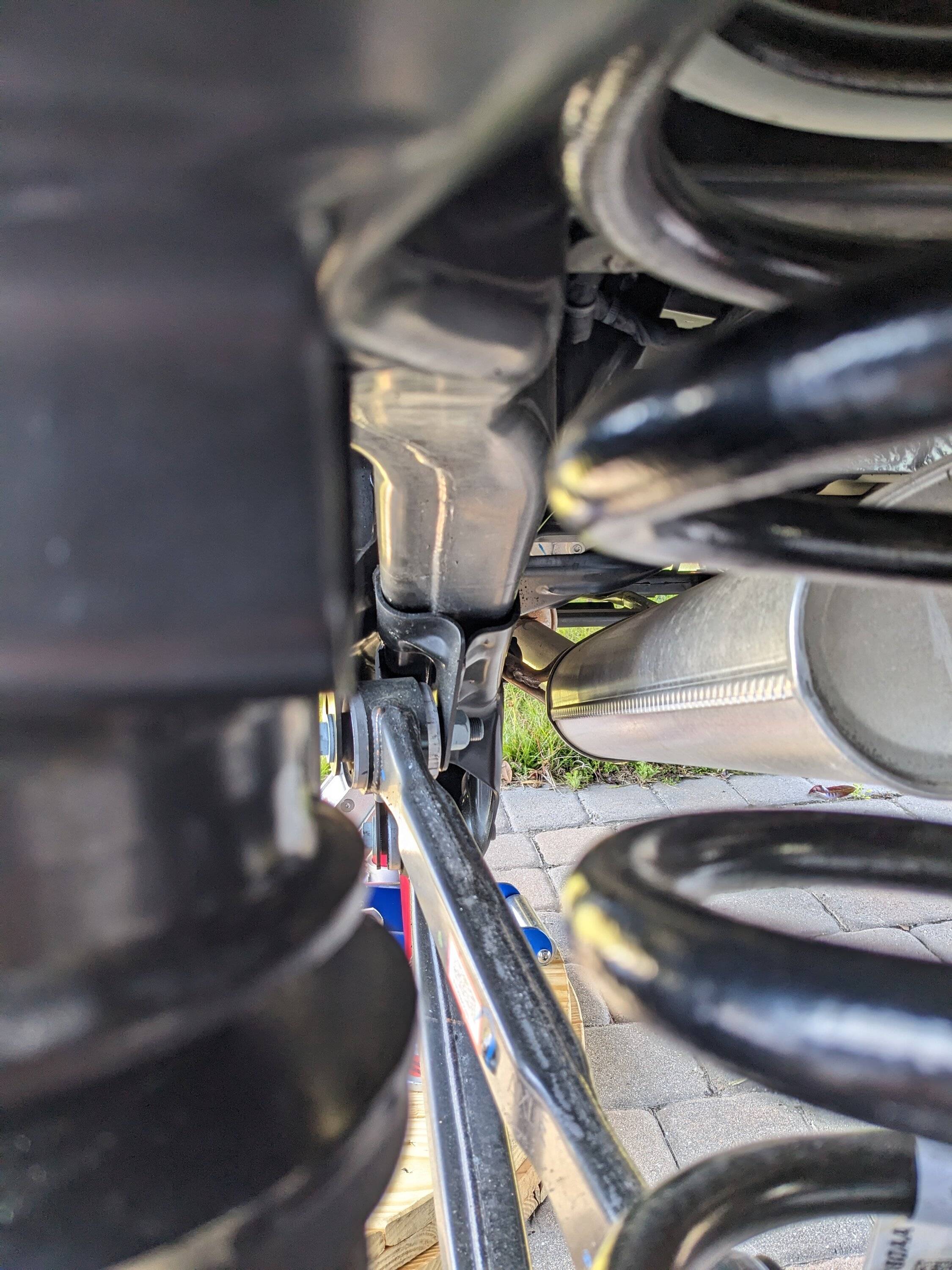

Getting the wrench on the other side was a MAJOR pain....so I am getting Sumosprings...just push them in.
Jeep Gladiator Timbren SES requires spring removal PXL_20230219_151552928[1]

I tried to install Timbren SES on the back axle but was not able to raise the frame high enough to get enough clearance to get the socket wrench in the bottom. I need to get a bigger floor jack. Been using a mid-size one for years.

The build date on our gladiator is 8-22 and it has the welded plate same as the OP has. Was able to install the SES today. Due to the tack welds they used on the nut to attach it to that top plate, there is only the one set of flats on the nut that can get an open ended wrench on. Went way quicker once I zip tied the wrench to the rear coil spring. That kept it in place while used ratchet to tighten the bolt.
