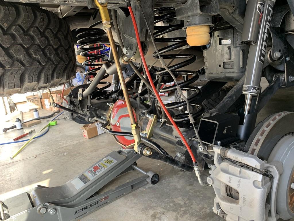

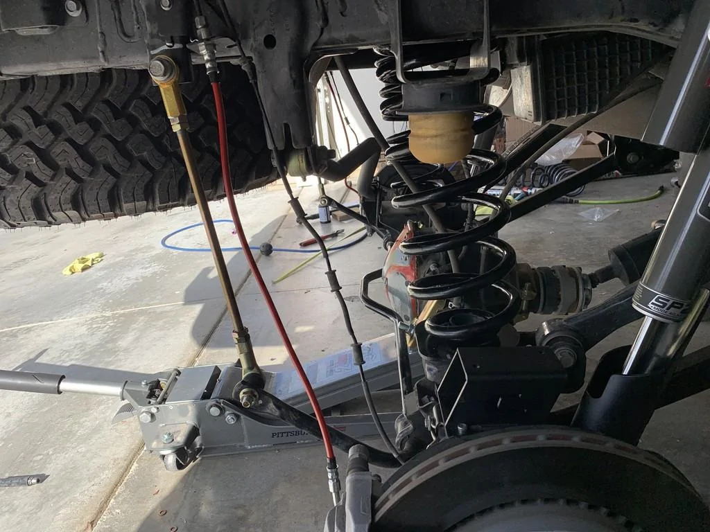

Yes you can. With the truck on jack stands, and 2 jacks, you can tilt the axle any way you want to get the space you need. Note: I just did this yesterday. I could get the extremely long Clayton rear 3.5" shocks in without any struggle. Here is what I did. First loosen all the control arms, I mean really loose. Just barely keep the nut on so it bites. Unscrew emergency brake screws at the diff. Disconnect end links. Pull out taps for the anti-lock sensors. You can lengthen them at the top of the frame. After this my stock brake lines were so stretched that I decided to put in the new Clayton brake lines first. After that, I got 3 more inches or so and the springs went right in. Note: for top isolater, I made circles with masking tape all the way around it and stuck it up there, so, it would stay.
This is how far the axle has to come down to put the new springs in without struggling.
Jeep Gladiator Rear spring removal af1B9t
Jeep Gladiator Rear spring removal 9dh8uZ
