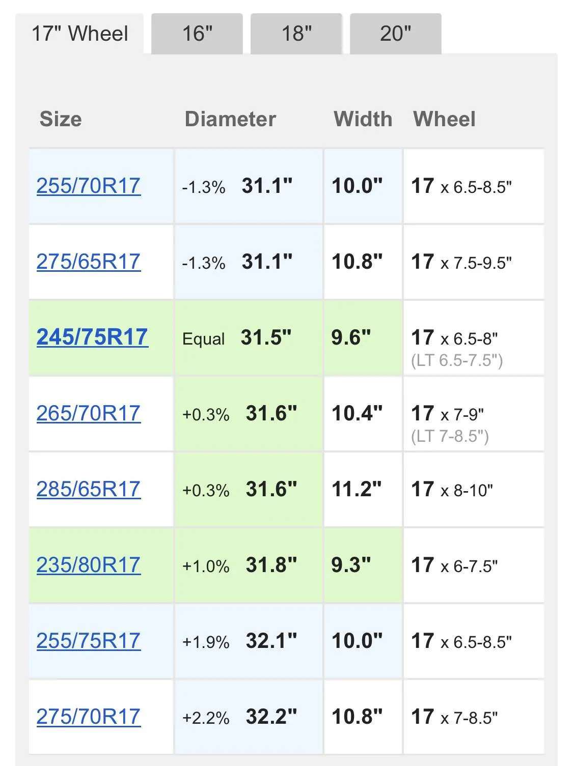

Jeep Gladiator Time for new tires . CF04EA42-46BD-407E-9F48-B6B28B688BEC
Tiresize.com is a great resource for doing comparisons and helping to figure out which size you want.
