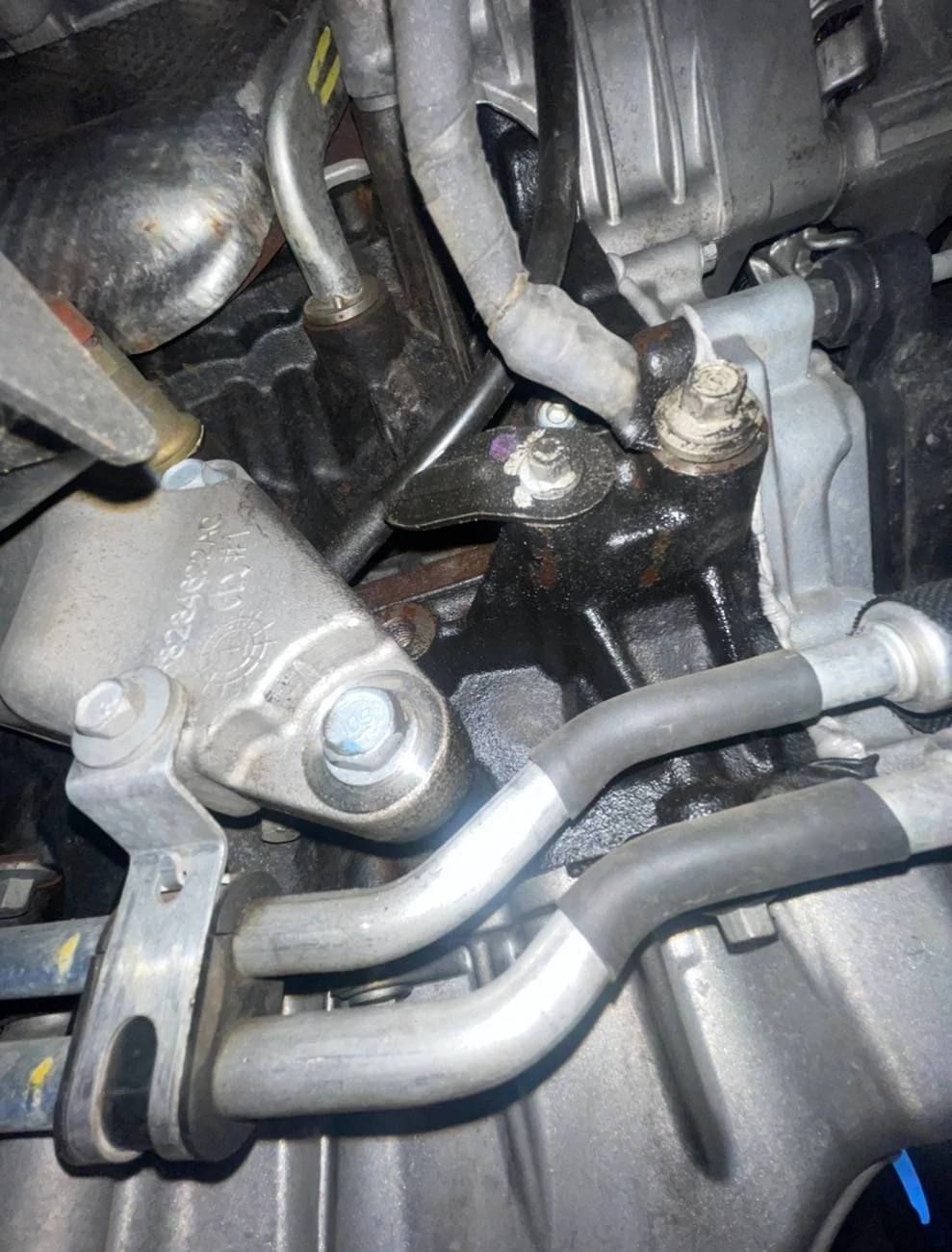

Mine was leaking right above the ground cable on passenger side but not from the timing cover, it's between the bed plate and block. Fear of an engine replacement so i just applied some JB welded instead lol. 25k+ miles so far and no more leaks.

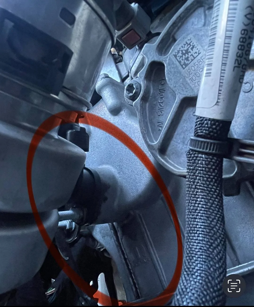

Went there this afternoon and they had it buttoned up already and running in the back. He was bleeding air from the cooling system. Had been running for about half an hour. He said it is leaking slightly from the drivers cylinder head. There is a black plastic thing there with an o ring that needs to be changed. I’ll take it back for that I guess. They still have to test drive it but getting closer.

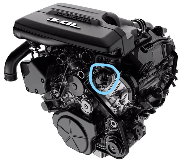

So they say they had the o-ring in stock and changed it. It's now ready to go. I'll go get it tomorrow. The o-ring was under the oil separator he said. I tried looking online but can't find any info about what it is. It is this part here:
