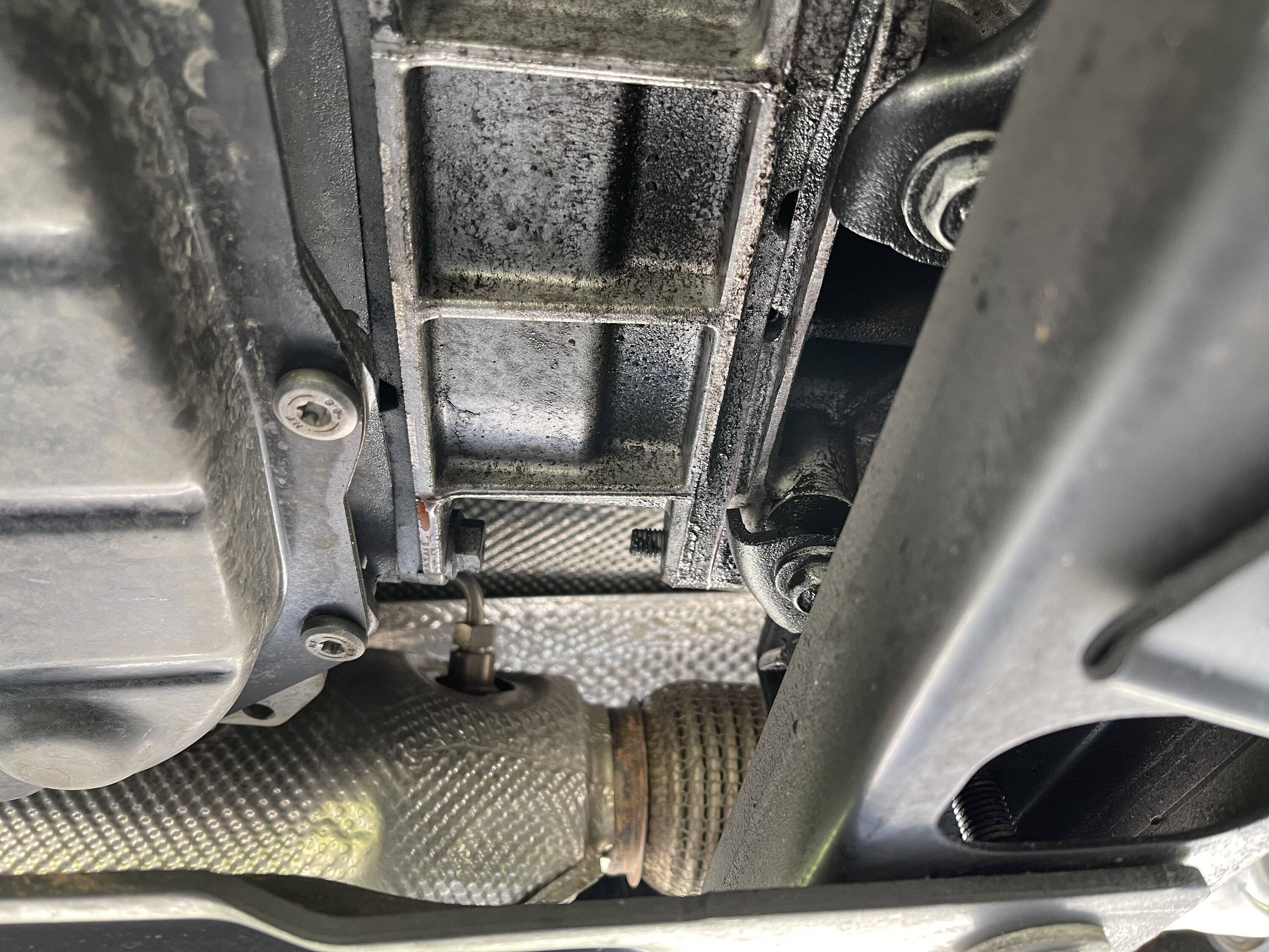

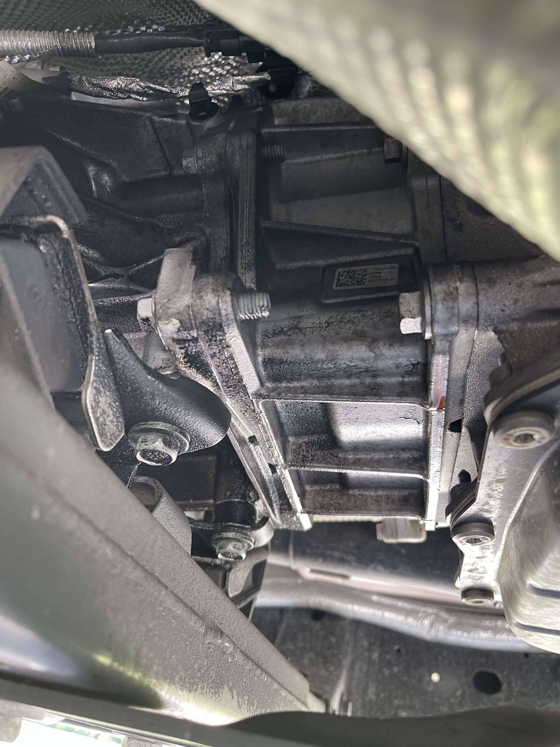

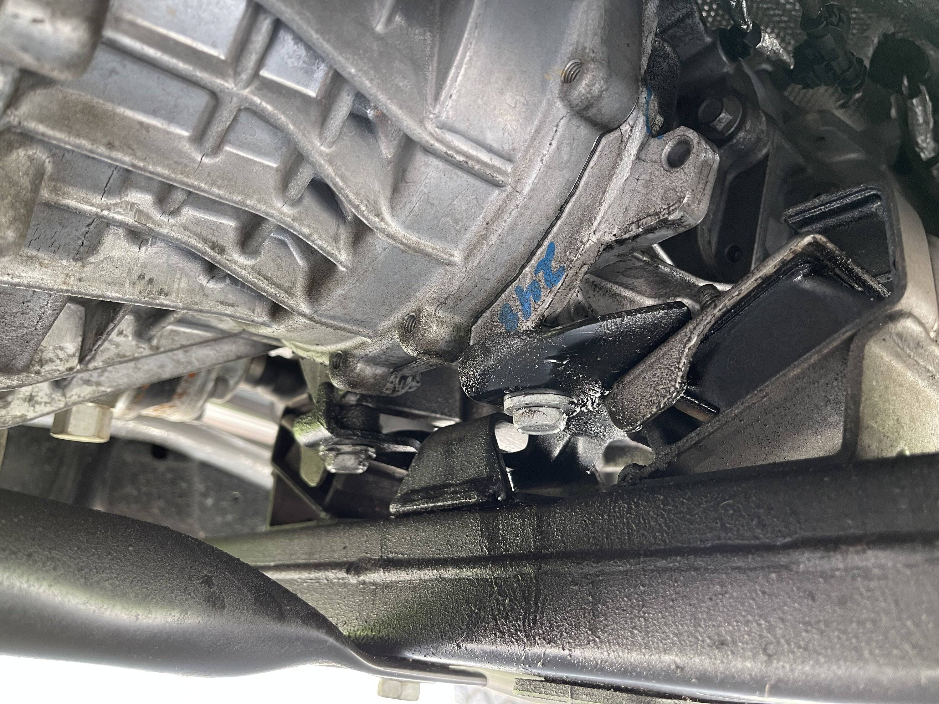

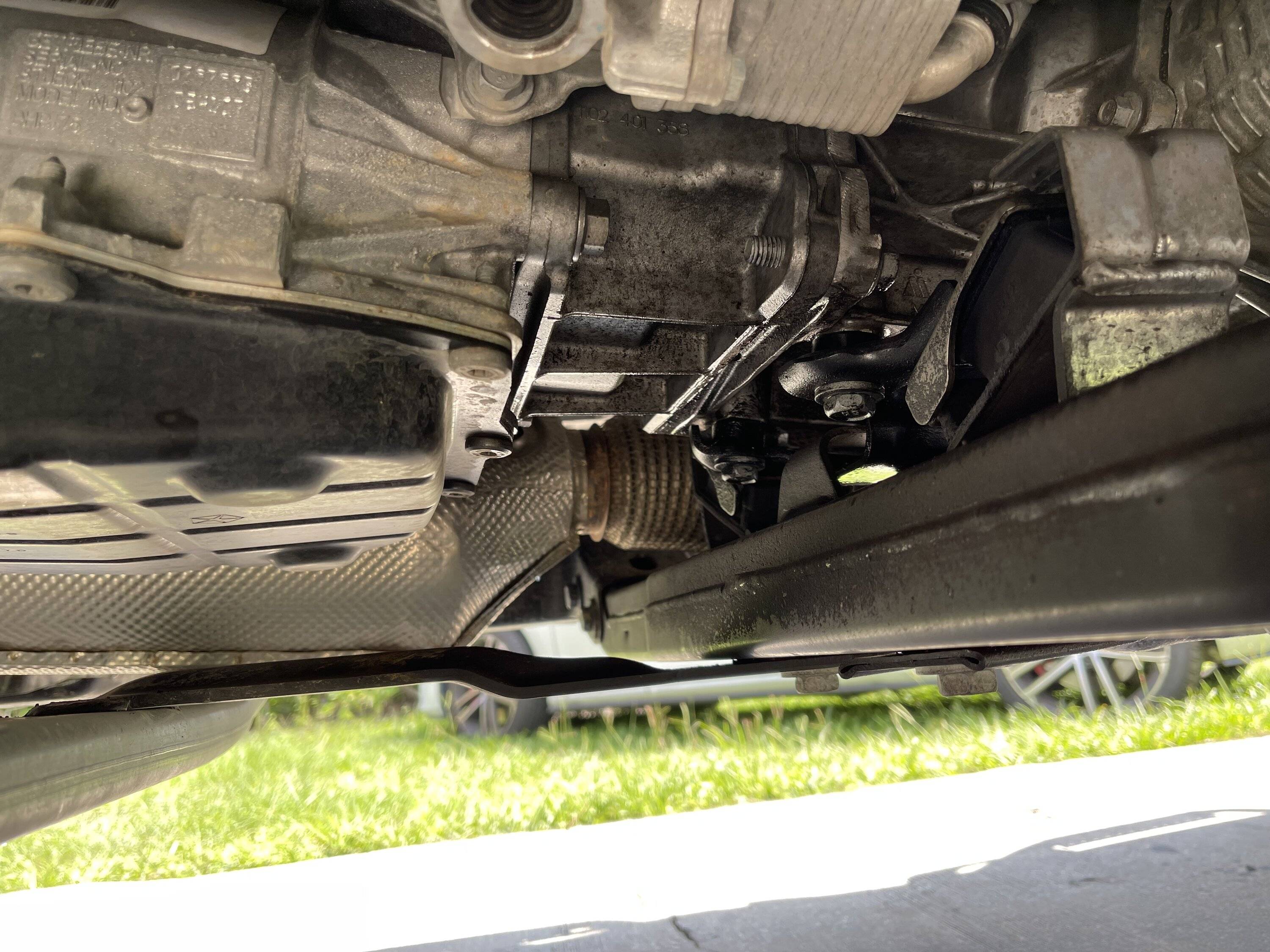

yeah here are some pics I just snapped. Like I said, its a weep, not pissing on the driveway, but shouldn't be happening on a bone stock truck with 18k miles on it. I read that the rear output shaft seal on this trans is not replaceable and the whole fuckin cog swapper needs to be R&R'ed. Not what I needed to hear the week I quit drinkin...
Well I'm sure there is some unlucky person that's been struck by lightning at the poopshoot during or since the beginning of man kind.
