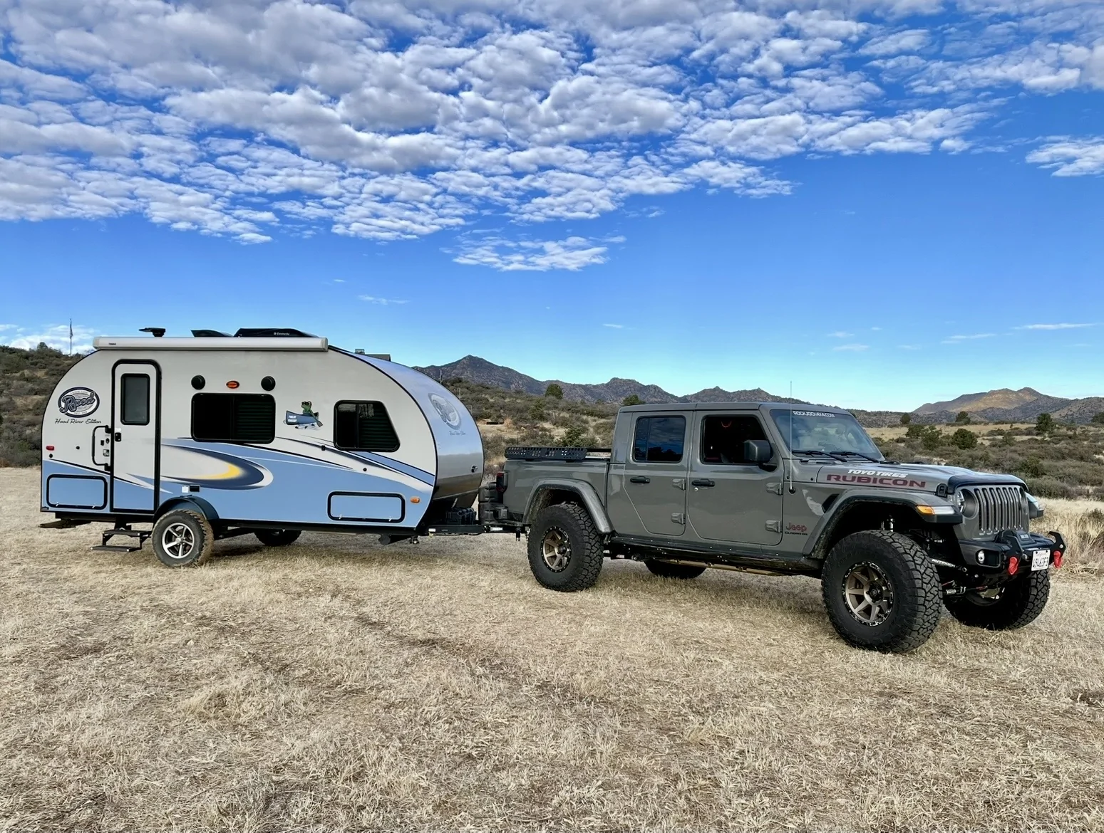

If you’ve pulled trailers before, it’s no different. I’ve pulled a 20 foot camper thousands of miles with my lifted JTR on 37’s. I often forget it’s even there. Just got back from our annual Moab trip a few days ago. Great to have a tow vehicle and a wheeler all in one.

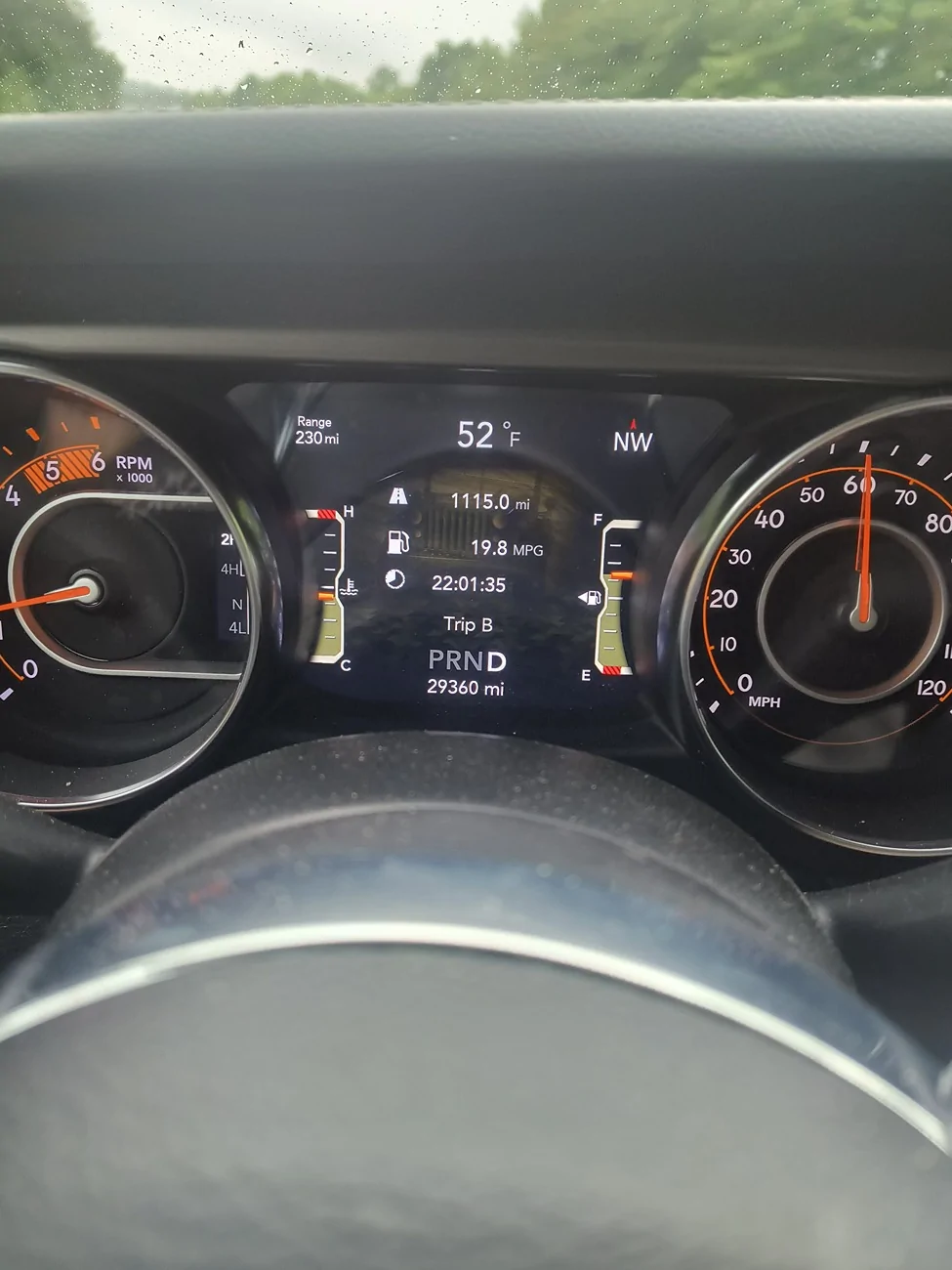

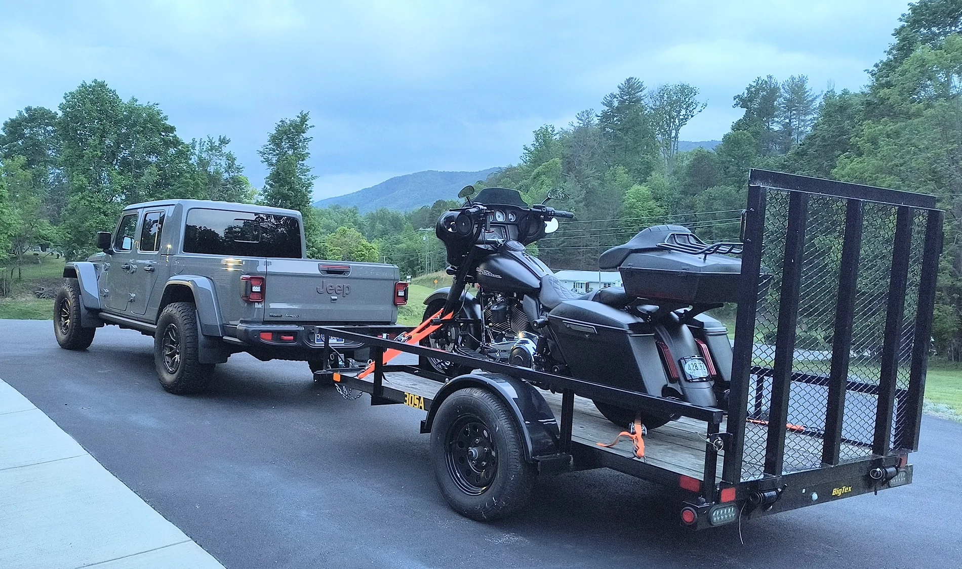

What a awesome set up can you give me the details on your suspension? We have similar taste in color and wheels. Leaving tomorrow morning to go to Panama City Beach bike week. 1st time towing for any distance. 2023 Diesel w 35's.
Great trip to Thunder Beach 1st time towing with my 5 x 10 Big Tex trailer. 1115 mile trip total. No problems at all with the towing and the Harbor freight motorcycle wheel chock steady as a rock. Overall mileage average was 19.8. Back home safe and sunburned 😂😂
