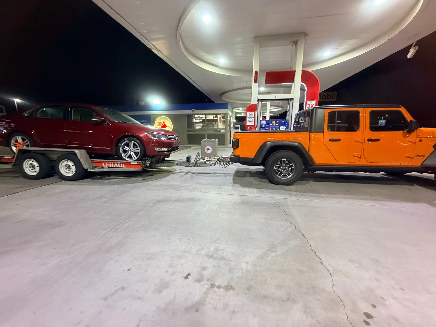

I pulled a rookie move, towed a car hauler with my Mojave and I can without a doubt confirm that these springs need some help and that I've lost about an inch on the rear lift.
I have a 22 Mojave, that I added airbags to to tow my travel trailer. The suspension was never a problem, the man trans left me wanting more.
So I found myself in a Joose Mojave, and had a family car breakdown, thinking, hey it's well under the weight of the travel trailer, I should have no problem... I could not have been more wrong.
So now I'm looking for replacement rear springs, to keep that soft rear feeling, and gain back that inch I lost....
every inch counts!

Uhaul trailer suck. I'll never haul a car with one. With that much weight forward, no wonder it says. I bet the dumb uhaul trailer and weight are part of the problem
ChrisNLA
Jun 7, 2022
2,072
3,739
Louisiana
2022 JT Sport Max Tow
Well there appears to a foot or more behind that VW to back it up, though you wouldn't be able to use the built in front wheel winches. Though you could load it backwards and alleviate some of the tongue weight. Them being built for lowest amount of brains and highest amount of abuse means not a lot of flexibility in how to use them.
It's also low key wild how heavy they are (again to survive rentals).
The deck on that trailer is only 12' long with an open center, and weighs 2,200 pounds empty.
An 18' car hauler with a wood deck for sale locally weighs 2,300 pounds and gives you about 16' of flat deck with no open center, and 2' of dovetail.
We have used the dolly's in a pinch, but never fool with the trailers because there isn't enough trailer to balance it properly half the time.

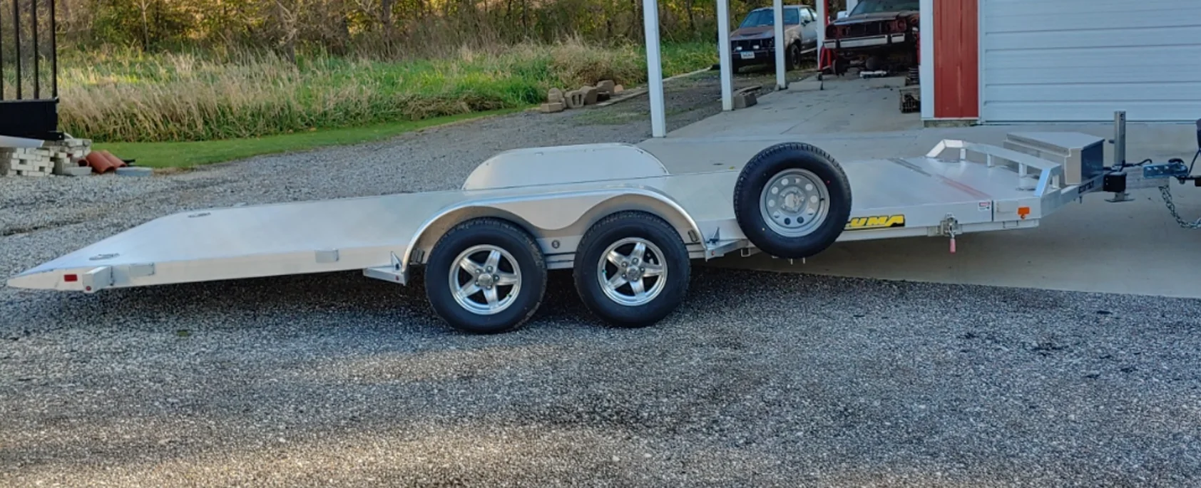

I agree on the Uhaul stuff.
2,300 pounds, locally.
https://truckandtrailerworld.com/20...uler-trailer-denham-springs-la-70726-i4985341
I've bee on and off trailer shopping. Nothing I'm buying soon, but a nice to have.
40,477
53,959

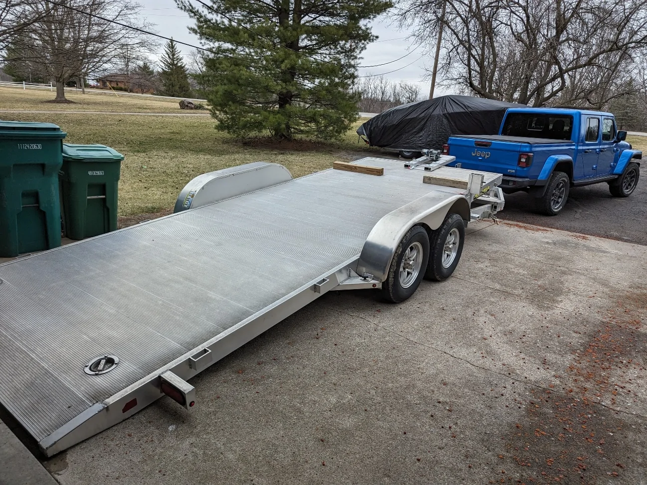

The shield and box on the front help explain some of the weight.
My current car hauler - 1600 pounds as shown, box full of jacks, straps and so on.
Tilt bed.

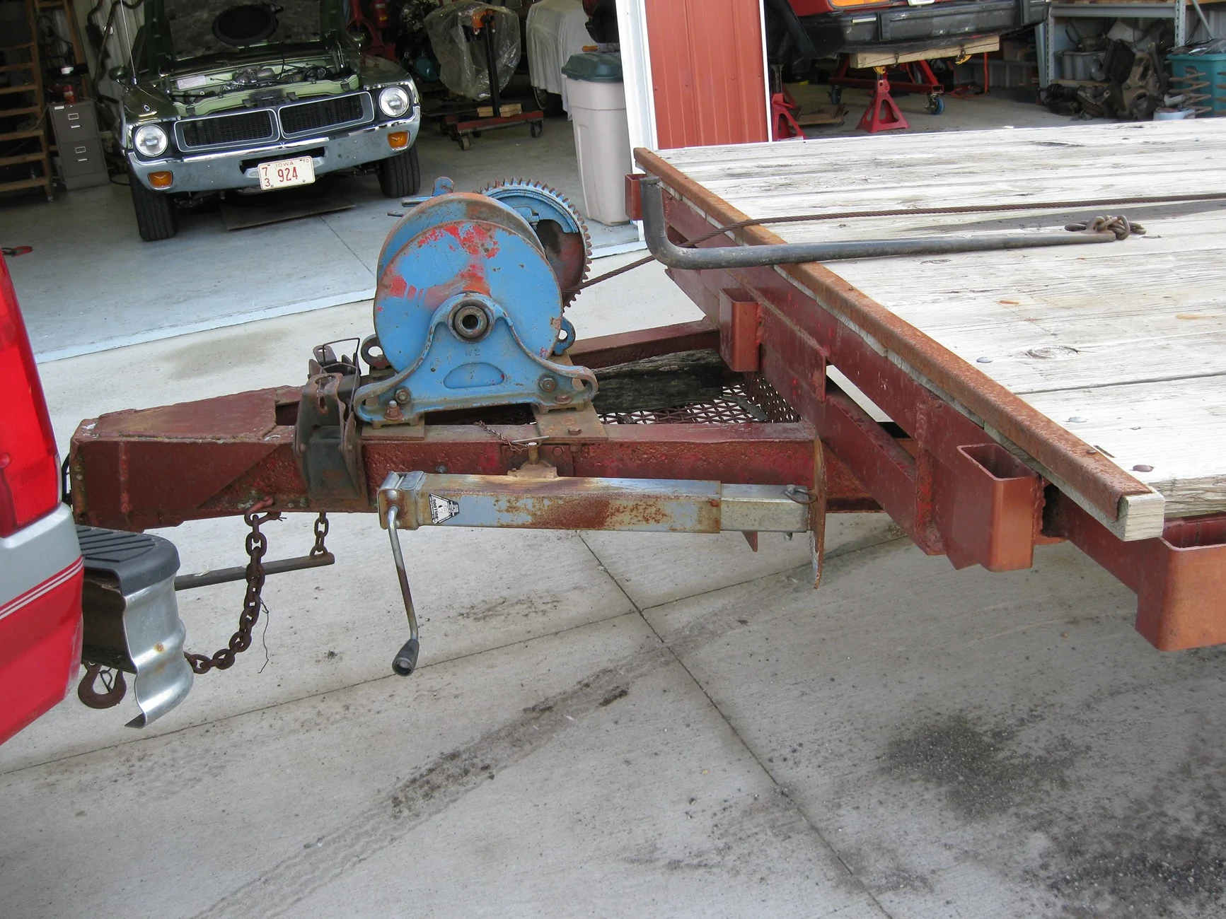

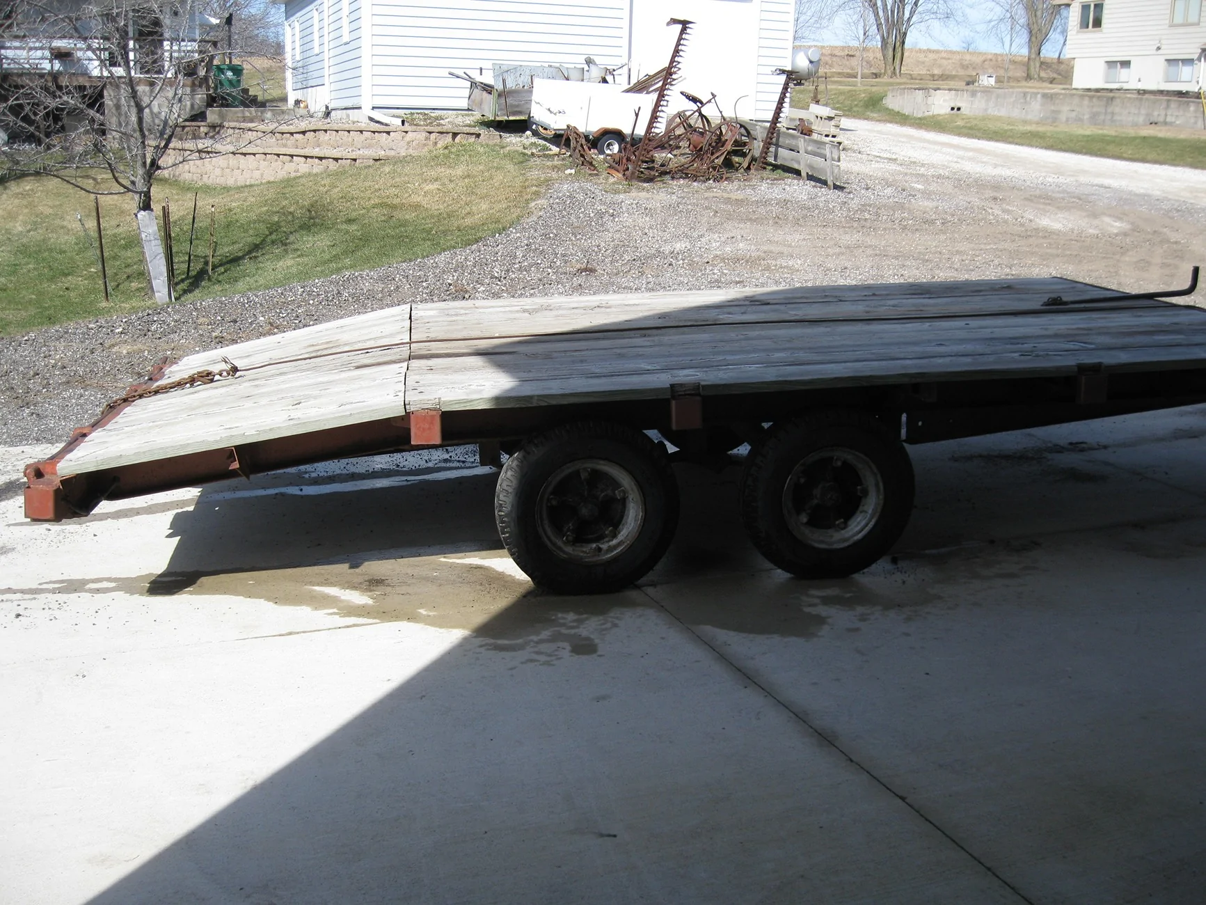

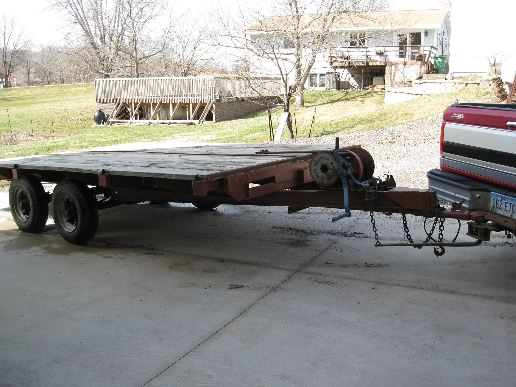

And my first - a friend called it a box car on tires. I bet it weighed 3,000 empty at least!
Jeep Gladiator Pulling trailer with a Mohave X? trailer 002
Jeep Gladiator Pulling trailer with a Mohave X? trailer 001
Jeep Gladiator Pulling trailer with a Mohave X? trailer 005
