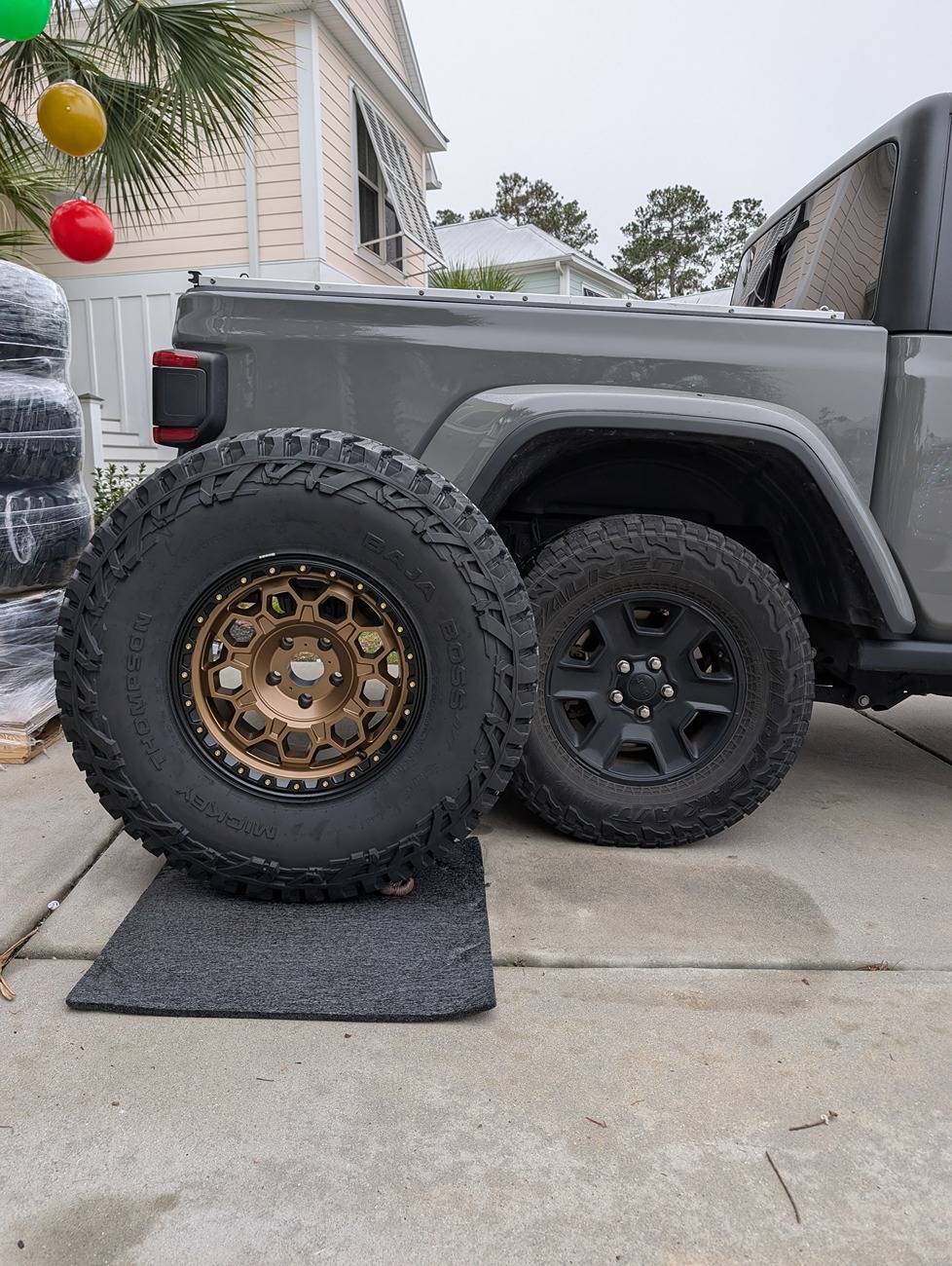

Hello,
Some background.... I own a 2021 Mojave, and I have had the infamous Manual clutch recall completed.
I am getting a lift and larger tires (37") put on next week, and I want to recalibrate the speedometer for the new tire size. I am concerned because I have heard nothing but horror stories about doing this after the Clutch recall with regards to the new software.
I was thinking maybe I should go to the dealership to have them do the recalibration. That way, if something goes wrong, they can't place blame somewhere else. Or should I just use a Tazer or JScan?
Has anyone had any success stories? What method did you use?
Thanks in advance...

I doubt having your dealer do any calibration change is going to give you any benefit of them not pointing back at your 37's regardless down the road. I would suggest just using a JScan setup as you will probably have to do it two-three times to get it dialed in just right anyways.

TAZR and done

As I'm in an auto, I'm not aware of any issues with a manual trans and a tire size recalibration. Perhaps others with that recall recently done will jump in.
Regarding the change in tire size, I have the JScan app and have used it to recalibrate my speedo when I was running 35s and then the current 37s. When recalibrating for tire size, measure the actual diameter, not the advertised diameter of your tire, and enter that value.

Great! Thanks for the replies! It seems like from what I have been reading, that the dealerships run into the issue but don't know what to do. Then the owners either use JScan or Tazer and it solves the issue. Since I already have a JScan well....
