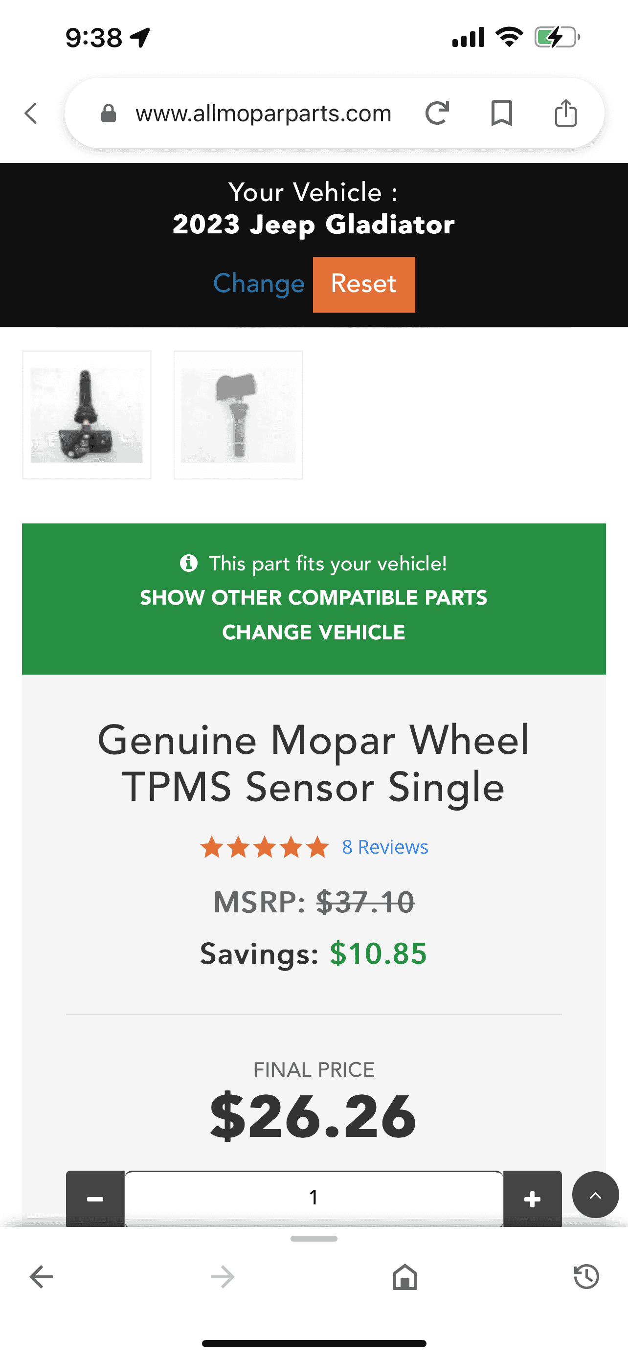

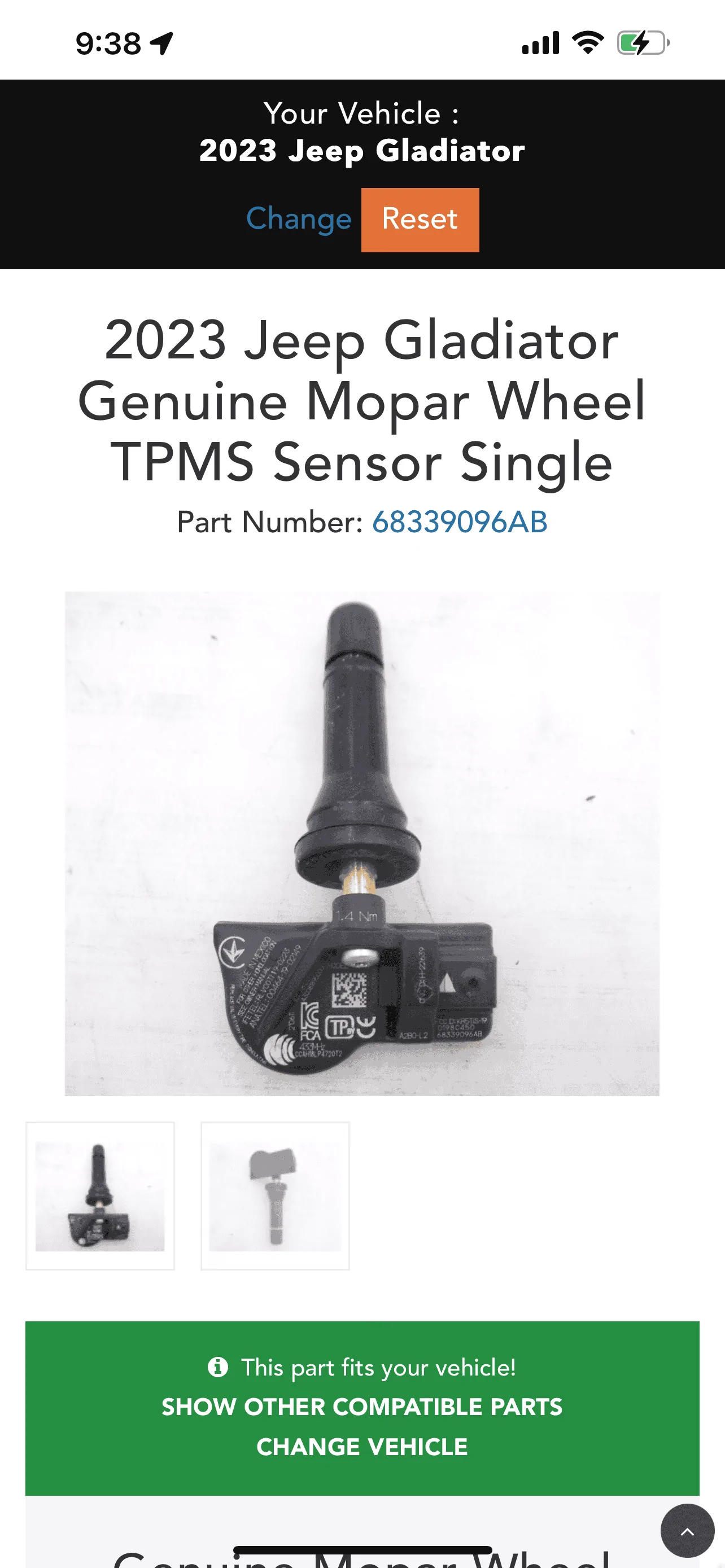

I’m looking for just the stem, five of them. But if it turns into a headache, I’ll just buy five of these complete…… or is this just the sensor??
It's just as pictured. Bought one myself.

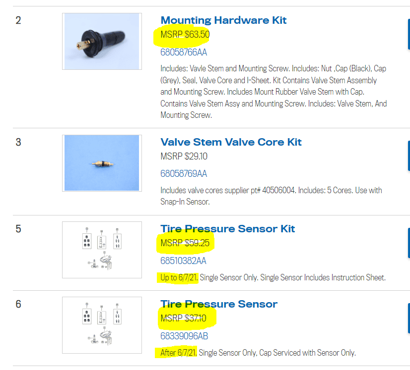

There should be a Mopar 'service kit' for the sensors that is the valve stem, cap & screw. I bought some for my JK to have spare stems & caps.
EDIT:
Found the kit, it's called a "Mounting Hardware Kit". But it's $63.50, which is more than a complete sensor. Makes no sense.

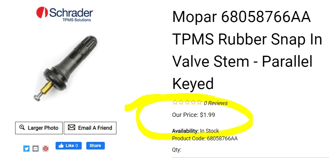

If you put that mounting kit p/n into google, you should find many lower cost solutions.
Example, tpms.com has them for $1.99:
Jeep Gladiator Tire Valve Stems - which one to buy? 1671020125224
Thank you.
