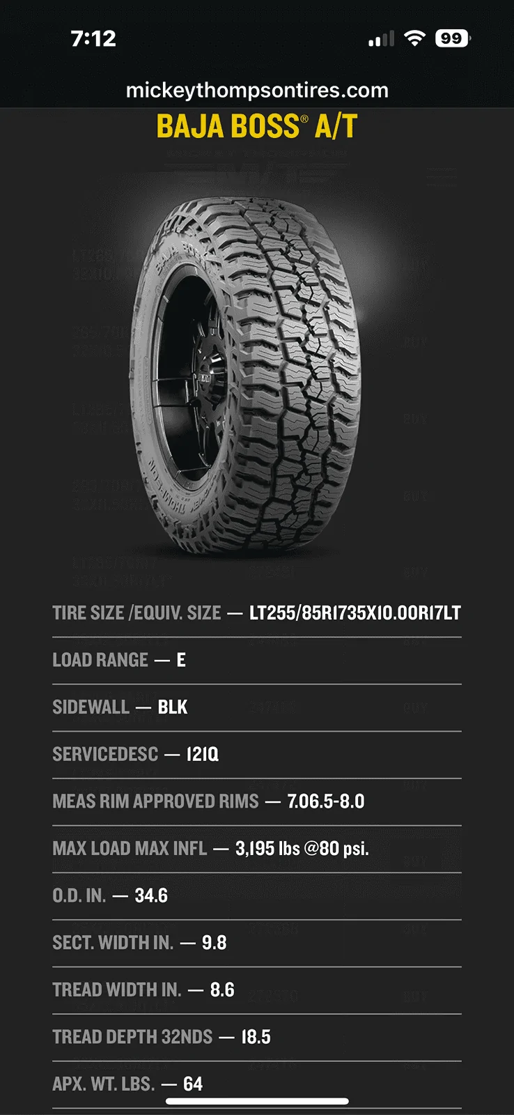

I think I’ve got it narrowed down to:
255/85 Baja Boss
285/75 Open Country AT3
Leaning the latter.

Baja Boss is the best tire i have ever run hands down

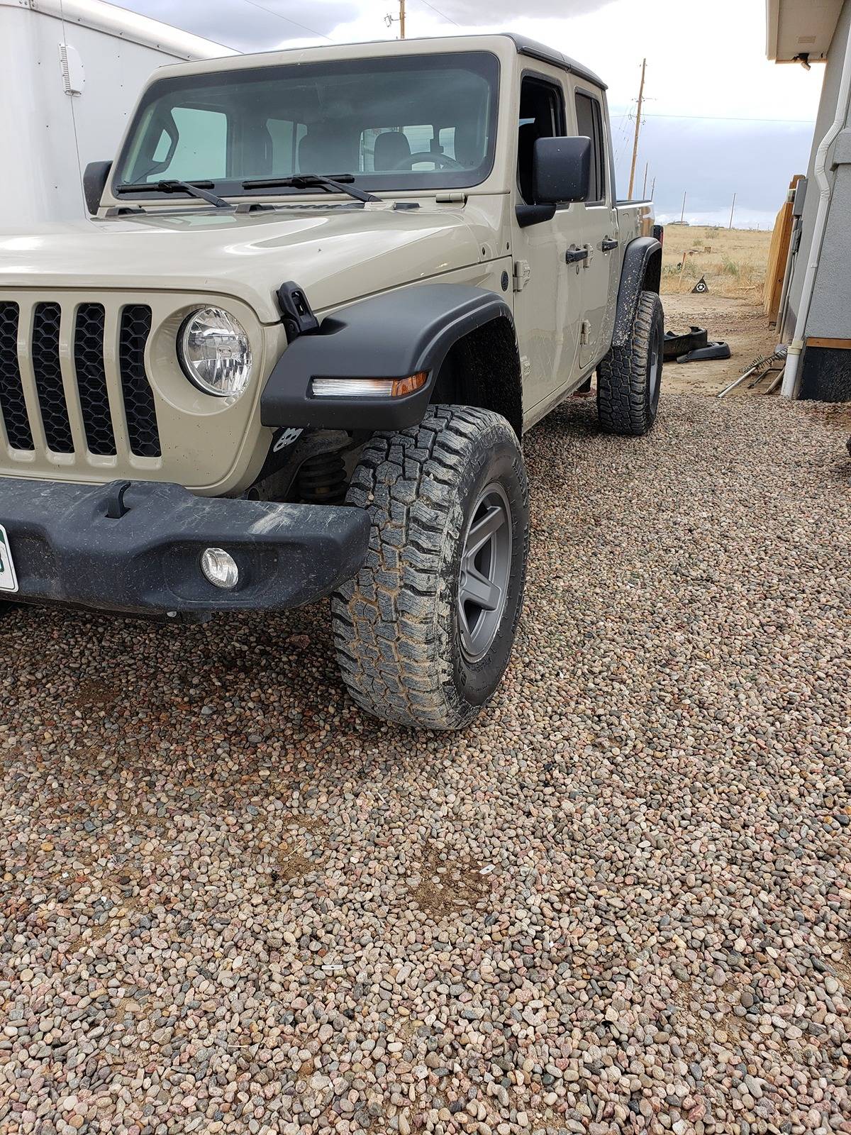

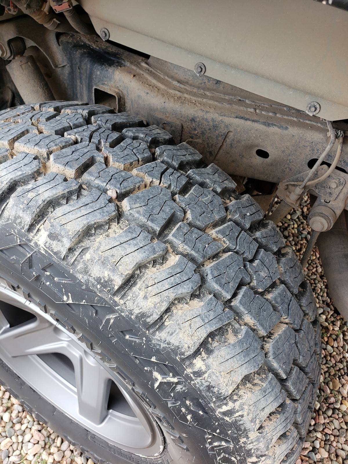

The narrow Mickey Thompson Baja Boss A/T 255/85R17 are 100% the best tire choice I have ever made. They absolutely crush on-road snow covered conditions. The only better tires are likely winter specific. I will never opt for anything but these tires for winter weather and would/will absolutely run them year round.
One can avoid the too “tucked-in” tire look with +25 offset wheels or for some poke, 0 offset wheels.
Third photo: The only reason I have the Kenda Klever R/T (point being R/T) 35x10.5x17 as my warm weather rollers, is because the Mickeys were on backorder at the time and I am impatient AF. I would not even consider an R/T during the winter.
I would sell said Kendas (6 - two have 0 miles on them) for another set of the Mickeys and would push down my grandma to get to the last set on a rack!

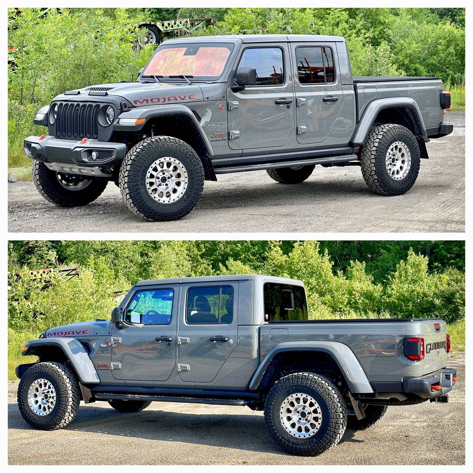

This is my rig with the Baja Boss AT 285s in D2. The wheels have a -6mm offset. I "upgraded" to the Toyo open country RT Trails in 315 70s. I live in southern Colorado and it's usually warm and dry here and I'm happy with the RTs but probably too hard for your weather. I could recommend the MTs for wisconsin climate but my sharp rocks and rough roads tore them up pretty quickly.

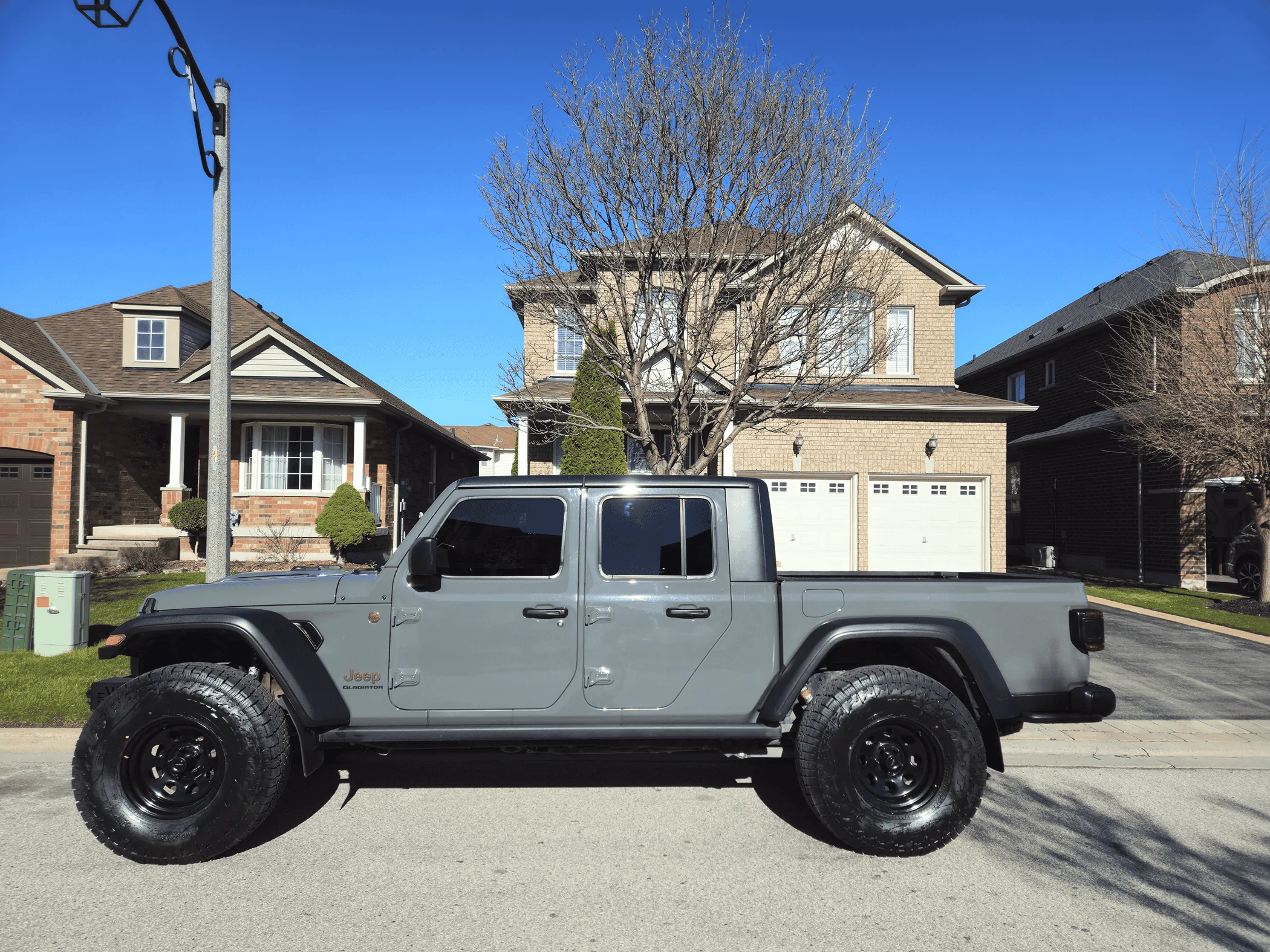

Another +1 for Baja Boss if you want to pay the Mickey Thompson brand name tax, they are used by a ton of people for a reason. Falken AT4ws are also extremely good, I love them.
I don't really see the problem with E rated tires personally.... I've run them on all my trucks, keep the pressure down when you're not loaded up and they're fine. My Rubicon drives beautiful with them around 28 psi. Now if you're the type to run 35" tires on 20" rims... maybe E rated tires may be a bit much for you, but if you have plenty of rubber and not so much rim they're fine.
37x12.50R17 Falken AT4ws on 17" Pro Comps, $400 CAD a tire for these is a great deal. The Mickey Thompson A/Ts in the same size are nearly double the price here.

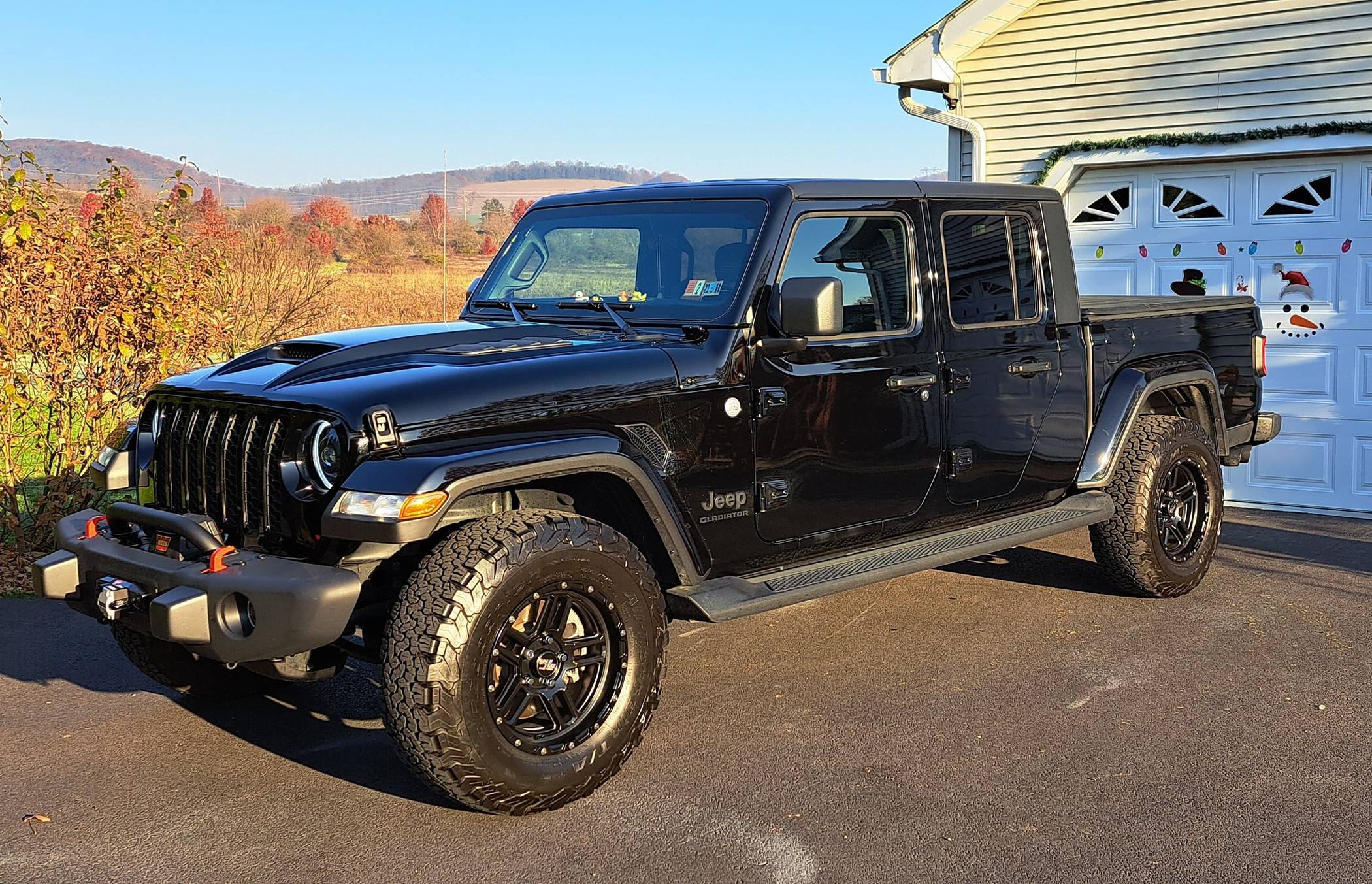

You live up north like me, I would never buy anything without the 3 peak symbol.
BFG KO2's are good in the snow.
Had them for 3 years
