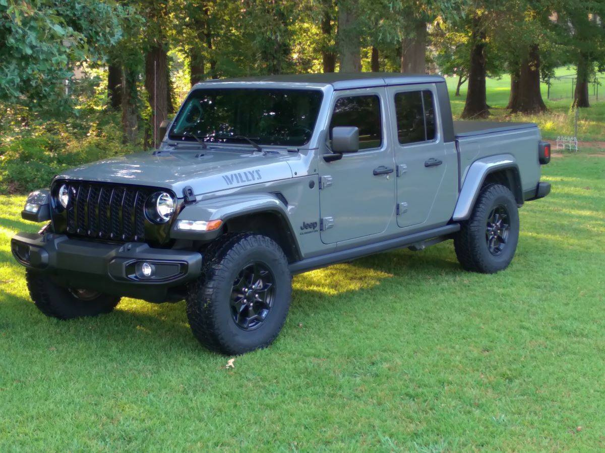

I put 285/75R17's (34's) on my Willys. It has a TeraFlex 1.5 leveling kit on the front. I didn't want anything that would possibly rub. I don't know how much taller you could go on a Sport with stock wheels and not rub a little at full turn, when flexed. They haven't killed my mpg's with the 3.73 gears either.

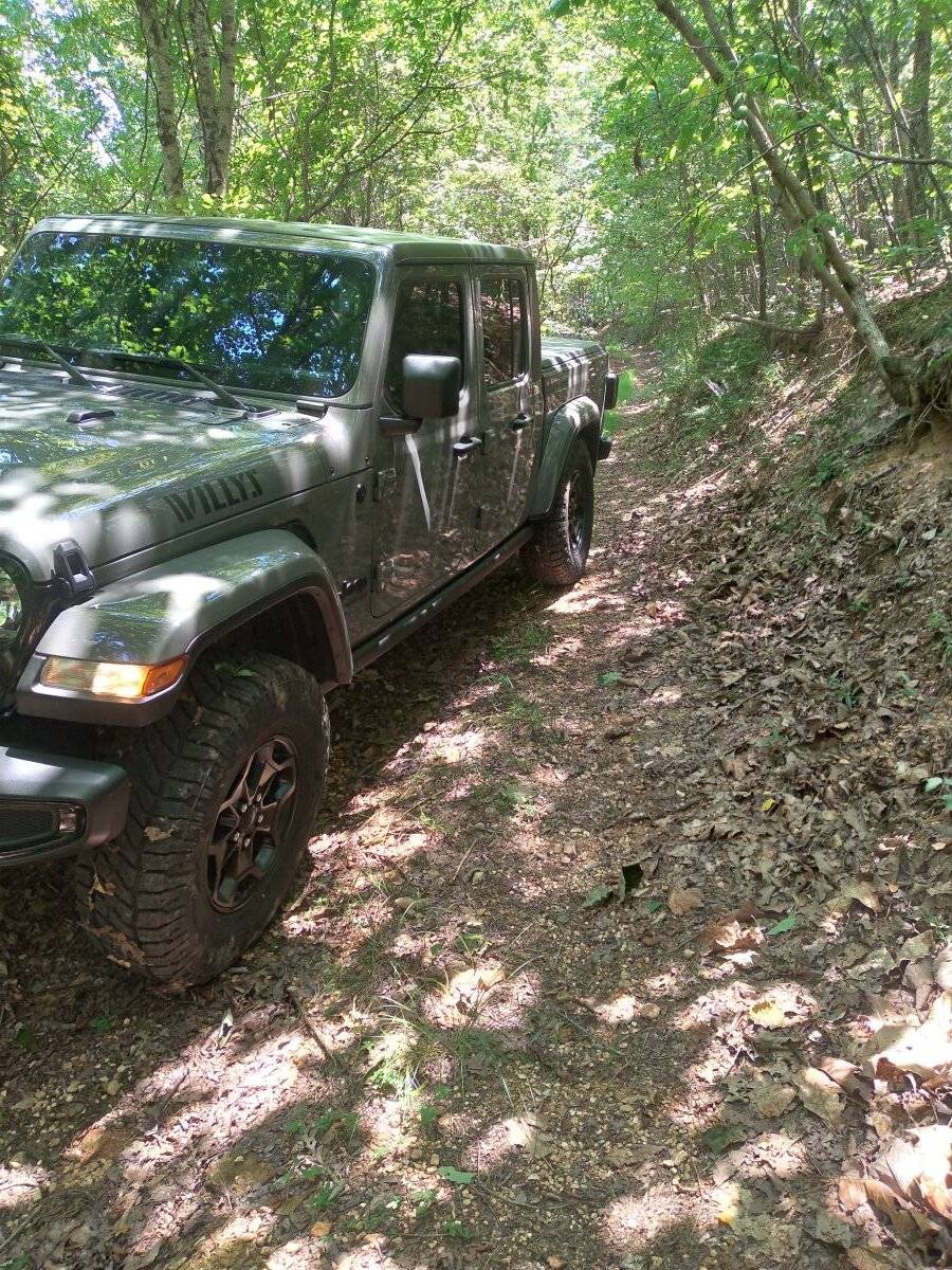

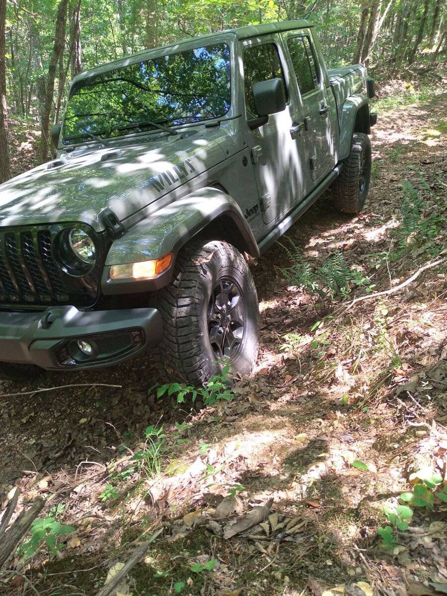

If you wheel, your front tires will probably rub if flexed while turning with anything taller than 34" tires on stock wheels. I did a little testing today while clearing trails on our hunting property. I didn't rub, but they were close. Unfortunately, I don't have a pic while in a turn.
