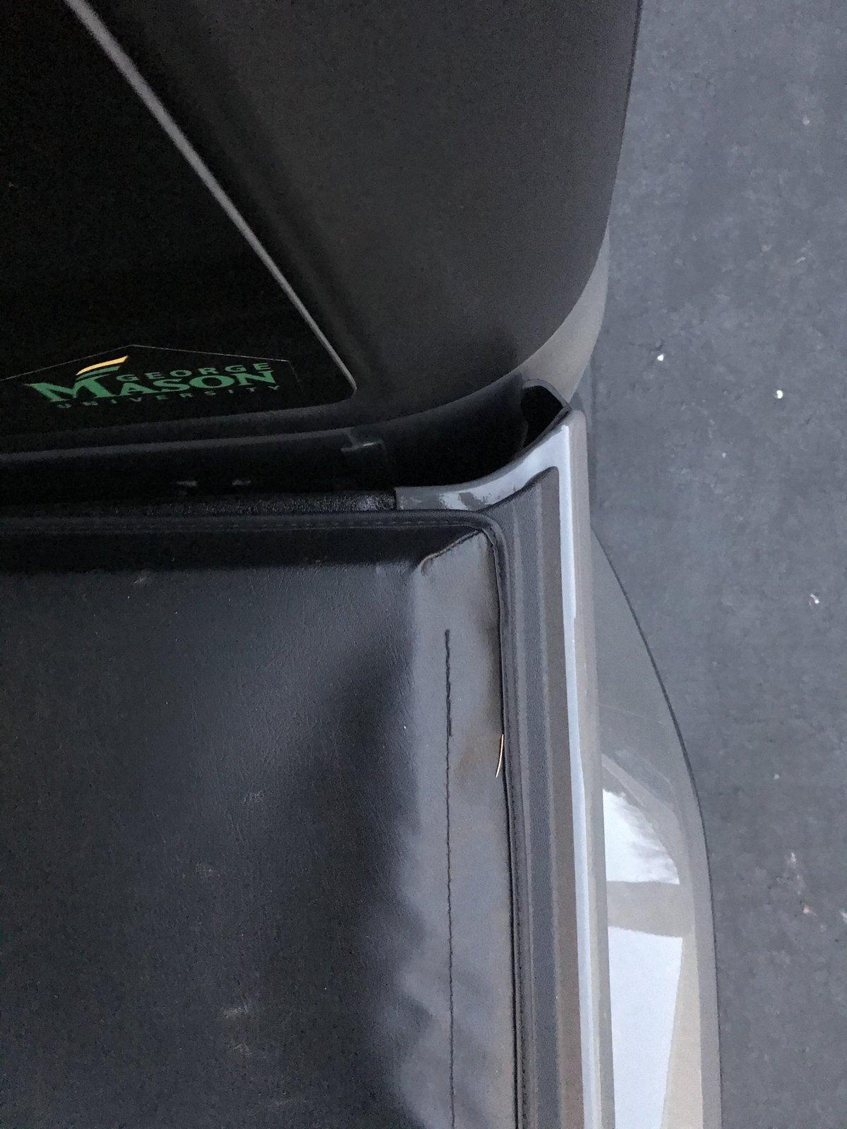

How does it blend in with the black soft top? Looks like you might have the premium...
It's not the same material as the soft top and factory tonneau. I have the premium top. The tonneau is vinyl, but it looks fine and I think it blends well with the truck.

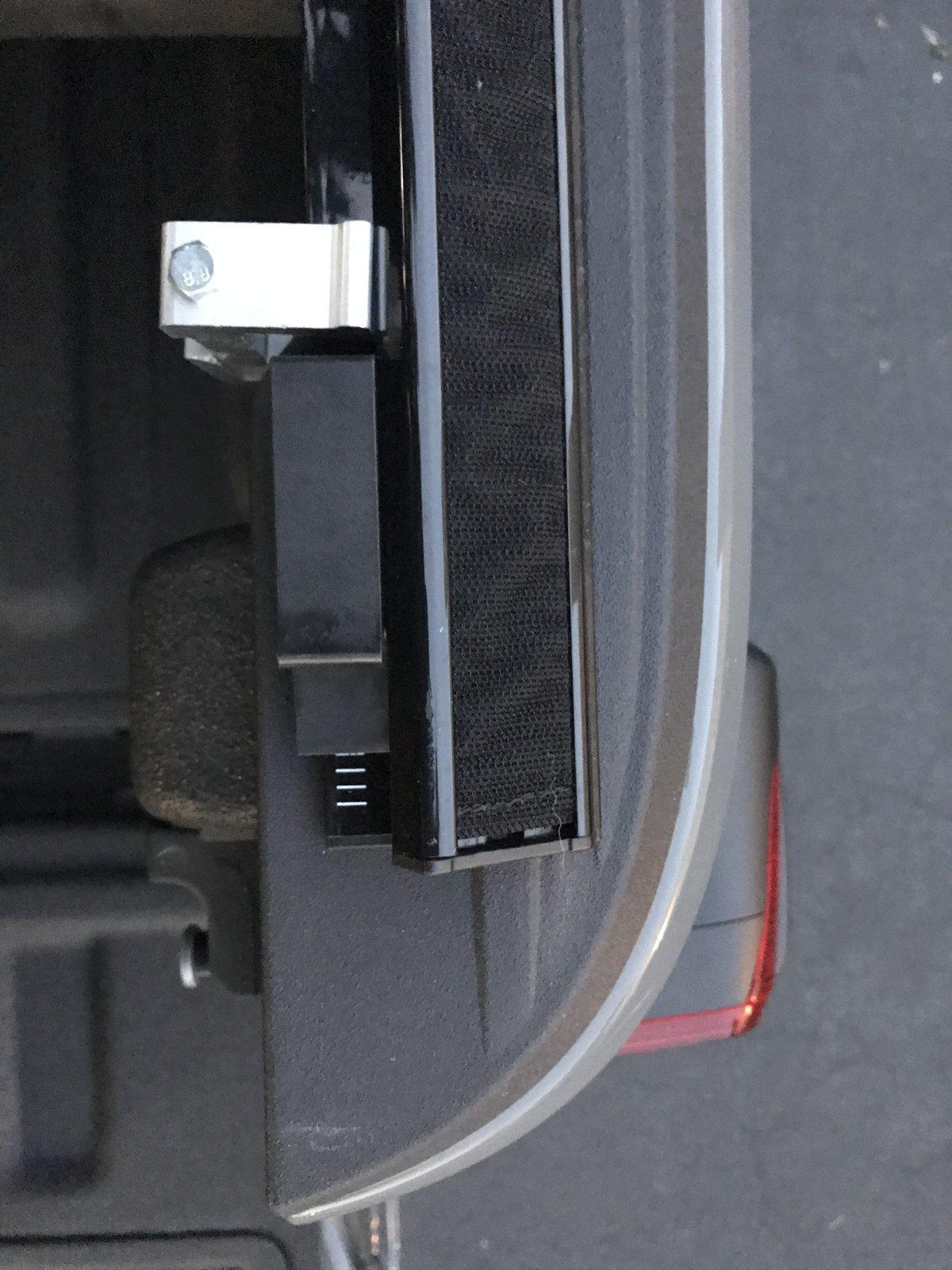

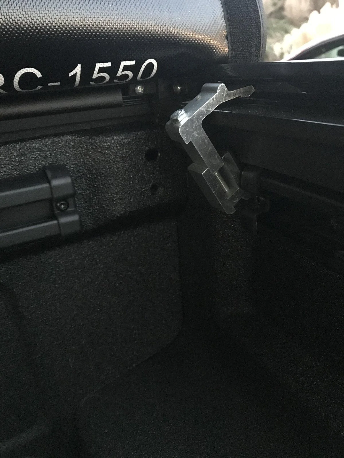

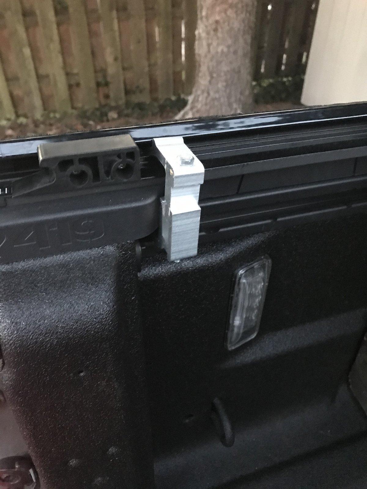

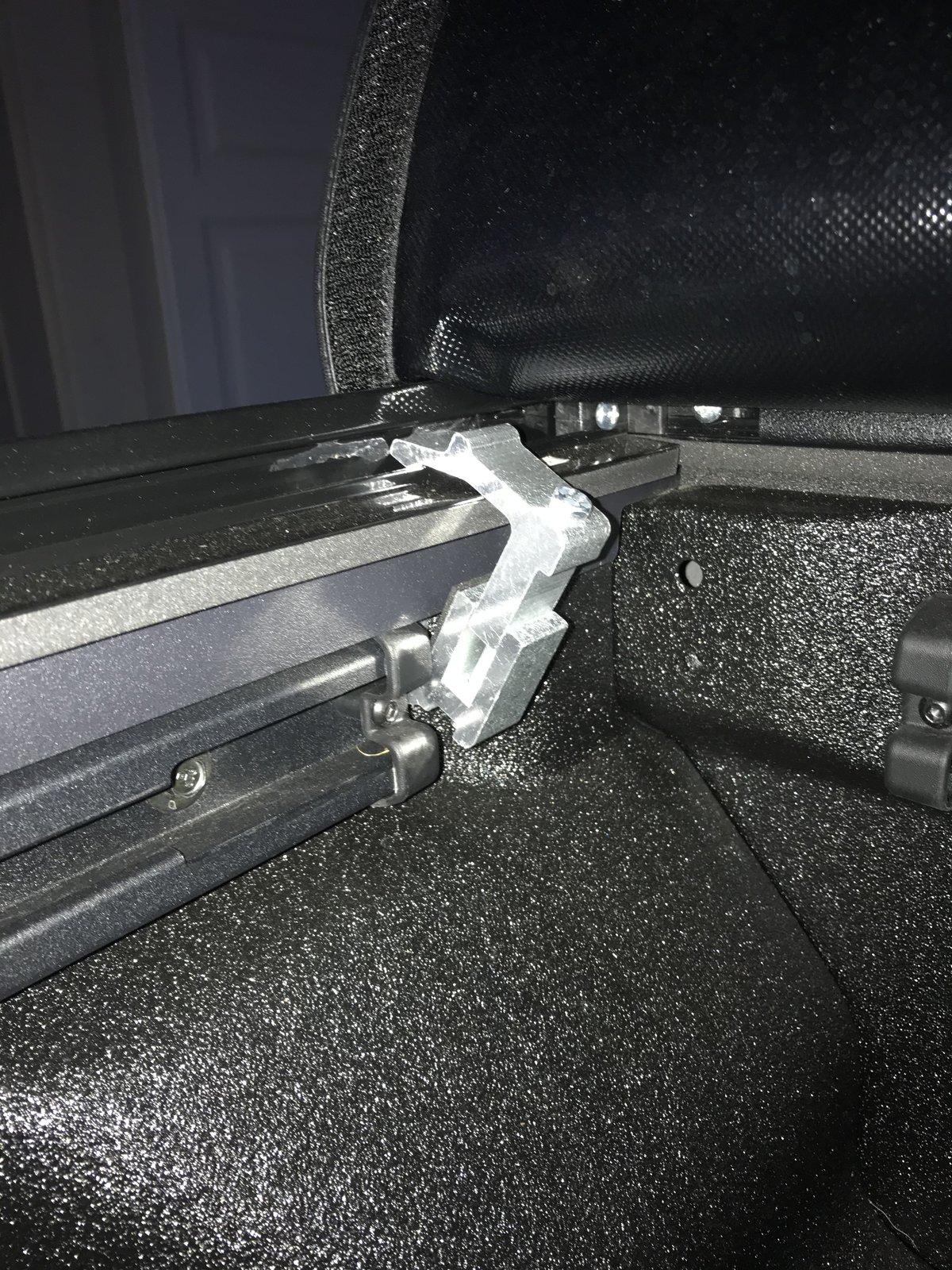

Alright @mikesjt and you other guys who bought this one....mine showed up today and the clamps don't get even close to tight. What did you do? I noticed that in the clamp bag that it said it was for Tacoma's with the utility rack? Also, any chance you can post a picture of how far back you mounted the front or side rails? I appreciate it GREATLY!! Thanks guys!!
Moab
Dion
Apr 14, 2019
42
490
870
Pennsylvania
‘20 Jeep Gladiator Overland, ‘17 Jeep Grand Cherokee Overland, ‘73 Porsche 914-6 GT,
@Racer5112 Here are some pics. Find the right bite onto the bed and cinch er’ up.
It’s a bit fiddly but after 4 months, still snug and no water infiltration.
