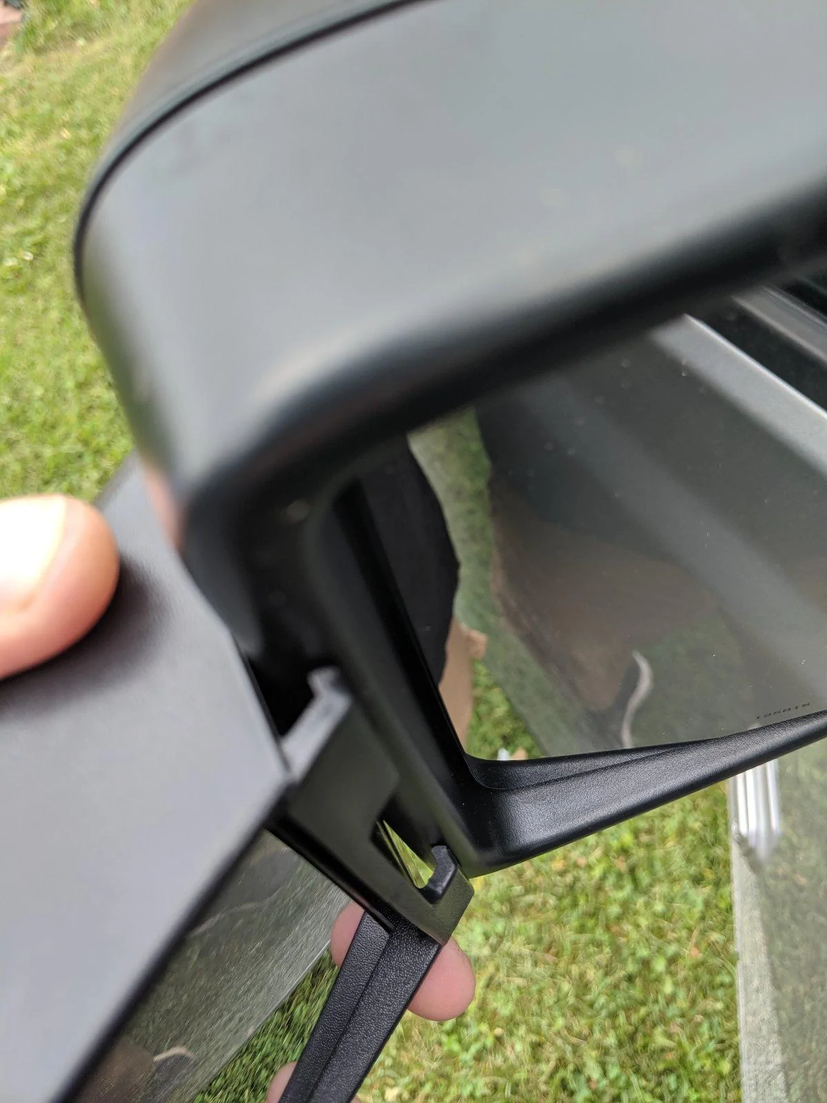

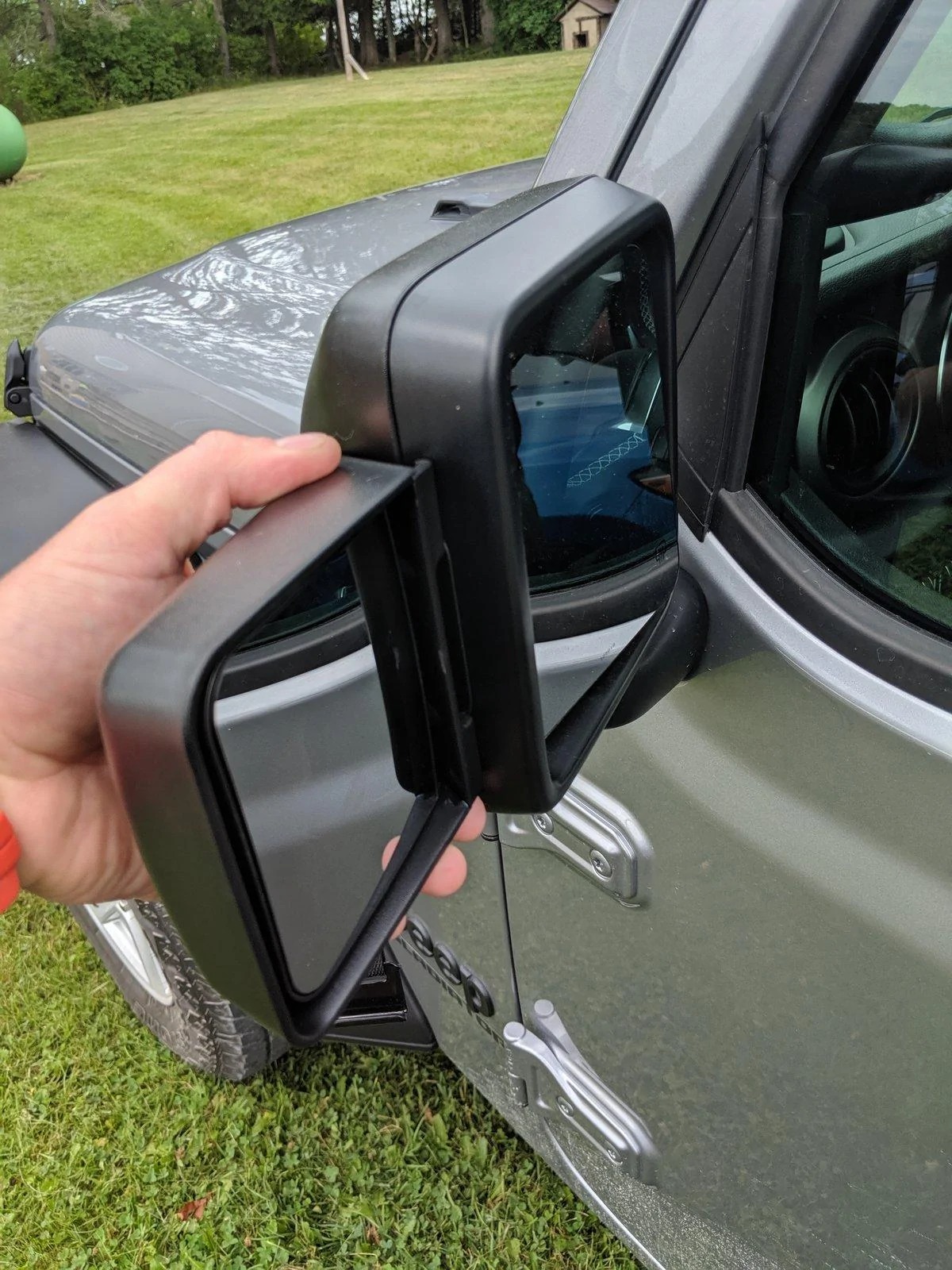

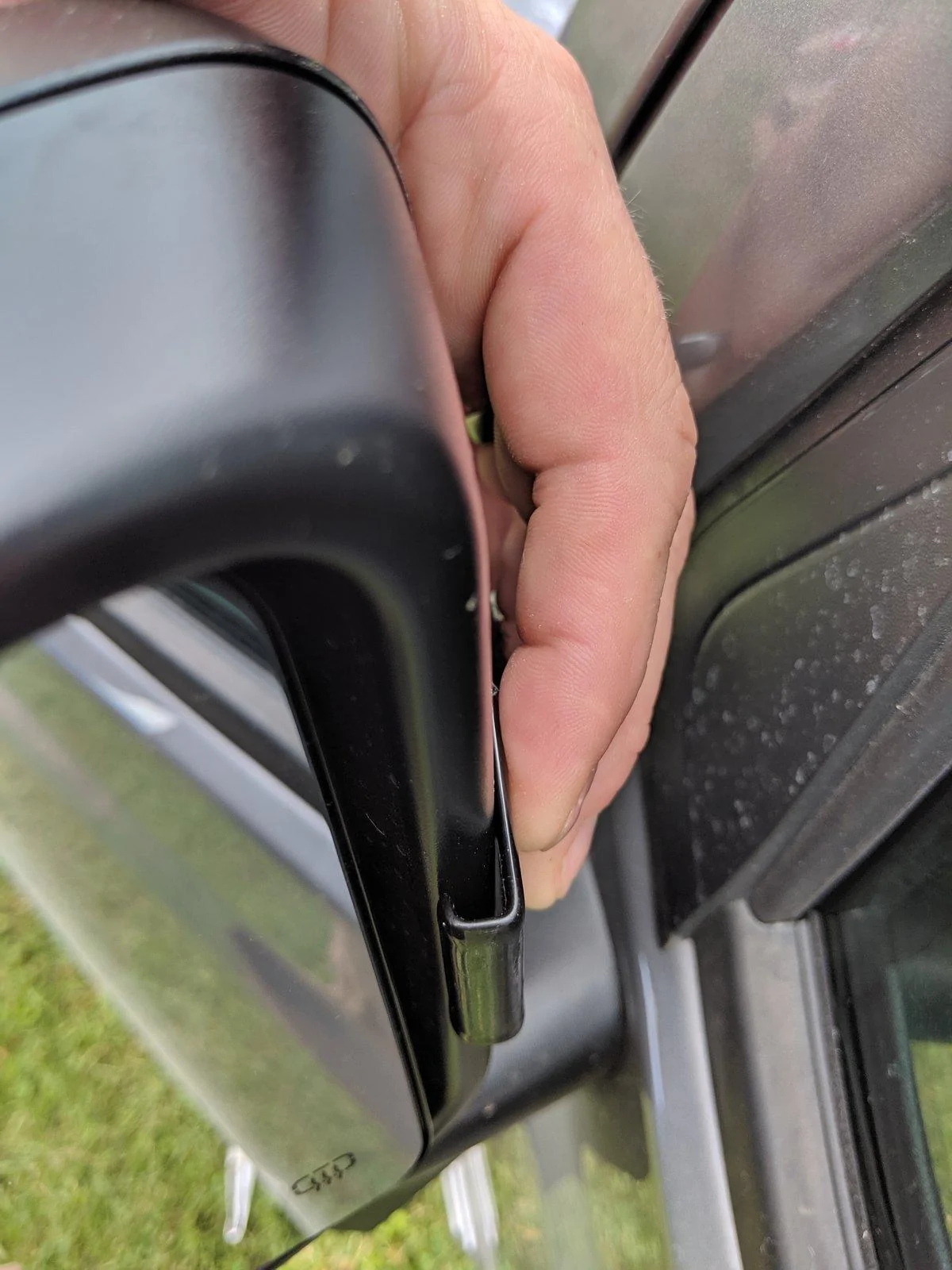

Some disappointing news today. Received the mirrors I ordered. I'll be returning them. I knew there maybe a risk here but I can confirm they don't fit nor do I think it's possible to make them fit. :crying:
The clips are much to small and lip on the gladiator mirror positions the tow mirror so it would be unusable even if the clips would accommodate the JT mirrors.

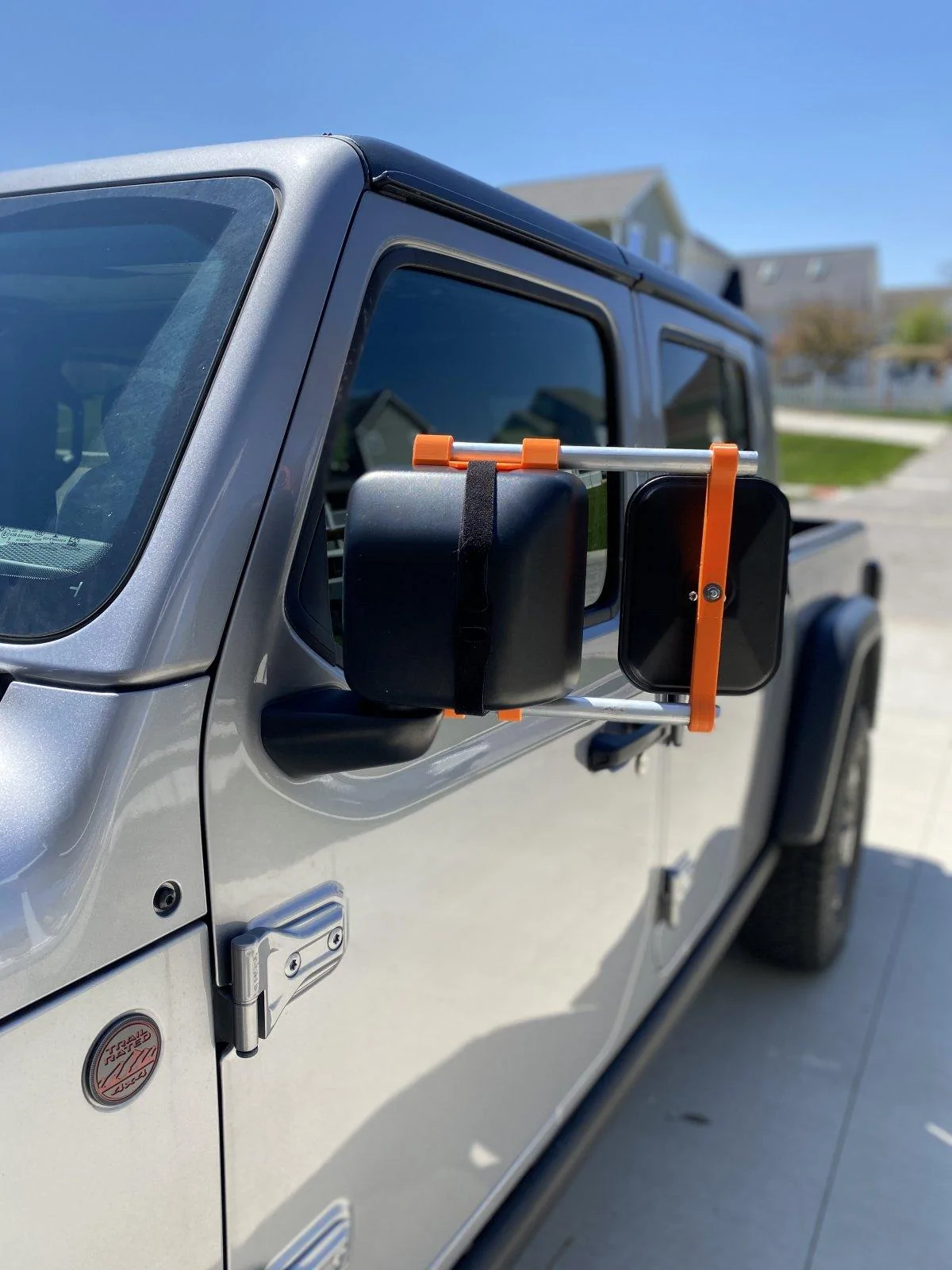

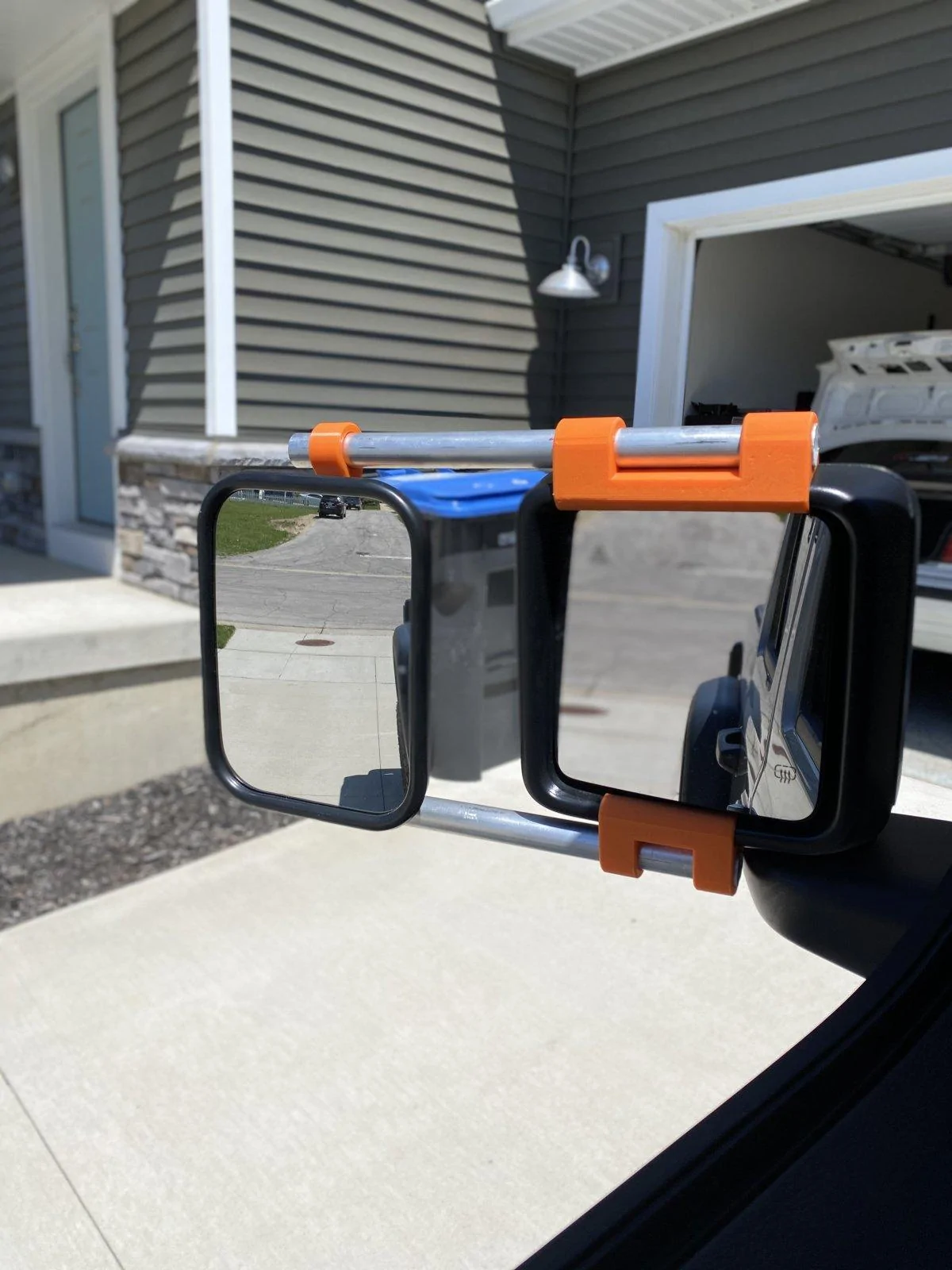

A bit hesitant to post because it’s still a pretty rough prototype, but I’ve been working on this. Open to input, the orange is just to see it better. I’m aiming for more “Jeep” and less one size fits all.

I
I like the idea. A little less bulky and easily removable/stow-able would be great!

I
The strap is just for proof of concept. I want something better. As of now its pretty quick and easy to take on and off. just loosen the strap.
What areas seem bulky to you?
I understood the prototype nature of the product and applaud your efforts. Comments were meant as a positive critique. I just thought the support rods could be made of a smaller diameter solid aluminum rod. The strap doesn’t bother me, it should be tethered to the main mirror somehow anyway.
No worries, I took them in a positive way. Thanks for the feedback! I picked 3/4 inch for the tube early on mostly for strength, protecting for stronger loads from the mirror being flat. Seems that its a bit overkill now after doing some driving with it. I'll look at smaller tubes, the parts are easy to change size.
Thanks again for the fresh set of eyes!!
When you’re happy with the design will you sell one set to me?

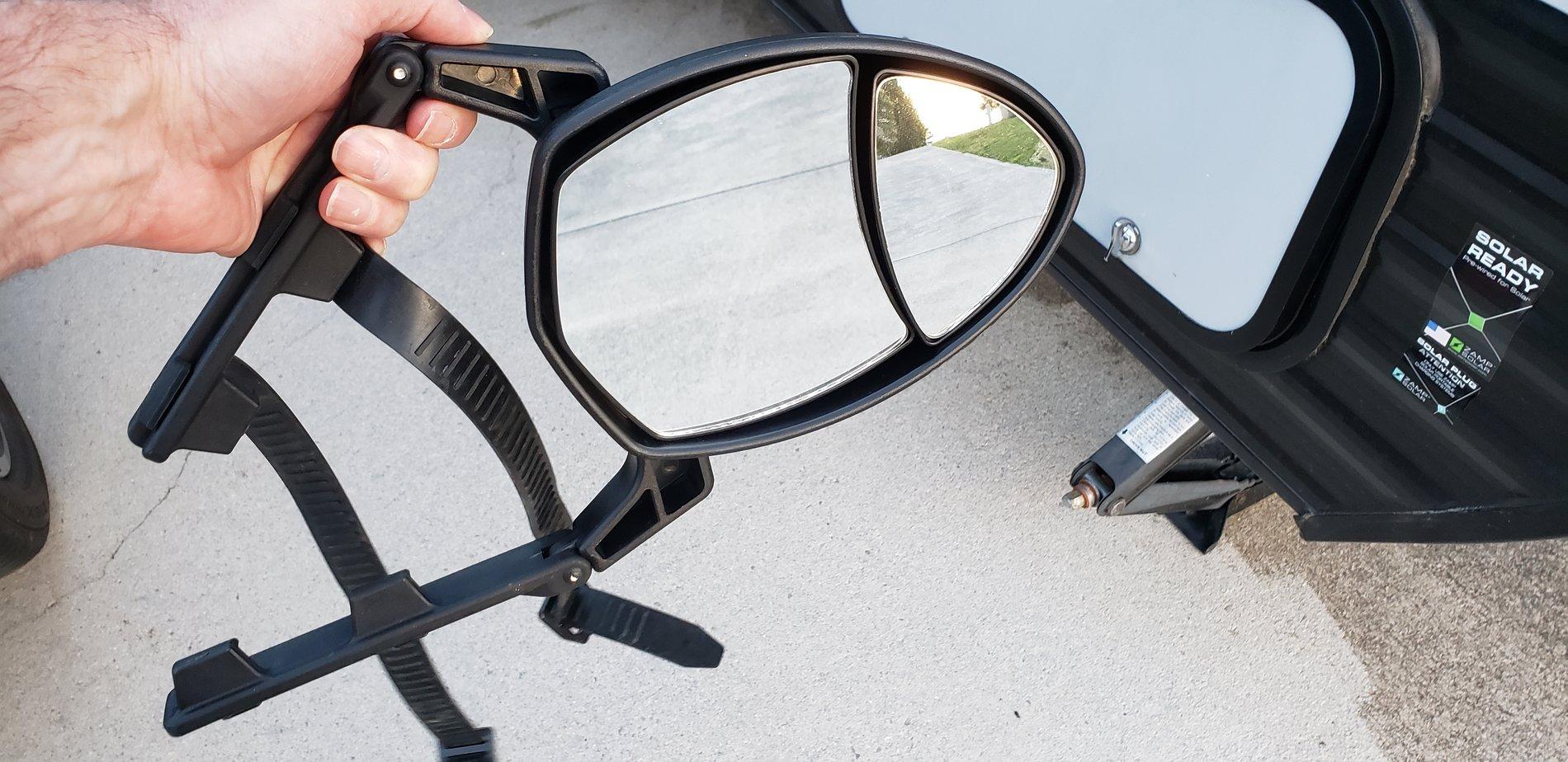

I picked a couple of these up at Farm King last summer. They work fine.
