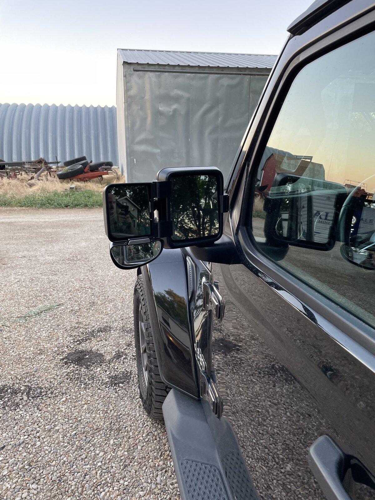

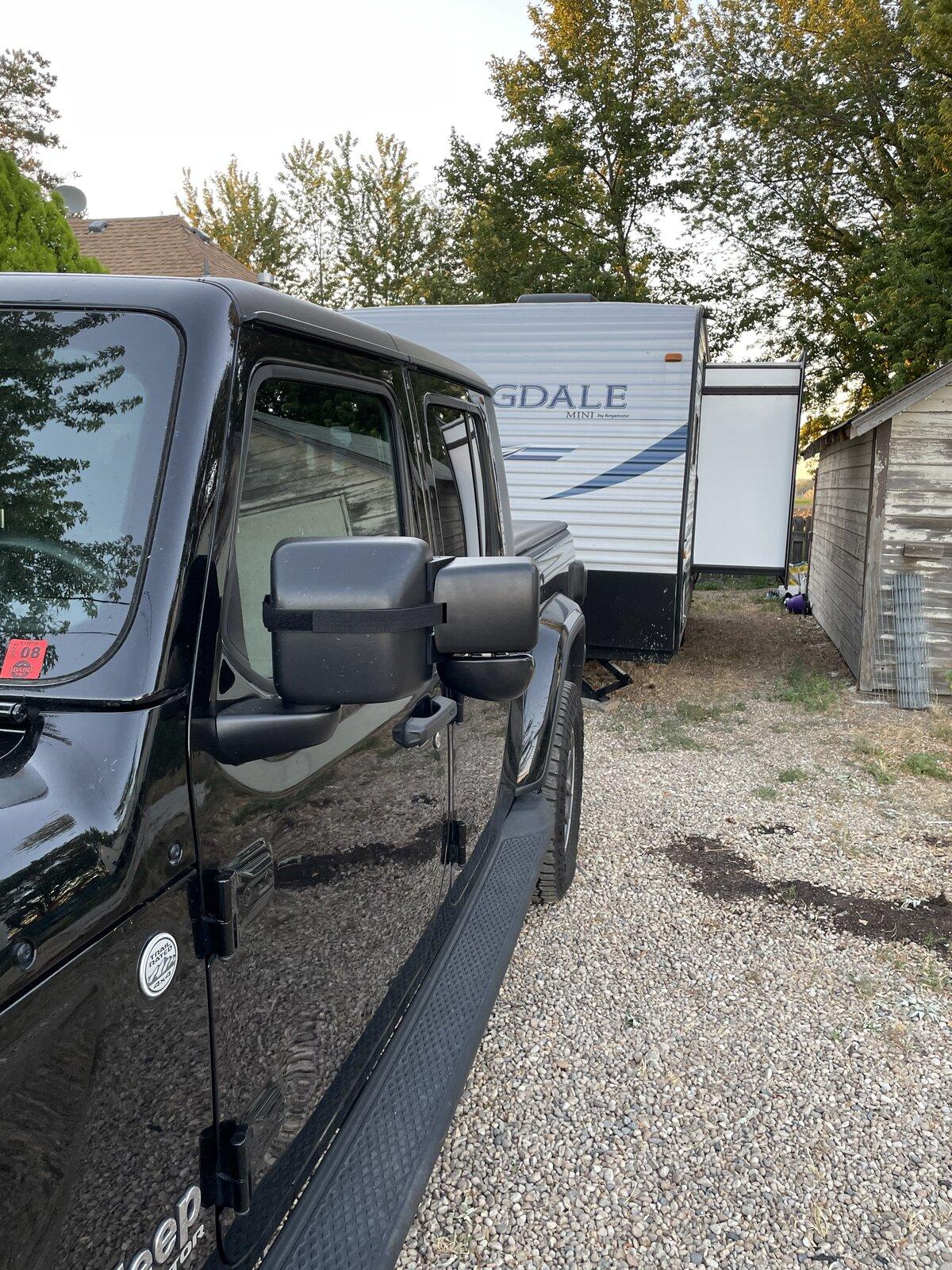

This thread was helpful! I ended up with the rampage+ thorn engineering addon+ YASOKO Adjustable 360 Degree Rotation Wide Angle Side Rear Mirrors Blind Spot Snap Way Rearview Mirror. About to tow my 21 ft 8 ft wide trailer to Yellowstone in a week. Will report back if the blind spot mirror will make the journey.
Jeep Gladiator Tow Mirrors 61C580AB-F5FF-4E64-9C36-BCBD7901C308
Jeep Gladiator Tow Mirrors 1B249954-B062-46C9-B9EB-033F68CB38AF

Those look like a nice addition. I will be interested in what you think of them. Also let us know the width that your trail is, since we will all have the same mirror span it may effect those with wider or narrower trailers. Thanks
@PapaPierogi73
PapaPierogi73
Jun 16, 2021
Boise
2020 jeep gladiator overland
Military
@PapaPierogi73
I did in the post but I will say again 8ft wide lol
can you put these on the side of the mirrors vs the underside? That extra little outward viewing might make a big difference

Thanks @PapaPierogi73 I read it Sunday and came back just to remind you about updating us. As you can see more than just me want your feedback.
