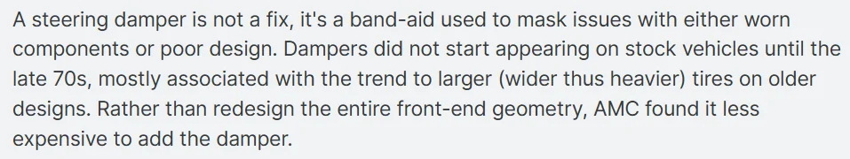

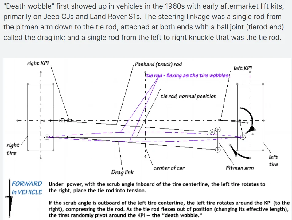

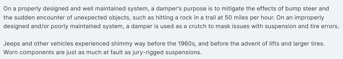

Sorry, contrary to what some non-engineers claim, a worn steering damper/stabilizer can't possibly initiate DW. It's just impossible for an item that sits there with no ability to push or pull on its own can initiate it. You can drive around without one if things are done right.
Explain the exact way that a steering damper can CAUSE DW.
some state that if you have a Jeep that doesn't have DW at all, that a worn damper can cause DW if you install a worn one. I'd love to see the technical explanation of that.
To say it can "cause" DW is to say that if you don't have DW even without one, putting on a worn one could cause DW - that's just not possible. the most that can happen is a worn one will not mask DW - and I suspect that's where the internet lore is coming from - hey, mine is worn and I have DW so it must be causing it.
It's not at all an "integral part of the system". It was put in as a bandaid, and to deal with bump steer.
There's a lot of Jeep people who don't even have one installed.

I've posted long tech stuff with detailed explanations at least a half dozen times from the very engineers who worked at Jeep, and the owner of a very well known 4x4 performance shop.
It's not integral in any way. It mitigates issues, that's it. it wasn't even included until the 1970s so can't be called integral.
From Norm Layton (look up his name) -

And this from a suspension/steering engineer who works for Chrysler and even truck companies -
