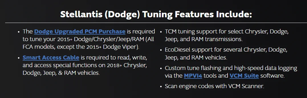

So, back to my question, is there a tuner to help in that regard? Thanks, Greg
plenty of tuning company, but only selling the same tune to everyone. This speaks for their understanding or what they’re doing. The answer(in my knowledge) is no, even though there isn’t a reason for it. This means you could also try to hit someone up and see if they would do a one off job for you if they’re even capable of doing so reliably. In the diesel world at least most copy each other, modify it a bit call it their own and start selling those like cookies at high prices.

I see on the HP Tuners site that they offer transmission tunes.
