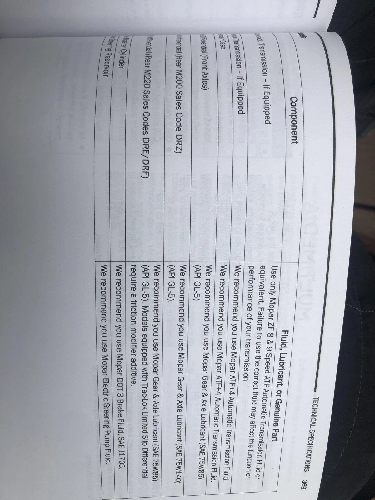

Manual recommends sae 75w85 gl-5 with a friction modifier if you have the Trac-Lok limited slip.
40,442
53,858
Someone posted a response from Jeep that said 75w140. I tried to compare the sales codes and decided that it applied to my Overland with trac-lok
It was in a thread about which lube to use - Jeep responded basically with 75w140 The sales codes mentioned matched my truck.

From the manual
Jeep Gladiator Trac-Lok friction additive E2226082-78AF-4C7F-814E-3A55DF1561D2

Idk... the shop I used for my re-gear is a reputable place and they use 85w-140 unless they screwed up when they were telling me. They never mentioned anything about friction modifier either. It's going it today. I already dropped it off. I guess if I here anything I'll take it back and get some put in. It's been a rough day. My tazer live function stopped working after I stopped at store on my way to work and my shifting felt horrible so I'm assuming the unit was not syncing properly with the JT. I pulled over and had some codes with a check engine but accidentally cleared them. I did a full reboot and got back to normal just in time to drop it off at the shop right next door to my job. I havnt even stepped into work andy blood pressure is probably sky high.

My understanding is the M220 is the only axle you can get on the JT with the Trac Lok.
