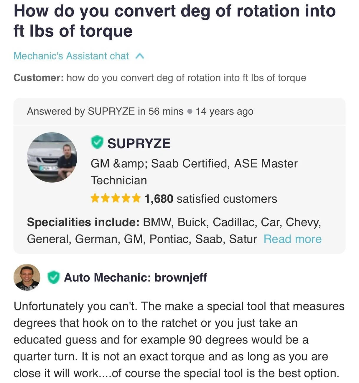

It's so easy to use torque + degrees, I don't understand the wanting of a conversion.
Torque it to the spec, mark the bolt and turn another xx degrees.
Where's the trouble?
360 degrees in one complete turn, a hex head bolt has 6 sides and 6 points.
So if you turn it so you move the bolt head so it moves exactly 1 point, you have moved it 60 degrees.
If a spec is xx plus 155 degrees, you turn the bolt 2.5 points.
If a point is straight up at 12:00, then you mark that point, turn the bolt so you move 2 points past 12:00 so the next flat is straight up past the 2 points.

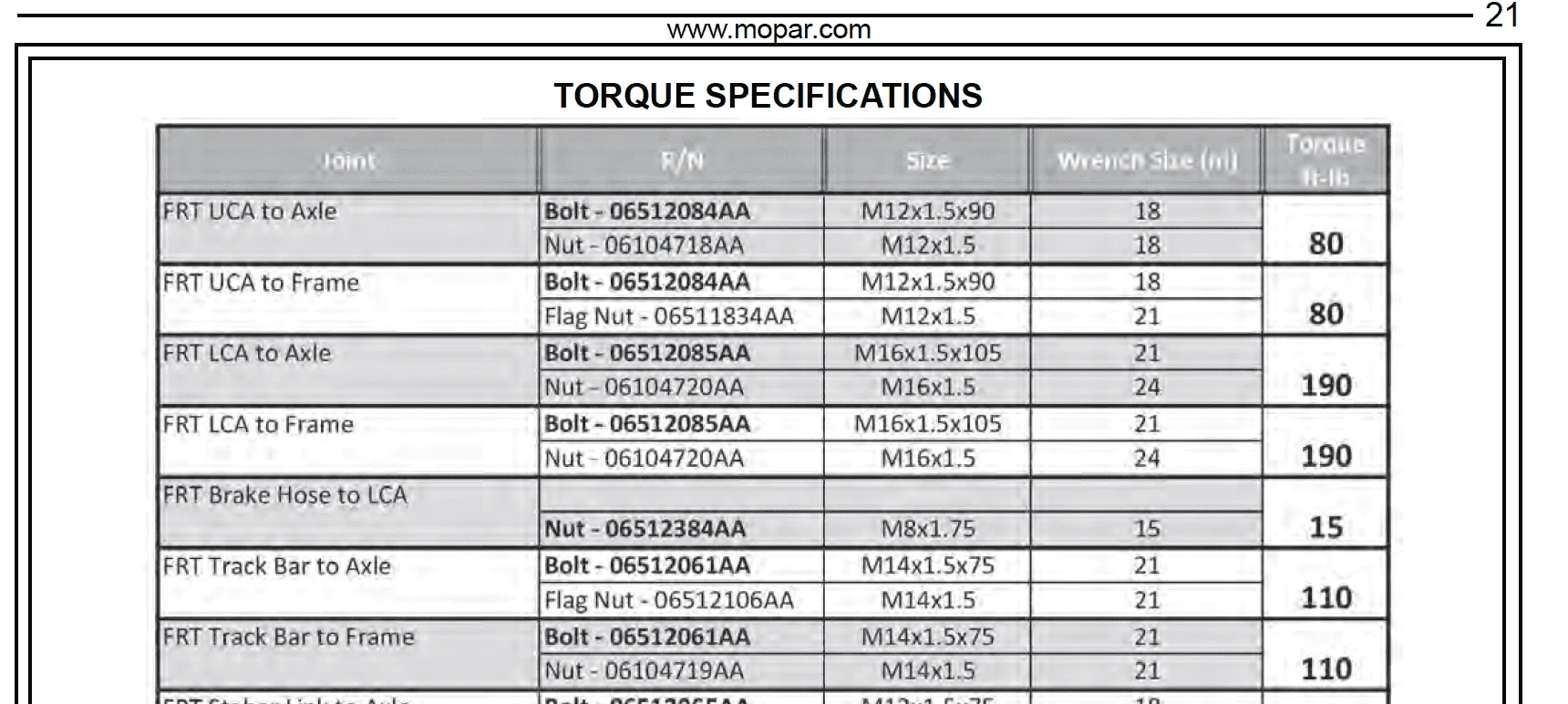

Looks like the original problem is solved, so this is more FYI: black oxide bolts have no business holding torque anywhere that's exposed to weather. Typically they're soft (so if you stick to Grade 8 SAE or 10.9+ metric, you won't find one anyway) but as soon as they get wet they start to rust, and by the time you go to remove it, odds are the threads will be welded in place and the head will turn to dust.
And if we're bring technical, that factory spec 110 ft-lbs will be assuming a dry zinc-plated 10.9 metric fine-thread bolt. Switch to coarse bolts and TECHNICALLY you'd need to adjust torque upward to get the same bolt tension. (Same as you'd adjust downward if you added anti-seize or loctite, or switched to some other coating with a lower coefficient of friction). But back in the real world... 110 is likely to work just fine on Grade 8 coarse for the track bar. Do be kind to yourself and check it again after driving for a week though.
They are black, but beings that I do plating and oxide coatings, I suspect they aren't the black oxide you are referring to.
I go back to @Zachanadandy idea, any major mods, tires larger than 35", off-roading with any real pressure on things and so on - you improve the parts, why not the bolts?
The bolts are just as important as the trackbar, tie rod and so on, and if you increase the stresses much over stock, well.........

It would be nice if instead of Lb-Ft they would express it in amount of bolt stretch.
But then people would have to buy another expensive tool that only has one function.
Let the debate begin 🤪
