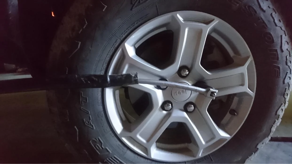

there IS an issue with things being too tight. As an example, an acquaintance tried changing wheels/tires for a set I sold him. His JL's lug nuts wouldn't come off. He had a long breaker bar and a cheater bar. Nuts were not coming off. they had recently been changed at the dealership. He ended up having to go buy an impact driver to get them off. If this had been a flat tire on the road or trail, he would have had to call a tow truck.

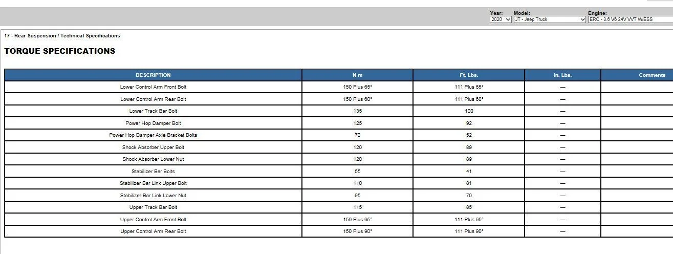

Anyone note the specs on the track bar? Yeah, there's a torque spec in the one chart, but the other shows a spec then a number of degrees. This is calculated based on THREAD PITCH to get the correct bolt STRETCH. Torque alone isn't good enough on that joint, so they figure bolt stretch. If you used a micrometer on the bolt, then tightened it, you'd see it grew longer by a measureable amount. The number of degrees (what was it, 115 or something like that) is based on how far that bolt will stretch when the thread pitch and turns or fractions of a turn are figured in. It's like the old Chevy small block engines and lifter preload - loosen until it ticks, then tighten until the tick JUST disappears. That's zero preload - why half a turn? Because when you turn that nut 180 degrees, or half a turn, the nut pushes the rocker arm down an exact amount and pushes the push rod down into the lifter the right amount based on rocker arm ratio.
It's science.
Jeep must view that track bar bolt setting as mission critical since they use a spec in degrees- meaning bolt stretch regardless of how hard it turns or tight it is!
When an engineer wants that bolt stretched a certain amount - it's more than "how tight is it" - it's knowing what that bolt can take - and not take, and getting it just right.

I did a search - found the lug nut torque spec thanks to whoever shared that months ago, but 15 minutes of searching have come up empty for the correct torque specs for track bar (especially axle end), sway bar links, and shocks.
After the spring and shock swap, I want to go back to factory spec. I have things to what is typical and usual for the trucks and cars I've worked on - and the bolt sizes, but I want to be sure on a truck not even 1 year old yet.
So - anyone willing to share correct proper torque specs for steering and suspension parts???????

Thanks for that - I also like to have these degree specs as I know that's for the bolt stretch and better than a torque spec in the end. It's an engineering spec as much as anything.
I appreciate all of those who have posted the specs sought. I plan on doing what I've done with every car or truck I've owned - starting a tech notebook with specs, any changes I've made/mods and so on. I have a quick reference notebook on my cars - this JT is next.

I have found some conflicting torque values in the maintenance manual...but they are usually close .
40,465
53,918
I was wondering why the values were different for the control arms and stabalizer bolts but then I saw yours is for the rear suspension and mine is for the front.
Yup - this is the complimenting rear set.
I have also seen the differences Phred refers to, but they are usually very close.
And I wonder - although nothing is said directly in the charts posted, at times one set of values is the original new fastener torque where the other is the maintenance torque.
I've seen a torque value applied to new fasteners, fresh assemblies, while there's another one a bit less for used fasteners and maintenance.
Many of my tech books have differences noted. With Jeep had TSMs available but they'd take up a whole book shelf for one model and year.
