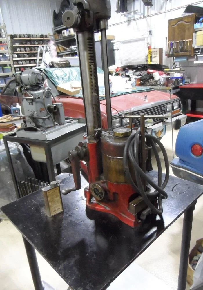

The honing isn't "special" and isn't what keeps the rings sealed. It's the operation done after boring an engine. It results in a cross-hatch that helps hold oil against the cylinder wall and aids in wearing the rough spots off new rings.
You use different stones, different grits, for some ring materials so it's not all the same. If you take a block to a shop to be bored and/or honed, it's best to tell them the rings you will be using so they can put on the final honing finish for those rings to help them "seat".
The cross-hatch can be gone and all will be fine. It's when things get worn beyond that that there's a problem, or if you get glazed cylinder walls as they are very smooth and don't hold oil.
Yes, ideally there's not enough long-term wear to take the pattern off, but it being gone doesn't mean no more ring seal and doesn't usually result in oil use because of that. Cause and effect.
I've torn down engines to do valve work and seen the hone pattern gone but the engine wasn't "using oil" beyond normal.
The reason an engine may use oil when that cross-hatch patter is gone isn't because it's gone, it's because of cylinder wear. So it's not the lack of the pattern that caused the oil consumption, it's the wear that took the pattern away that results in oil consumption.
Some fuel getting down there is normal, the H20 is not surprising - what saves an engine is the fact that normally you get it up to normal operating temperature for at least 15-20 minutes and then those fuel fumes are burned off and the water is evaporated. It gets there via condensation.
Some fuel passage is very normal - that's why people who burn E85 or even pure ethanol should go no longer than 5,000 miles between oil changes!
The PCV system is made to vent off that stuff and to pull a vacuum in the crankcase.
I have a feeling they smelled gas but saw water. Even these engines have controls to prevent real flooding like older carbureted engines lacked (or that even early injected engines didn't do well)
(I have a boring bar, Sunnen hone set, etc. and have done these very operations. Speaking from experience.)

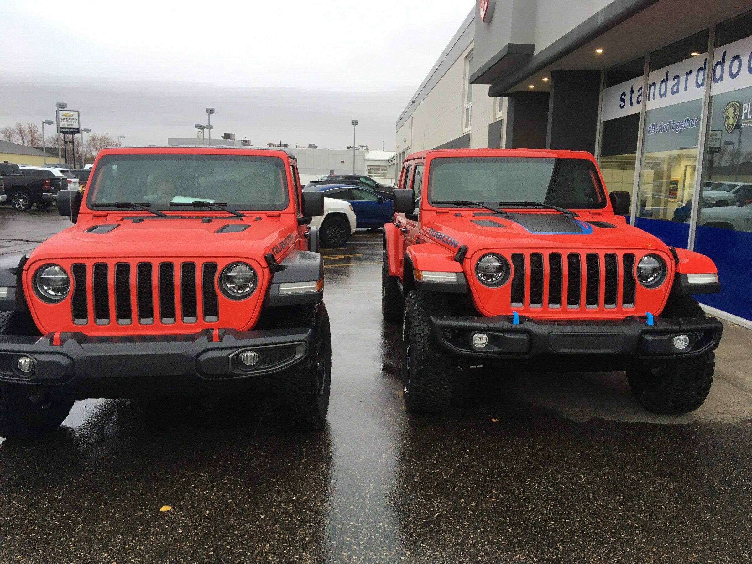

So to be exact after 41 days of ownership there was 6 quarts of liquid in my oil pan. The Jeep only takes 5 quarts to fill!!!
Due to the frequent starts and stops of the gas/electric combination that’s how much leaked passed the rings.
