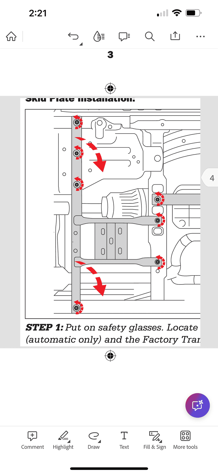

I’m not at home right now but I have this from the install manual
it’s the top left one next to the fuel tank.

I went and looked at mine yesterday after your initial post and deduced it was that one. None of the holes near it are very useful for access.

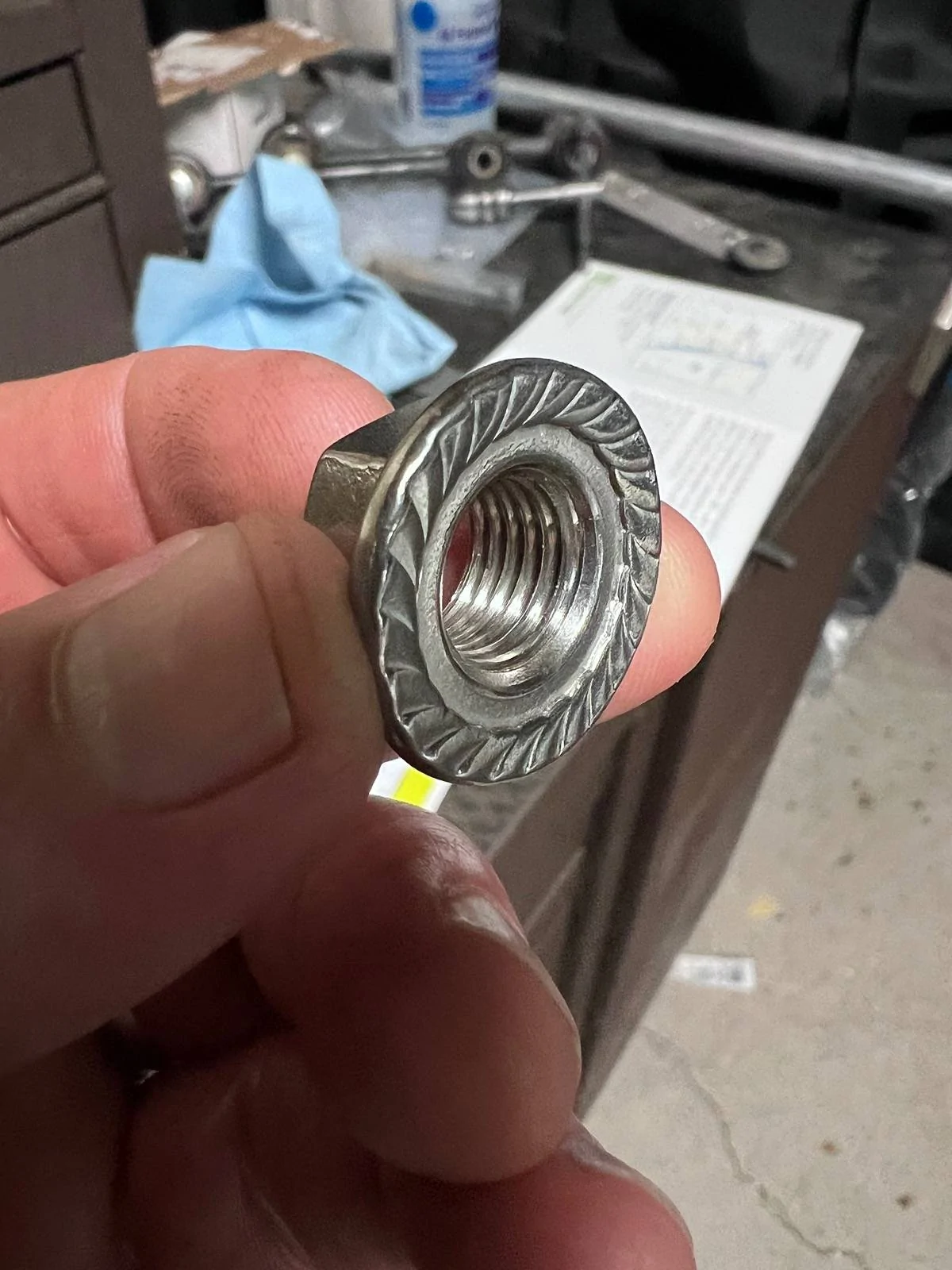

I ended up cutting the head off, pushing the old nut through, and replacing the nut with a serrated flange locknut.
Jeep Gladiator Transfer Case Skid bolt spinning IMG_1773
I wasn’t expecting it to grab so good but it seated right in and torqued to spec.

So you were able to get this into the frame and if seated and held the cross member in?!?!
For the location on mine there is a hole in the frame above and a little bit aft of where I needed it that is big enough for it to fit in. A telescoping magnet can come in handy if you lose track of it. I used a little glue to hold it in
Place while I threaded it but once the ribs took hold it stayed in place enough to get it to torque spec.
